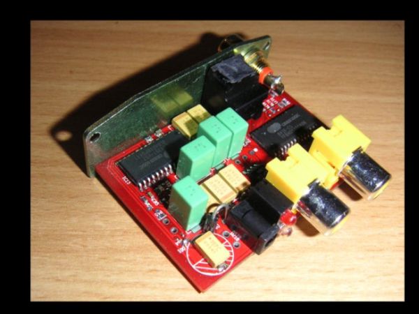

I found a very cheap (59US$) chinese DAC, based on CS8416 and CS4397, called "DAC in a Box". The datasheet for the CS4397 does not look very different as the CS4398 datasheet.

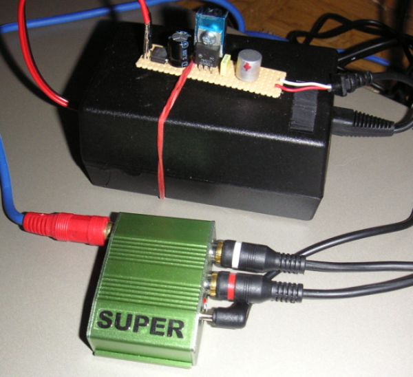

It's a matchbox sized DAC, just the DAC board. 12VDC, SPDIF optical and RCA in, RCA out.
I immediately ordered on of this boxes, including a small wall-psu. The first tests I made battery operated. I realized, that the DAC is consuming relatively high currents and as soon as the battery voltage is lower than 11V, some clipping occurs (maybe the LT1364 opamp, as the receiver and dac chips are supplied by a low drop AMS1117 regulator with 5VDC).
So, I built a small LM7812 regulated psu and the beast beats my (after ETF06 newly modified) Marantz CD63.
There is no remarkable difference between the California Audio Labs Sigma DAC and this small box!
Of course, I bought this box, to play with my own analoge stage, bypassing the internal opamp.

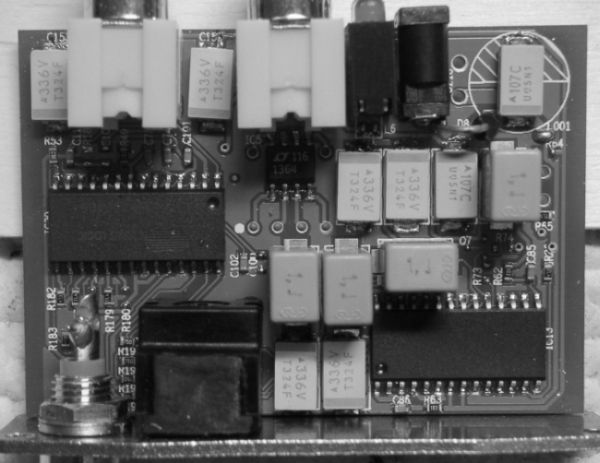

I'm really interested in this little DAC, thanks for posting your thoughts!

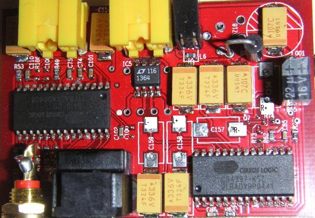

Looking at the photo, it seems the opamp is a SOIC package mounted on the PCB. It also looks like there are DIP mounting holes, is this correct?
I've seen another picture showing a SOIC opamp mounted on a kind of DIP converter (I think).
The reason I'm asking is because if I buy one of these, I'd like to replace the opamp with a DIP LM4562.
Best regards,
Andrew.
Hi Andrew
Indeed, there are DIP-mouting holes! I did not remark it before!
But not a lot space left for desoldering. Maybe one output RCA has to be removed.
Kind regards
Franz

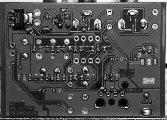

Here the backside of the pcb.
Before replacing the opamp: I think, the opamp is driven by single supply, 5VDC. Therefore coupling caps are sitting in the signal path.
I think, it is better, to bypass this opamp circuit by a complete new, positive and negative rail driven solution.
Or a broskie cathode follower.
Franz

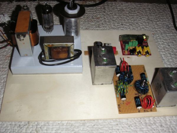

Actually, I am layouting the breadbord for my testbed (look foto): in the upper left corner the high voltage PSU, tube rectifying (EZ80, resulting in a nice slowstart). CLCRC.
Lower right corner the broskie cathode follower, based on 6111 triodes. The big cans nearby are paper (MP) caps, 4uF.
BTW: I am not in any relation with Mr. Wu, just a customer
Kind regards
Franz
I must correct the above sentence:
The opamp is feeded by a single positive voltage, 11,25 VDC. It comes directly from the power supply over a 1N4407 protection diode, bypassed by a small SMD cap (marked as 336V: is this 33uF 6V?).
That must be the reason, why this DAC begins clipping when the supply voltage is dropping below 11VDC.
Franz
Doing some more reverse engineering it is obvious:
I just have to remove the four greenish through hole caps and I will get 4 solder pads for the balanced voltage output from the CS4397 DAC freely accessible and hanging in the air.
So, it will be easy and low risk for the print, to bypass the opamp and add my own audio stage.
Franz
Modifications step 1:
Separate regulated voltages for digital (8VDC) and audiopart (12VDC).
Goals:
1. Better resistance to mobile phones, flashlights and so on.
2. Less heat on the AMS1117 regulator, the whole board and caps.
3. Improve the sound...
What I did:
1. Broken powerline nearby AMS1117
2. Removed 1N4007 diode and replaced by a ferrite bead.
3. Attached 12VDC (regulated) at the original points.
4. Added a 22uF tantalum for the 8VDC in.
5. Attached 8VDC (regulated) at the new cap.
At least goal 2 is reached, goal 1 not really (maybe I will use a choke instead of a ferrite bead), goal 3 hopefully 😀
Kind regards
Franz

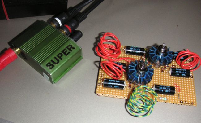

Modifications, step 2:
I removed the four greenish caps and attached my first version from the Broskie cathode follower:
It works.
But I will rebuild the cathode follower with "real" tubes (E188CC instead of 6111). The problem: One channel was not working, some short between anode and grid. Maybe the tube, maybe the strip board, I used (to small distance between the traces for about 200VDC).
Here, you can see the attachment points for the balanced out from the DAC, after removing the four caps.
Franz
