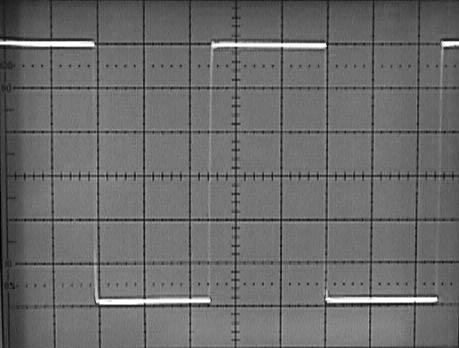

BTW, this question has been asked before and will inevitably
be asked here - "Why the .33 ohm resistors, inductor, and
10 uF cap?"
The .33 ohm resistors are inductive wirewounds, and the
inductor in the schematic represents that. When I laid the
board out, I anticipated a large capacitor in the decoupling,
but it didn't work out best that way, and I ended up trimming
the values against the following square wave at 10 KHz:

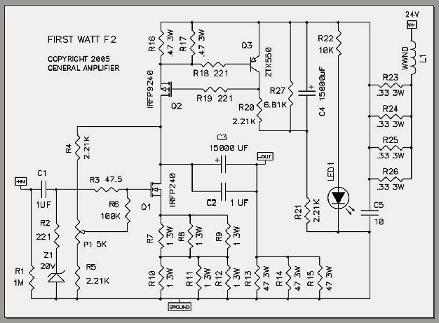

Nelson Pass said:
Here we go
Thanks Nelson Pass
Many girls and boys will be very happy
... like getting an early X-mas gift
I attach the image of your schematic
for those who want to take a quick look,
without download of original PDF

this image, as all 'pass-materials', is now put with all the rest of my collection in folder C:/My Documents/Nelson Pass
I have separate folders, for like 60-70 other audio persons and diyaudio members, too.
Including one folder for 'lineup circuits and stuff', I have manage to find in this forum + world wide web
So, are you saying that a current source with P-channel devices is more immune to those thumps than an N-channel version? Or that a 15.000µF cap can not be used in a N-channel version? No, can’t be… although …is there a relation?
/Hugo
