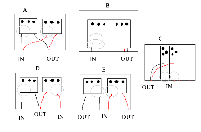

The input section is according to the article and threads very sensitive to noise. If the two boards are in the same case, the input of one of the channels will be very close to the output and voltage regulater of the other - is that a problem? Would it be a good idea mirror the channels so the two input sections can be together or far apart?
I'm making it for someone I know and I think he will prefer, if he doesn't have to split two many cables, so Right and Left should be placed close to each other for input and output if possible.
I have made some suggestions and attached primitive sketches. What do you guys think, should I try something new or try to get as close as possible to Waynes layout?

I forgot to explain my sketch. The gray circles indicate the input section, where noise should be minimal and the black circles are the capacitors for psu and where regulation will be placed. Right and left are indicated by red and black wires.
Hi cviller. Alternative C on your drawing looks like a good bet.
With the boards placed in one side of the case you can run the supply leads in the opposite side, maximizing the distance between signals and supply leads. That said, my Pearl is in the same case as the trafo at the moment and its pretty silent.

Hi Steen,
Thank you for your comments. It is also the configuration I prefer. 😎

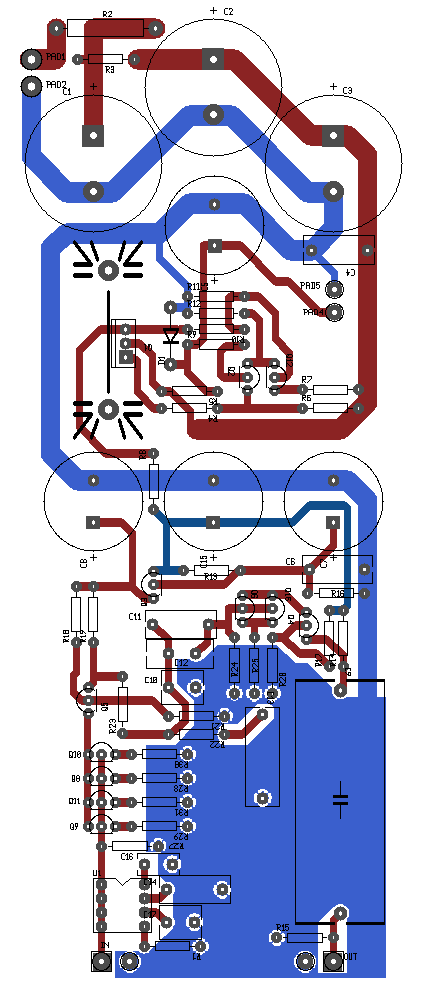

First layout draft
Hi
I don't know if this is a good idea, but I'm posting a very early draft of my layout.
I still need to clean up, make it a bit shorter and make some of the traces wider. I have decided to fill as much as possible with ground.
Comments are most welcome, but please remember that this is just a draft I made last night.

Cool idea to replace the SK389 with SK170's. Those SK389 are pretty hard to find. Nice work on that board🙂

steenoe said:Cool idea to replace the SK389 with SK170's. Those SK389 are pretty hard to find.
That is exactly why I did it, but I'm not completely sure how much I need to match them.
I have cleaned up the board so it should fit on a 180x80 mm board.
Any comments to my layout?

Okay, to get back on track😉 Cviller, the better you match, the better you fare! I think that the sk170's wasnt matched by Pass labs for the original Pearl Q-pack. But it would be an advantage to do so. For the last stage, (normally a sk389, that you replaced by 2 sk170's) I think it would be best to match those two.

Wow😀 Looks great to me allright. Any chance to see a pdf of the copperside in B/W??🙂 I did a complete run through your board not so long ago😀 Everything seems just right!!Any comments to my layout?

steenoe said:Wow😀 Looks great to me allright. Any chance to see a pdf of the copperside in B/W??🙂 I did a complete run through your board not so long ago😀 Everything seems just right!!
Thank you for looking through my board - I won't post the copperside online right now, but you I can send it to you. I have to make sure that I'm not anyones toes... I know there are still some fabricated boards available.
