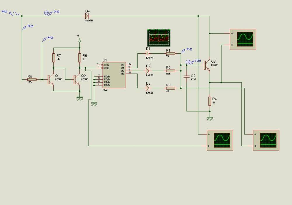

Hi, my first attemps are very impressive !
Topology allready works (tested with low voltage ECC86), not used yet the tester but two DC supplies (logic for stairstep + filaments) and an AF generator (AC sweep).
The curve is clear and very instructive (you can see them moving as filament voltage change for example).
Here's my test sample schematic:
(thanks to Kazuhiro Sunamura (---> http://www.intio.or.jp/jf10zl/) for the idea !)
PS: the spice schematic shows a transistor being tested at the right, I've breadboard it and tested it with both transistors and tubes (ECC86 & ECC83) AF gen feeding a step up transformer for VA >50V, stairstep fed to the grid via a tel line transformer (can provide different bias offsets for the stairs.)

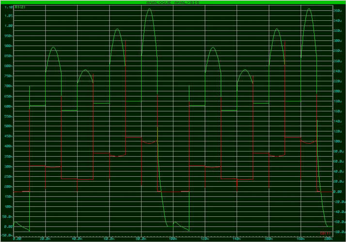

Here are the stairsteps outputs V *green* & I *red* (loaded by a transistor base). It's close to the breadboarded circuit.
- Now we have to smooth the spikes ! (Although the X/Y traced curve is nice)
I add the cap to smooth the voltage stairs, but signal could be better I think ? Will a buffered output help ?
- The two first transistors (which make a 50% duty cycle clock for the 7490 Decade counter) may surely be replace by something else able to withstand a high voltage input (let's say 500V peak) OPamp circuity? optocoupler ???
- Amplifiy the stair output providing adjustable step amplitude, polarity, and maybe, offset too ( is an OPamp OK for this ? is it more elegant than the transformer approach ?)
- How can we modify the system to be, on demand, a voltage source or a current source ?
- It's amazing to see that you can kinda "focus" the trace by tuning a sweet frequency (AC & clock) usually around 500Hz far better then 50Hz or 25Hz (europe speaking), in fact it synchronise the returns I think ?
Your help will be greatly appreciated (OPamps are new to me !)
PS: It's too bad I've forgot my photo memory card, and can't post you scope screenshots for now (but soon I think).

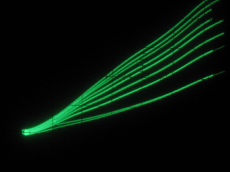

Here are the traces of an ECC86 (space charge tube)
X=Vpeak=18V
Y=I=1mA/div
F=150Hz so 300 full wave rect. (allways that story of sweet spot for frequency giving the kinda right "focus")
