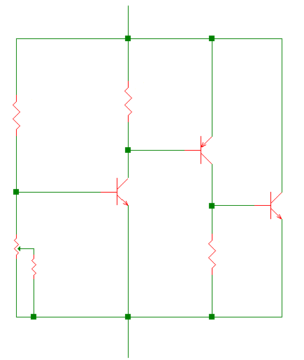

Conceptualised in the thread "Power Amp Under Development" here is the transistor output stage variant.
http://www.diyaudio.com/forums/showthread.php?postid=946429#post946429
A version has already been built by fellow diy'er Kraft and this thread is dedicated to the development of this version.

It is intended as a powerful high quality domestic power amp. The reason for this thread is because there have been requests (forum and email) for a varient of the mos design that used conventional power transistors, particularly TO3 types.
So here it is. Anyone who wants to build it and take advantage of TO3 devices they have laying around may do so. Or they can choose not to.

mikeks said:
mikeks said:
Is your main concern about the trimpot wiper going o/c?
quasi said:Is your main concern about the trimpot wiper going o/c?
Yes.
Try shunt regulator below.
Its output impedance is lower than that of most monolithic voltage references.
Consequently, variation in output voltage due to anomalous variation in standing current is virtually nil.
Additionally, your output stage won't fry in the event of the wiper failing open.
