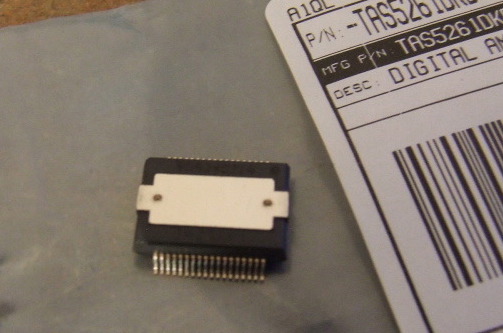

I've ordered some samples, if I can solder these, I'll report back here on the result. Should be interesting.
SmellOfPoo said:@ericallan: I´ve ordered some samples too. Obviously PWM input is needed; did you figure out how to do that?

That PC board layout in the docs ...
... is probably not correct. It looks like the docs refer to a 36 pin surface mount chip and that board looks like it is designed for a 16 / 18 pin chip w/ heat sink mount ... ??
" " ... 'm wondering if this might do the trick: http://shop.dataip.co.uk/products.html?prodid=81 ... board pic ..."
I won't know for sure until the chips get here ...
Later
Later
