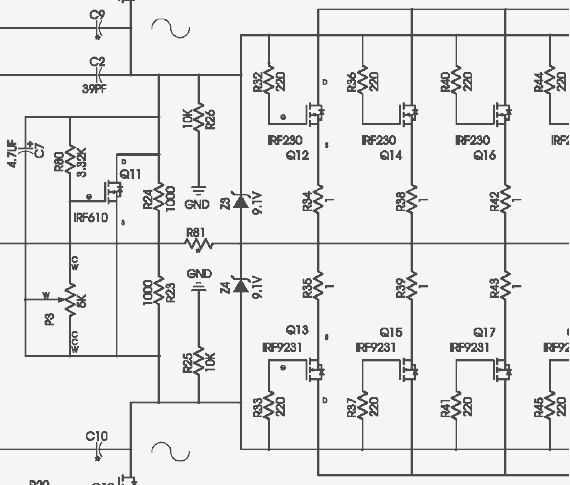

I build this classical MOSFET amp because I have some scrap:
This is the PCB
Little photo
Iknow is not the best design, is not the best sounding amp etc.. I build it for fun... so don't kick me😀
I have some trouble with it, the Vbe multiplier is oversensitive, if I set the bias (100mA per MOSFET) this slowly decrease as themperature increase and if I rebias at 100mA when the amp restart at cool the bias is over 100mA and I risk some thermal runaway....
Now I set the bias at 70mA ad is OK for the start, no runaway but after the heatsink is hot the bias get 50mA or less...
In your experience is happened thing like this?
Is there any solution?

you could try
to let the temp sensing transistor
have a bit less direct contact with heatsink
maybe put in some millimeter of some material
between this little transistor and the heatsink
this will make the temp adjustment a bit slower
and less sensitive to variations
from looking at your schematic
another way
exchange the MJE340 in your schematic
for a transistor
that better match the temp charateristics of those MOSFETs
http://img205.imageshack.us/img205/3648/200wmosfetvl4.gif
Often used is BD139
and there are a few other you can try to experiment with
also you might try putting those drivers
MJE15030 + MJE15031 onto a separate smaller heatsink
without temperature contact with main heatsink

luixssj3 said:Thanx for your reply, I'll try to put some space from Vbe mult and heatsink...
I'll let you know...
Yes, that is a good first try.
Sometimes it can be enough just loosen the screw a little bit.
I know old amplifiers, where the temp sensing resistor
was never in actually contact with heatsink, but very close to it.
Often used was NTC thermistor = Negative Temp Coefficient
is a resistor that gets lower resistance as temp get higher.
But also most transistors, like MJ340, BD139
has got a very linear negative coefficient.
Where Vbe ( volt from Base to Emitter pin ) sinks like 2 mV / per 1 degree C increase.
The hotter a transistor gets, the lower VBE gets.

vertical FETs, is this what the amp was designed for?
Move the drivers off the main heatsink and keep them cool.
I prefer a small reduction in bias as the amp warms up and hopefully even less bias when it starts to overheat. A form of self protection.
The extra bias when cold is no problem and it helps get the devices up to temperature.
BTW. 200W into 4r from +-45Vrails is a bit optimistic. even 100W into 8r will be difficult (impossible?) to justify.

I'm surprised that none of you have mentioned using a Mosfet
as the bias transistor in a Vgs multiplier - it's a lot less tweaky.
Nelson Pass said:I'm surprised that none of you have mentioned using a Mosfet
With bipolar drivers on heatsink?
Are you sure??
darkfenriz said:With bipolar drivers on heatsink?
You need more voltage to bias up a Mosfet output stage,
and a Vbe multiplier starts with .65V or so, but a Mosfet Vgs
starts with 3.5V or so, so there's less amplification required
of the Vgs.
I have used Vbe compared to Vgs in Mosfet follower amps with
and without bipolar drivers, and the Vgs are simply easier to
adjust. Thermal tracking is not problematic, and of course you
can tweak that more with positioning or with thermistors in the
network, although it's unusual to have to do so if you have
adequate sinking and/or Source resistance.

Nelson Pass said:I'm surprised that none of you have mentioned using a Mosfet as the bias transistor in a Vgs multiplier - it's a lot less tweaky.
Used them in every class AB MOS amp I built! Also, used to mention them in these cases but since no-one seemed to pay attention... 😉
Assuming a TO220 Vbe multiplier (unfortunately, not a common way to do this!), a simple replacement of BJT to MOS is needed, along with an adjustment of the resistor value between D and G, to set the proper multiplication factor (ideally the bias setting pot should be able to vary this from 2 to 3, depending on output MOS source resistors and chosen bias).
Are you sure??
Yes, believe or not it does work properly in the majority of cases. The trick is that the Vbe change is just 'transmitted' to the MOSFET Vgs, which, due to lower gm is far less sensitive (thermal runaway is much slower in MOSFETs given the same idle dissipation and heatsink size), plus, due to high Vgs treshold, is even less sensitive since it's small in proportion to the Vgs. If there are source degeneration resistors, this is even more true - even a straight Vgs multiplier will overcompensate this.
In the rare cases where it might not be enough (single MOSFET pair with no source resistors driven by BJT drivers on the same heatisnk comes to mind), adding a thermally coupled diode in the MOSFET source does the trick.

luixssj3 said:I never use a mosfet as Vgs multiplier, but I'll try it a day of this...
If you want, you could take a look at the Vgs multiplier in passdiy: A75
Thanks Babowana!
See my attached image from the old A75 paper by Norman Thagard and Nelson Pass.
IRF610 HEXFET ( TO220 ) is used as most basic setup Vbe multiplier
to thermally compensate for temp within an array of IRF230 / IRF9231 pairs.
This way to do it, would work as well, I imagine, if used for to thermally track
and compensate for popular IRF240 and/or IRF9240 pairs and all those similiar HEXFET.
