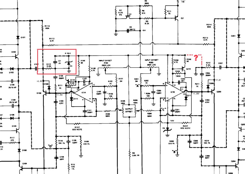

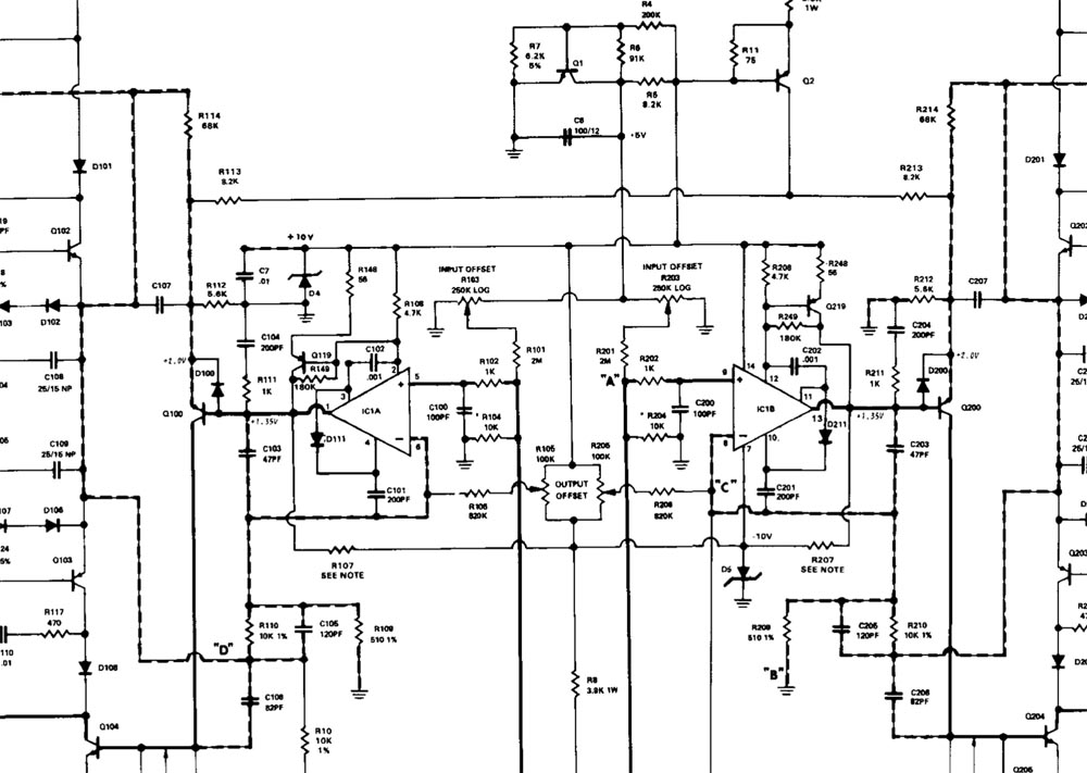

I would like to replace this dual op amp with new op amps but it has some features I am not familiar with and I having difficulty find sutitute(s). I'm not looking for pin to pin replacement.
Look at the LAG PINS, it seems to have more in's and out's than a typical op amp. I'm used to Vin+ Vin- and Vout+ Vout-

uA739 had an internal resistor to the - supply , uA749 had no connection so the resistor was mounted on the PCB. However, some manufacturers were smart (Marantz 3600 / 3800) and used a constant current source instead in this location. This made the stage far more linear and lowered the distortion.
So, to use a normal op amp, remove all the "lag" components and any pull down resistors if they exist. Compensate the op amp and go. With this amp you may or may not need an op amp that can deliver some current, or a buffer stage. I have never tried this as I've always put in the original. They can tend to go very noisy over time.

Before I give this a try I still have to deal with the non symmetrical part of the circuit. I'm a little lost with the change in symmetry from the left channel to the right channel? Picture down below.anatech said:Hi,
They look like a current boost for the output...So, to use a normal op amp, remove all the "lag" components and any pull down resistors if they exist.

As the op amp is the same for both channels, the D4 zenner stabilize the 18 volts rail , feeding the op amp...
