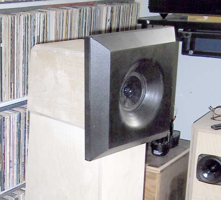

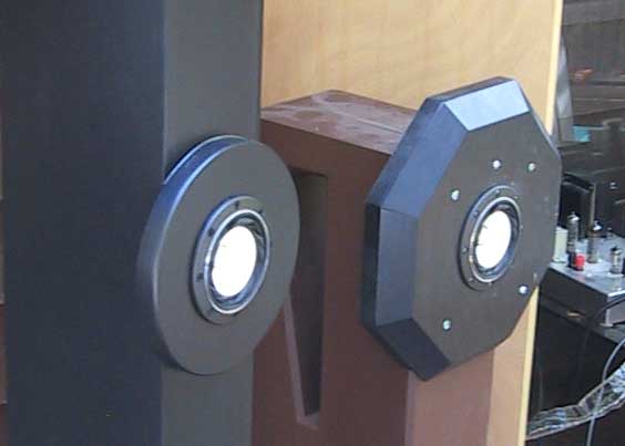

Going to the other extreme, the supraBaffle can be pushed to the sides of the cabinet (example on the left -- the one on the right served the purpose of filling a too large hole left by an FR125 but serves the purpose of nicely removing HF edge diffraction and it does look stunning)
The flush supraBaffle is tricky to make and still not quite right cosmetically... our next ones are going to be proud of the front baffle by a thickness of material and removeable as in this rendering.
Another avenue that we have/are exploring is the supraBaffle with built-in waveguide that mounts over the driver.... (as in the attachment -- our mule RonHorn A126s)
All of these ideas can be adapted for use with the BIB.
dave

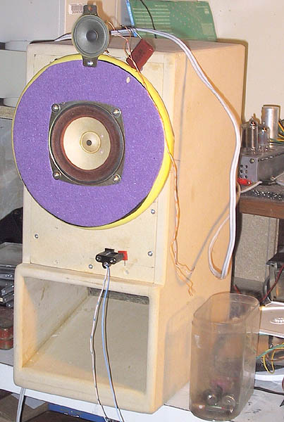

The last thing you want to consider is the flat circular disk which will have nasty diffraction and high BS ripple.... in the speaker below -- as in DaveCans FE108eS BIBs -- the primary purpose was to make the space deep enuff to accomodate the speaker magnet depth.
dave

It is essential to have some trailing edge -- this can be seen by comparing the sphere to the hemisphere on Olson pg 23... the truncated pyramid is appealing becasue it is easiest to build -- just run the supraBaffle thru the tablesaw... with some judicial use of the rasp you could take off the sharp edges and make a more rounded shape (don't plan on veneering after that thou :))
Do you think that particular detail will work also with a BIB and how to calculate the right chamfering (it reminds me a round tractrix horn...)?
It is actually a conical (45 degree champher bit) + some use of the rasp....
It isn't really big enuff to do much "horn-wise" more of a restricting dispersion at the lowest frequencies.

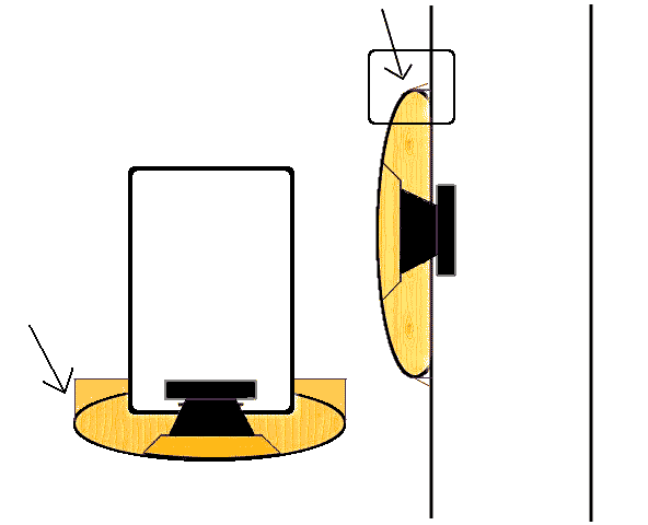

frugal-phile™
Joined 2001
McFaBs said:
By "trailing edge" do you mean m'o'less this? (my english.......)
The trailing edge should extend back more, the arrows point to what i mean by trailing edge... an example of a shape that has been optimized to a very high degree is the midrange pod in the big B&Ws.
dave

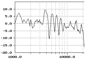

A very interesting graph that. Not a pretty response. Looking at the curve, the 1.5KHz - 3KHz regions are a little better than the rest, so perhaps we don't hear the worst of it if occurs out of our most sensitive hearing regions? About the only explanation I can think of anyway. Worth looking into though.

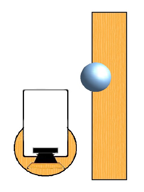

dave
Hi Planet10,
Ok, got the concept!
Indeed considering your thought few post ago about round-thin baffle and it's predictable behavier (and the graph NelsonPass posted above), a sphere mounted somehow to the cab should have optimum effects....(but not easy to built!).
Anyway, considering your draw correction the idea should be, more or less, this.... am I on the way?
Thanks.
Ciao.Fab.
