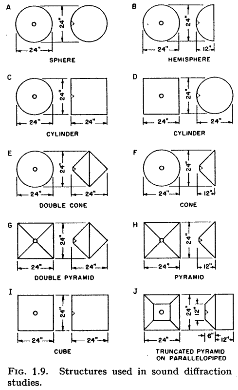

Murphy does not thou show a number of very significant plots from Olson page 23. The full page again:
Of particular note is the hemisphere which shows the importance of the trailing edge, and the truncated pyramid with trailing edges which comes a close second to the sphere and a way easier shape for someone with flat sheets of material and a saw to build.

Attached are the dimensions of the baffles Olson used above... by adding a scaling factor to the results above you can get an idea of what your baffle will do. ie in the case of the latest build of the Frugel-Horn we should have something similar to 1.10 J but with all the values on the x-axis doubled. The same speaker with no supra-baffle will be more like 1.10 I but with the x-axis trabled. As pointed out, the saving grace is that our full-ranges will be beaming at least somewhat at these frequencies so that will ameriolate things somewhat.

I find this discussion of the proper shape of a false baffle very interesting. I was first introduced to the concept with the various circular false baffles applied to TQWT's. These circular plates are supposed to improve wave launch and other claims. I've not run any experiments myself or seen the results of experiments of others, so who knows? I've always thought that they are too thin, usually 3/4", to help with edge defraction, and besides, by the time one uses a driver of any size, say 6" and larger, the driver is beaming sufficiently at the frequencies where edge defraction is important, it may well be a moot point. I use a false baffle in my designs, but it is primarily cosmetic. Since it is smaller than the cabinet width, the only real effect is to increase the edge radius.
From the diagrams Dave presented, the best practical false baffle shape is a truncated pyramid with the chamfer on the order of 6". But wait a minute! If we extend the bottom edge to the floor, there will be no defraction from that edge. Then, doesn't this say that the best edge shape is simply to take a normal rectangular box and put a large chamfer (or round-over) on the edges? And then, aren't we back to the age-old discussion of how much round-over we need on the edge of a cabinet? IIRC, the point of diminishing returns begins around 3" or so.

Too some extent... in the case of the Frugel-Horn & the RonHorns with supraBaffles part of the idea thou is to push the bafflestep down to where additional gain from the horn counters the BS eliminating the need for any electrical compensation.
This also does bring up the point that a BS Circuit will lift the flattened lower portion of the curve to the same level as the falltened HF portion, but it does nothing to the ripple which is just shifted upward in level by the filer.
