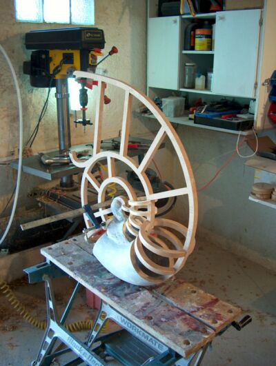

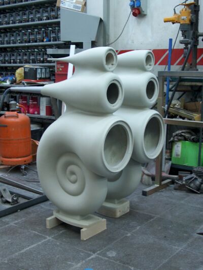

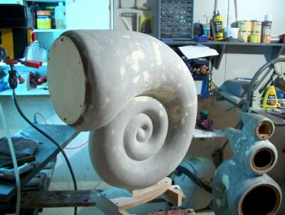

Hello,
It is not so easy, but with some effort it is possible to build this
speaker from wood. 🙂
Here below are some pictures how it would go:
Best regards,
Kristijan Kljucaric

kristijan-k,
you made these enclosures out of wood???
**Incredible**
and i thought my 50hr+finishing solid wood horns are much work... (they are, compared to usual box stuff)
How long did it take you to make one?
do you have CAD-CAM (CNC) machinery to make the parts??
very impressive in any case!
