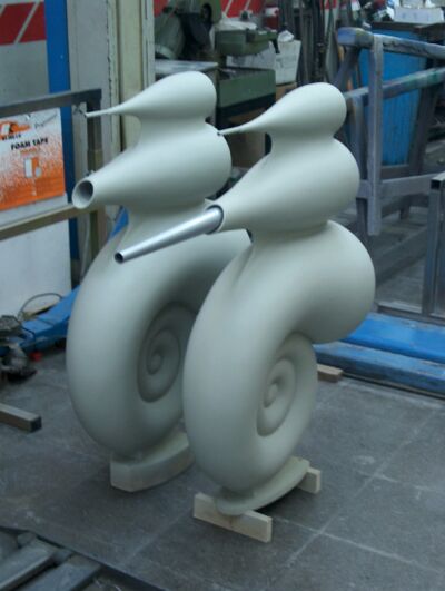

Hello,
These Nautilus clones are hard work of the friend Alfonso de Rojas
from Barcelona, Spain.
The speakers are at this moment still under construction.
When finished, we would start the new thread about DIY Nautilus,
and there would be some aditional pictures and details about the
construction.
Best regards,
Kristijan Kljucaric

Those nautilus speakers... I'm amused it took as long as it did for any one to comment on them. I think we were all too amazed and speechless to find the words for even a simple wow. Making us wait until they are done for more information feels cruel, but worth the wait. The shop looks very interesting too.

I think they look scary enough to give you bad dreams.Da5id4Vz said:Those nautilus speakers... I'm amused it took as long as it did for any one to comment on them.
Re: Stero Lythography
If you can believe, my first words were:
"Wouwww, lo....wait... look what a shop we got here!!!"

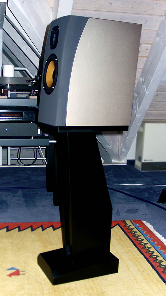

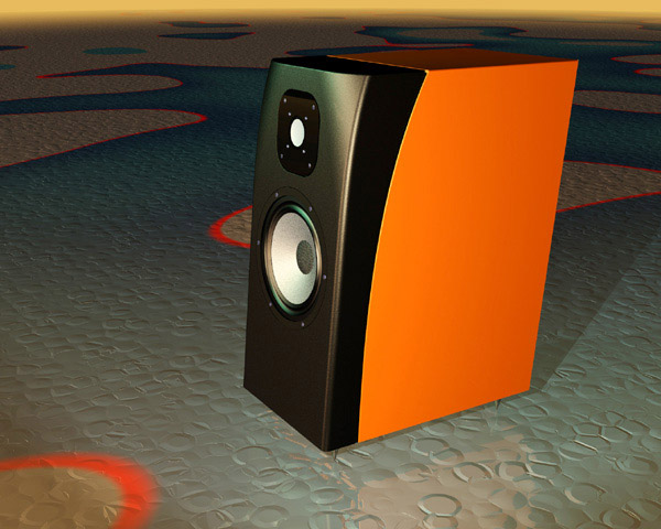

I've gathered some experience with building a baffle for a DIY-project, much a la Hales and the like.
My design only allowed for either heavy CNC work or casting the baffle out of resin, and I wound up doing the latter. But I had to have a mold built (consisting of 4 parts bolted together) professionally which wasn't exactly cheap.
First prototypes were cast in some ceramic stuff, the two final ones in an aluminum pellet filled resin, they came out very heavy (about 6 kgs which translates to 13 pounds US) and dense.
Threaded inserts to mount the drivers were cast in, the baffle then glued with resin to the rest of the cabinet.
Casting loudspeakers or even only parts can be a pain in the b... when you have no experience with casting stuff.......the mold has to have a certain amount of taper to get the parts out of the mold, then usually resin heats up while hardening and expands which can make it impossible to get the part out of the mold. That's why I used the aluminum pellet filled resin!
Anyway the result was worth the hard labor, the finished speaker indeed sounds very "inert"!
Pixs attached........
