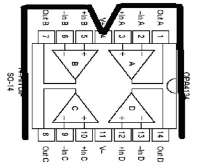

4558S inline op amp needed
Hi Joe,
Japanese parts vendors sell them too. Your friend should have no trouble getting that part. djk's suggestion is good in a pinch.
Sometimes they route power throught the chip (B+), you may have to jumper if this is the case.
-Chris
the easy way
Quad -> in-line
Arne K
Hi Chris,
I realize that djk's suggestion is good in a pinch. I was just trying to find a plug and play part for the guy that was looking for an exact replacement. I cannot seem to find a NTE replacement or anything else listed. Yes, you could use either a quad or a dual with some jumpers and provisions made for the extra sections.
tough crowd
Kiss my op-amp Joe, I am blind, but not as old as SY.
And where you tie off the positive inputs might depend on the chip. There are some op-amps that actually power-down sections depending on V common mode at the inputs. There are even amps where the output will toggle (reverse) if you mess the inputs 'round enough.

Hi poobah,
You could find some NJM4559 or NJM4560 types for Joe.
Joe,
Yank apart most pieces of Japanese audio gear and you will find some NJM4558's. Some may even be the "S" version (sip). Those small Fostex or Tascam mixer - cassette things were full of them.
-Chris
Hi poobah,
Look in za old broken unit. In dar, you find da gold.
To heck with brokers. They want you to buy a ton, not onesy twosy.
The guys who normally carry Japanese semi's will have them, as will every shop in the warranty network. It's one of the most common parts out there.
-Chris
