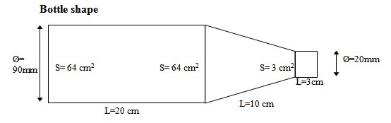

Here is a simulated response for the bottle (using MJK's TL_Open_End.mcd worksheet).
Not very deep bass, but a liitle hump around 150Hz, which i believe is similar to the famous LS 3/5A response, creates a nice illusion of bass.
Not that the bottle is any loudspeaker magic, but it is a surprisingly good temporary enclosure. I believe a longer line, made from PVC tube or similar, with a volume of 3-4 liters would be better, but less fun.
The bottle gemetry is atached.
SveinB.

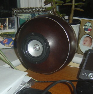

I gave up the bottle
... I could never find a UK bottle of the right size or stiffness, then I discovered balls, or rather spherical wooden vases. Slightly smaller volume but quite pleased with them as computer monitors with a T-amp

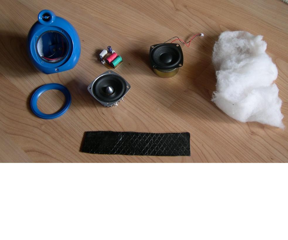

Bjohannesen said:
Hi I have used the TB 926 to upgrade MicroPod speakers, by removing the "woofer" and cross over and adding some damping.
The tweeter is still in place, but is not connected.
Now, these MicroPods sound much different. Better, of course 😉

very , very cute. I love them ! The problem with the spheres is that the center of gravity is forward and they tend to roll forward. I sit them in large O-rings and , with the speaker cable connections they remain still, but it's not ideal. These mini-tripods are a much better idea.
