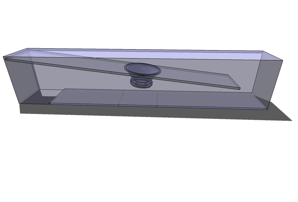

The design is a Mass Loaded Tapered Quarter Wave Pipe (MLTQWP).
It has a single fold with an 18hz tuning (88" x 20" x 18").
Since the access panel for the driver is "mid-ship", the driver "taps-in" with an offset 25% from the start of the pipe.
The rear of the driver "taps-in" with an offset 25% from the mouth.
That's my theory, and I'm sticking to it...
I do not believe it can be modelled yet.
Martin has stated that it is not currently on his "to do" list.
He does say, however, that it can be done (see here) ...
http://www.diyaudio.com/forums/showthread.php?postid=879165#post879165
Any ideas / suggestions?

Re -reading the white paper it looks like the tap is working at the higher freq's.
It looks like the horn in the white paper is approx 1/4wl 38Hz horn. the back of the driver will be driving the horn from near the mouth, and drives it at the point where it's 1/2 wl from the throat. Putting the back of the driver near the mouth, say 180cm from the throat will mean the tap will be working at around 95Hz.
This makes sense as the paper says you can drive a 1/4 length horn with a suitable driver, but it won't work at the higher freq's as its not a 'conventional' horn driver. Looks like the tap makes the driver appear more like a conventional one at the higher freqs.
Rob.
Rob.

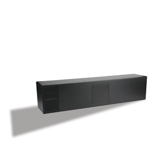

Clearly the white paper is not referring to the Tower of Power.
The TOP has a tuning 18hz (16hz - 150hz, +/- 3db)
The outer dimensions of the TOP are 88" x 20" x 18"
For that tuning and those dimensions, it has to be a single-fold pipe.
The driver is in the middle (well, the access panel is)
The line is tapered (Mark Seaton mentions this in an email).
The mouth is "undersized" (mass-loaded)...

MJK has stated that none of his worksheets will properly model the tapped horn design.
(other no-nos include the acoustic cannon, and the transflex design)
One might argue that this is a 6th order series bandpass design.
1. The 1st half of the pipe is the 1st chamber.
2. The fold is the "port" -- exiting to the 2d chamber.
3. The 2d chamber (the 2d half of the pipe) then ports to the world.
Yeah, I know, its a reach, but I think MJK's double bass worksheet can model this design...
