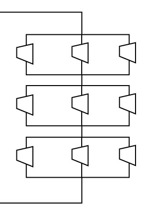

The image below is a copy of one in Ted's 1963 Loudspeakers book, in which he talks about using multiple, widebandwidth drivers. The aim was to get increased power handling to enable smaller units to be used which would have a better transient response than larger cone drivers. He says:
"the number of units used must have an integral square root. Such numbers are 1, 4, 9, 16, 25, etc. ... the combined impedance is that of a single unit."
The idea of a 9-unit array also cropped up in some of his sales literature in the 90s but there isn't any indication of whether it was necessary to tailor the response in any way. I did hear a 9-unit array when Jordan Watts used his J51 units at a hi-fi show in aorund 1991. I thought it sounded pretty good. Certainly went loud.

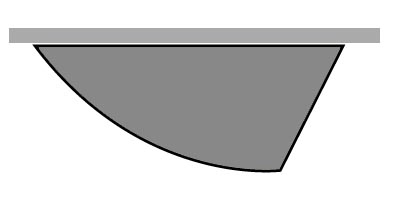

Back to cabinets (where I feel more secure), the plan view of Ted's linear array cabinet is something like the drawing below. Its similar to the plan on his website but with a curved side - so no reflecting surface directly behind the drivers. Mounted on the wall, it's very discrete.

The curved-wall cabinet also looks like a good precaution. Will have to look into the feasibility of that one with our cabinet maker.

Just checked my copy of Ted's book, re numbers of drivers having intergral square root. This is so the array has the same impedance as a single driver, and the power was shared equally between all drivers. The first point was more important then as amp output transformers needed to be matched to the speaker impedance more closely, but today is less important with SS amps. The second still applies unless some steering effect is required for some reason.
Note this book does not cover his later work on Al foil cones, but is still worth having, being a good easy to read introductory text(as is G A Briggs book of the same name). Having read these, the more modern books with a more mathematical approach are much easier to understand.
It is surprising how much was known then, (found out by experience), and has since been "forgotten". A case in point is the use of resistance in the speaker leads, (Briggs),to compensate for a rising response in some (full range) speakers such as lowther, a point explored much more extensively by Nelson Pass.
