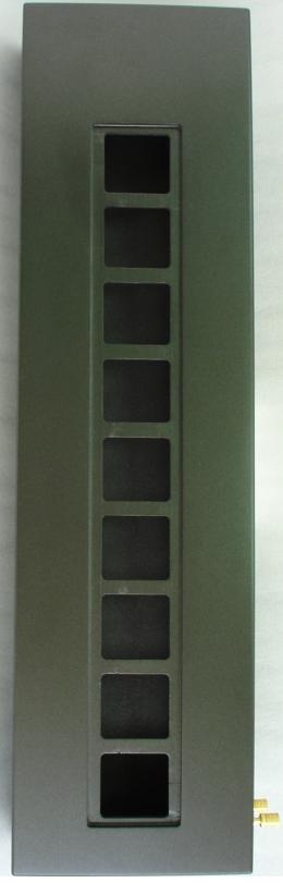

here we go - 9 driver linear array with the JR6
The test boxes arrived, honeycomb sealed cabinet, about 16L, wide baffle and cutout for 9 drivers. Will tomorrow post a pic of the cabinets. In the meantime I've tried to gain an understanding of the nearfield vs farfield combing issues with the 4 driver array. So far as I hear combing is not an issue in either case but expecting the worst and hoping for the best.
Ted Jordan was very gracious in a telephone conversation to give some guidance about the cabinet and placement, and not to worry (in our large room) about mounting the drivers on the angled edge of the box. This was a relief as I definitely wanted them in the wide part of the baffle. It's worked out very well for the 4 driver and I've kept the same cabinet depth and width, just making them taller. Ended up pointing the 4 drivers directly at the listener to get a deep soundstage to the ceiling and well outside the speakers. The arrays are not the champions in the pinpoint imaging department such as the LS35A but not noticeably lacking either.
It seems linearrays need more tweeking of positioning to get the best out of them but I'm slowly learning and getting a very smooth dynamic sound now. So looking forward to 9 drivers which will be roughly equivalent to an 8" inch driver but with the combined motor power of a strong 15" AND free-to-air like a ribbon!
Plans are to connect them as per Colin's posting from Ted's book.
Cheers
Brian
