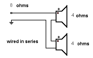

dave tell me if i got this right, im just working out the wiring. i wana get 8ohm. each driver is 4ohm two driver in series is 8ohm?
and to change the watts, do i wire each set in parallel?

karma said:dave tell me if i got this right, im just working out the wiring. i wana get 8ohm. each driver is 4ohm two driver in series is 8ohm?
im going to need a lot of wire 😉
Looks ok to me.

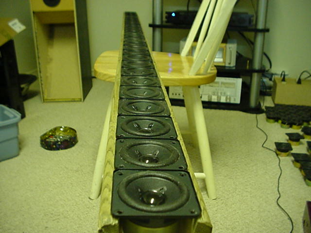

karma said:i wana get 8ohm. each driver is 4ohm two driver in series is 8ohm?
If you use 32 drivers in the array, wire 8 in series (32 ohm) & pararallel the 4 sets and you end up at 8 ohms. Or wire 4 in parallel (1 ohm) & series the 8 sets.
Power handling is 32 x power handling of 1. Efficiency is about 14-15 db more than a single.
dave
planet10 said:If you use 32 drivers in the array,
That comes to 2.24m ~88 inches. Hope you have (at least) 8 ft ceilings 🙂
dave

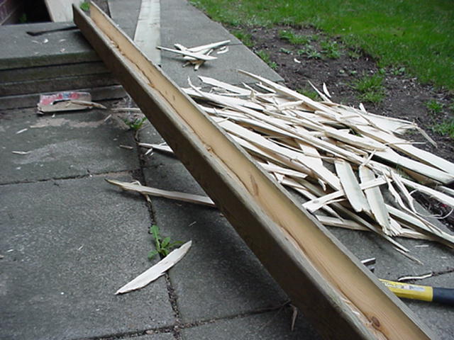

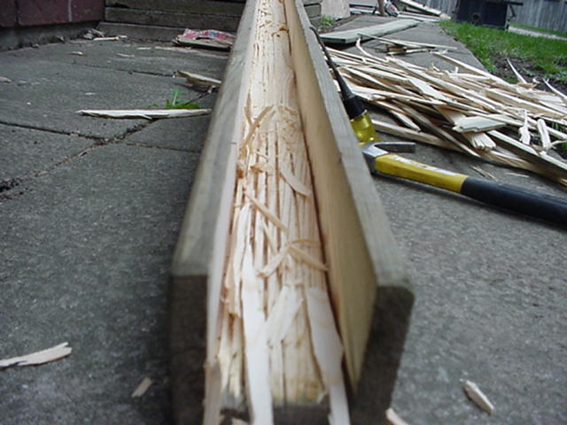

karma said:!!doh!!😀
I have a idea how you could have done this nicer and faster 🙂
Jase
Joined 2002
Table saw moveing the blade over after each pass. Do you have a table saw? Did you use a chissle 🙂
Joined 2002
Cal Weldon said:Why would you not just use three pieces of wood?
His idea is better 🙂
jleaman said:Table saw moveing the blade over after each pass. Do you have a table saw? Did you use a chissle 🙂
i used a axe chissle and table saw
Joined 2002
karma said:this is two piece the front and the shell, less joints to glue😉
stain it dark it pops

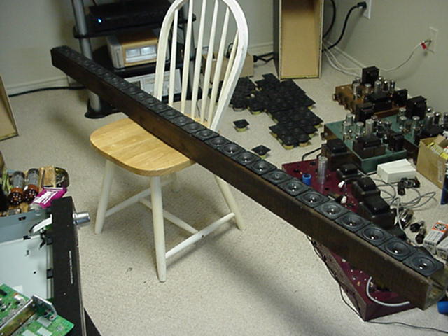

Hey look at those purple amps 🙂 Thos mine ?
Joined 2002
karma said:those would be the ones😉
Maybe you can email me more pictures inside outside close ups etc etc ?
you can see pictures of the amps on my webpage under projects.
