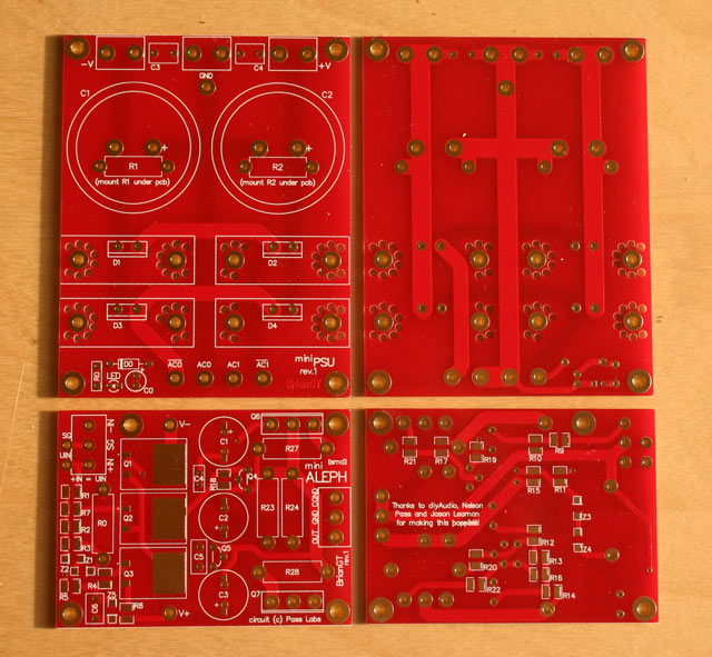

Excellent! I hope it goes well. Here is a pic for what Mark will be giving out. Red boards with gold plating. The pcb set contains 2 amp boards and 2 psu boards and is 6" x 6"
Brian

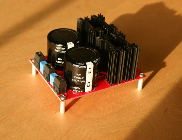

BrianGT said:Picture of new PSU board. I had these caps on hand, but will be using 22,000uF 35v caps on my prototype board, which are 35mmx40mm instead of these ones which are 35mm x 30mm,
Brian

Thinking that the class A power amp requires wide inner space, I wonder why trying to make mini PCB . . .
Any good argument?
Any good argument?

jh6you said:Thinking that the class A power amp requires wide inner space, I wonder why trying to make mini PCB . . .
Any good argument?
The purpose of the mini a's are cost and sound.
The cost to build a single channel is so low it's quite worth it in every way..
Sound well i know a few people that run them with fostex speakers and like the sound. Personally i like them better than all the amps that i have.
I have no doubt as to your amp.
My question was about any worth making "PCB" mini even though the space is wide enough allowing large size of it.
My question was about any worth making PCB mini even if the space is wide enough allowing large size of it.
I don't get what you are saying ? Space ?
jh6you said:My question was about any worth making PCB mini even if the space is wide enough allowing large size of it.
If you are referring to the large surface area of the required heatsinks required, as compared to the small size of the pcb, my motivation to make the small boards, was the prospect of shorter signal paths and the general novelty of smaller boards.
The smaller boards, when used with the 10-15w configuration, simply allow the devices to be mounted on the pcb and screwed directly to the heatsink. This makes for easy output device wiring and greater options for chassis design. The board is 3" tall when mounted in a vertical manner.
Here is a picture of the first version of this project that I made over 2 years ago:
http://www.briangt.com/gallery/albums/mini-a/mini_1.sized.jpg
The new boards allow for accepting balanced input, unlike the first revision of the SMD layout.
Brian
