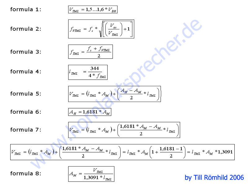

Starting the calculation:
First we need the optimal BR volume (VBR) and calculate it with the factor.
(-> formula 1)
Simplified we can calculate the tuning frequency (fVTML) of the driver in that volume.
(-> formula 2)
The tuning frequency of the TML length (fTML) should be between the free air frequency (fs) and the tuning frequency (fVTML) of the driver in the volume.
(-> formula 3)
We get the length with:
(-> formula 4)
When we have found out the optimal volume we can calculate the starting and ending sections. All we have to do is to convert the formula for the volume. The requirement is that the sections stand in a certain percentage.
(-> formula 5)
(-> formula 6)
(-> formula 7)
Opening section is than:
(-> formula 8)

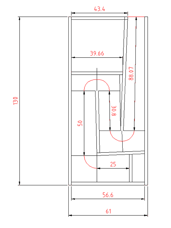

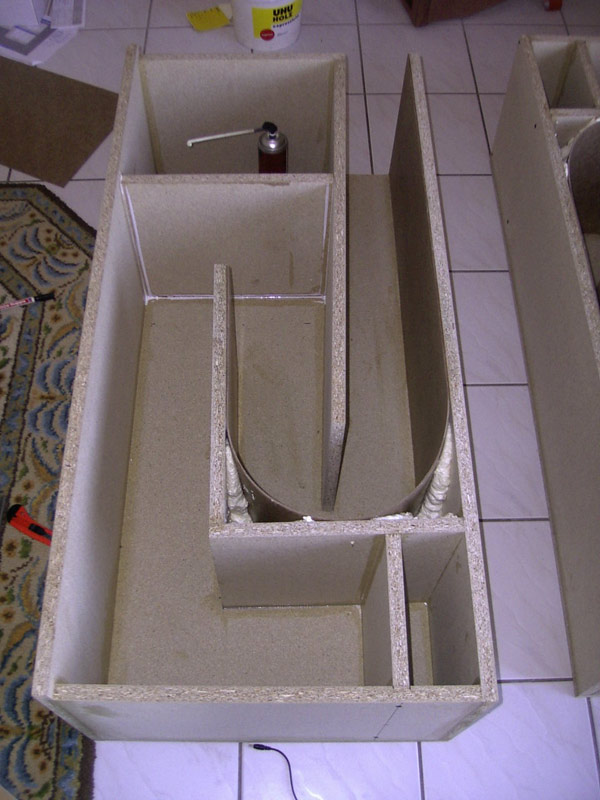

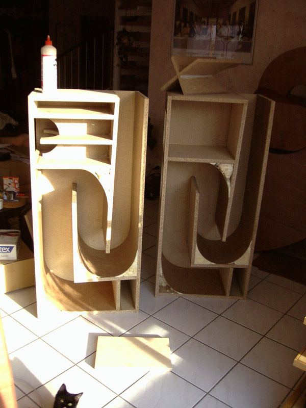

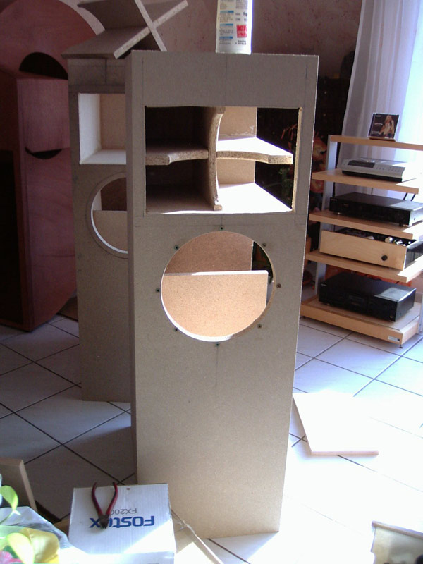

One small detail and I'll look over the rest for some time before I answer to your thoughts in detail. My problem is, how does the sound get to the "tube"? Or, have you just not cut the necessary wood for the transmission to the tube.
Hi Bose(o)
I have planed to place the driver at 1/3 of the lenght as you can see on the picture below.
The lower camber is to adsorption a frequency at 200Hz.
The upper camber is for a fullrange driver (the Coral 8A-70).
I haven't finished the frontplate yet.
regards Till

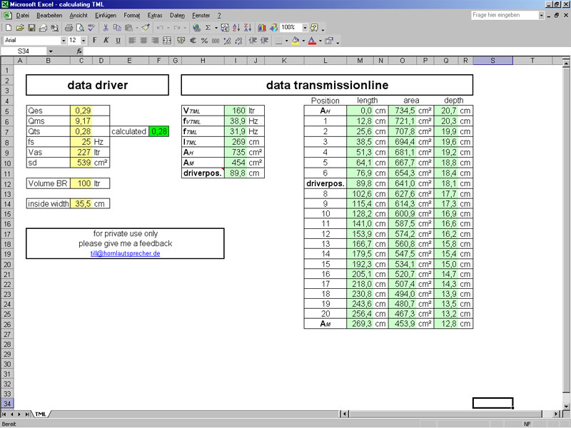

Hi @ll
I dont know how I can post an excel-sheet but if you give me your email I can mail it to you.
best regards Till
best regards Till
GOTCHA! Looks great from what I can see. Also, what wood are you using for the curves in the line?
I too would like the spreadsheet.

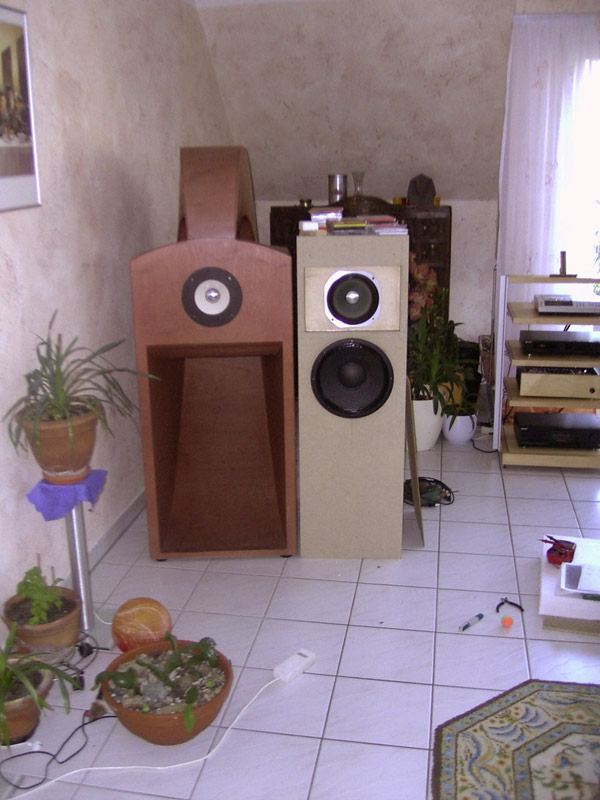

latest update

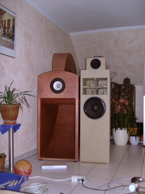

here is my last picture. Next week I will build in the Coral 8A-70. Right now a 17cm Philips fullrange speaker is added.
The sound is getting better every hour. The woofers are new and the sound was a bit strange in the beginning. Now it is getting better and better
cya Till
cya Till

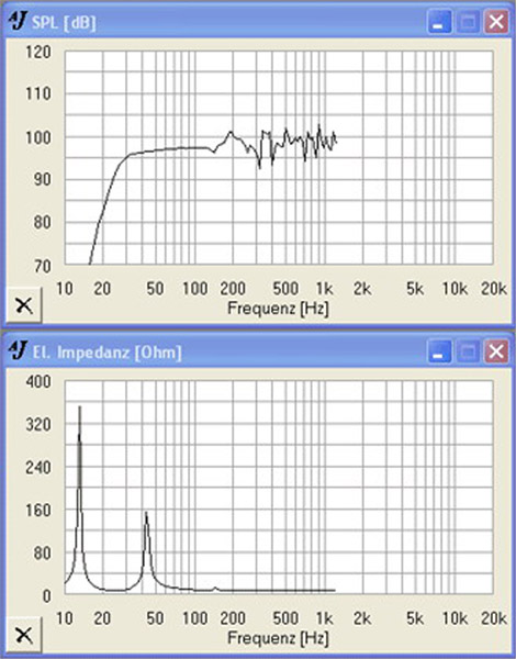

Wow, you work quickly, is it you week off? Good work none the less, I love seeing your updates. Is there any chance that you'll be able to take any measurements?
HDF = "masonite" here in the US, if i'm not mistaken
you should be able to attach spreadsheets (or zip them up and then attach the zip files)
good work, ...what's the other speaker in the pic?
hi zobsky,

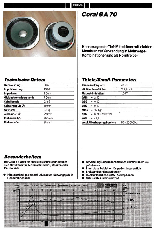

wath speaker do you mean? the left is a Fostex FX200 in a BL-horn from me.
And the Coral 8A-70 is an old fullrange speaker with very good parameters as you can see on the datasheet.
The woofer I am using is a Fostex W300A-II

I don't use measurement but I hope a friend of mine will/can help me out with that. If I have pictures I will post them.

since yesterday evening the TML is playing with the Fostex woofer and the Coral fullrange speaker.
So far I am very happy with the sound. The TML is playing very deep and with a lot more control than the FX-horn. Sometimes you have the feeling that the woofer is not on and as soon as you want to check the wireing you can feel and hear the bass. It is never intrusive (??) or booming.
The sound of the Coral is fitting perfect to the sound of the Fostex.
I will play the next days with the volume and the X-over.
cya Till
