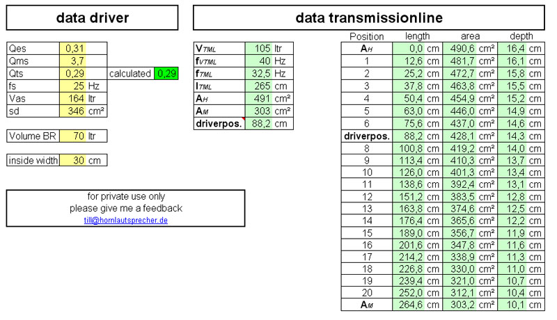

the "normal" design is that you use the surface area [Sd] from the driver for the opening area [Am]. The staring area [Ah] from the TML is 1.5 ... 2.0 times larger.
Than you have the length [l] of the TML according do the resonace frequency.
With a 12" with 25Hz would that mean:
Ah: 810cm² (1.5x Sd)
Am: 539cm²
l: 3,58m
The complete volume of the TML would be 241ltr.
I started with the volume. I thought that a TML needs 1.5 ..1.6 times more volume than a normal BR. My driver needs 100ltr BR so the TML has got to be 150ltr.
The reso of the driver in 160ltr would be around 45Hz. I have placed the line frequency between the driver reso (25Hz) and the volume reso (45Hz) = 35Hz
Now I know that the line has got to be 2.75m long.
Ah is 1.6 times bigger than the Am.
Using the formulas I calculated how big Am and Ah will be.
The driver is just at 1/3 of the length like in a usual TML.
hope I could explain it to you.

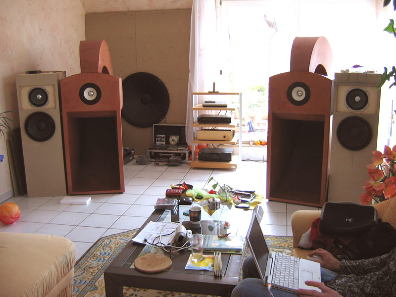

New way to build a transmission line
Hi Roemhild, I received a copy of the spreadsheet. Thanks for that. Am playing with it a bit for now. I am interesed in how you calculated that lower chamber to reduce the resonance. I have started a thread on this but it seems to be missed. Could you help with this. How to calculate for the frequency and the volume to absorb a given peak? Do you have a spreadsheet on this.
I did follow your original article on the back loaded horns as well. I take it that you prefer this TL to the BLH?
I'm looking at Onken enclosures now also.

Hope this helps:
http://hyperphysics.phy-astr.gsu.edu/hbase/waves/cavity.html
Lots of additional information at this site as well. Thanks!Cortez said:

Hi Jamikl,
I sometimes use the tool from this side:
http://www.lautsprechershop.de/tools/index.htm?/tools/t_helmholtz.htm
To your question if I prefer BLH or TML I still have to say that a good build front loaded horn is still my personal favorite. If I have to choose between a BLH and a TML I can't say. Right now I am switching every day between these two speakers. It always depends what I am listening to.
1. reason for a BLH:
I don't think tat you could build a fullrange driver in a TML --> TML = 2way or 3way system
2. reason for a BLH:
You cam play better with the design for the horn as you can see it on the FX-horn or other great designs like Nelson Pass did it
http://www.passdiy.com/speakers.htm
1. reason for a TML:
The complete TML is a lot smaller than a BLH.
differenz between a TML and a BLH:
the bass of the BLH is a bit smoother. The bass from the TML is a bit more "natural".

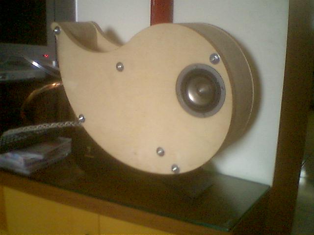

Roemhild,
I'm working on a small speaker with short BLH. Designed to be placed back against a wall but seems to work quite okay if standing out a bit.
A local drive manufacturer was kind enough to try some modifications to meet my needs. Still some fine tuning going on in the upper frequency.
Here's a pic taken from a phone.
