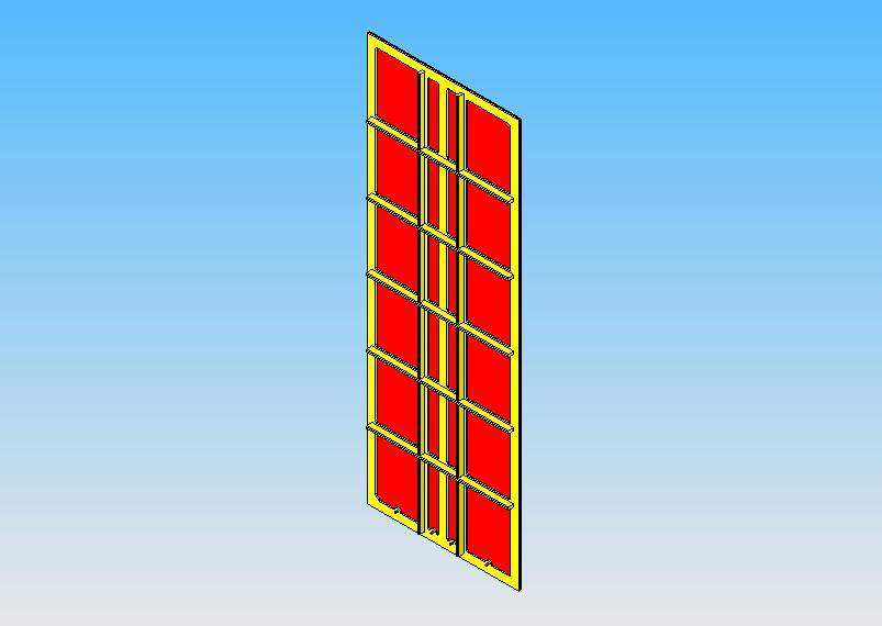

The insulators are described in the Stacked Acrylic ESL Insulator thread. Here's a rendering from Solidworks showing a completed panel. The acrylic insulator is yellow and the stators are red to make it easier to see. The whole driver will be white in real life.

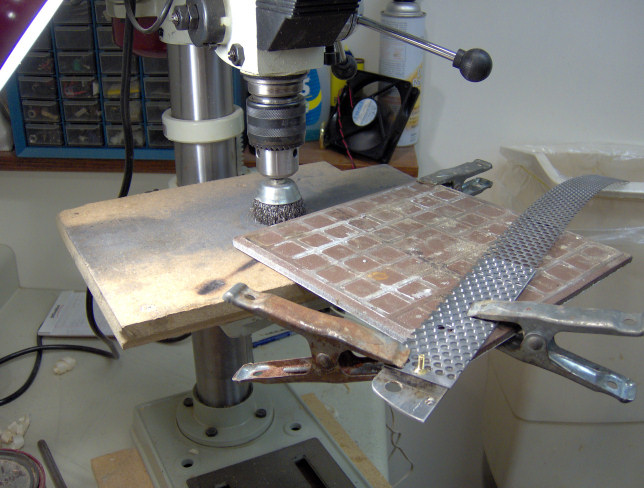

The biggest challenge with the perforated stators was deburring all those holes. I settled on a knocking down the burrs with a file and finishing with a round wire brush in my drill press. With the drill press table touching the wire brush I could slide the stator back and forth to round over the perforated holes. My US$80 drill press strained and I had to let the motor cool frequently. It suffered no major damage.😀
Here's a photo of the drill press and one of the smaller stators with a 3/8" brass screw for electrical connection soldered in. The screws were later changed to 1/2" steel. The screws are attached with 60/40 rosin core solder in a 1/4" milled hole. The solder connection is weak, so I'll need to fill the screw's clearance hole in the insulator with epoxy so it doesn't pull out of the stator when tightened down. Next time I'll use a smaller, countersunk hole in the stator. The stators will be powder coated white.

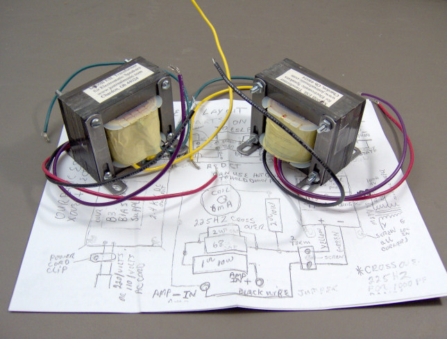

Audio step-up transformers with a budget like mine were a problem. In this thread, Calvin shows very positive results for using toroidal voltage step-up transformers as ESL audio transformers. I wasn't able to find the toroids I needed at a reasonable price and the custom transformer winders didn't seem interested in a two piece order.
After searching the 'net I bought a pair of M99B transformers from Russ at JustReal Music. 50:1 turns ratio, 225 Hz low frequency crossover, and very reasonably priced.

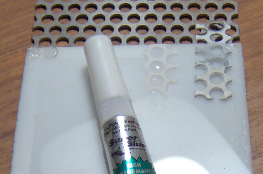

I have had success with super glue.I used plexiglass stators , don't know how does it bond to your ones.
Lukas, thank you for the suggestion. I tried a small powder coated piece of perforated steel glued to a scrap of acrylic. It works great! When I tried to peel the perf. off, the powder coat came off the steel and stayed stuck to the acrylic.
The bare metal behind the white acrylic in the picture is 0.059" thick and was glued on two sides. I bent it when I pulled it off. 😀

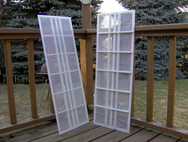

Here's a picture of two completed assemblies. Inside shown on the left and outside on the right.

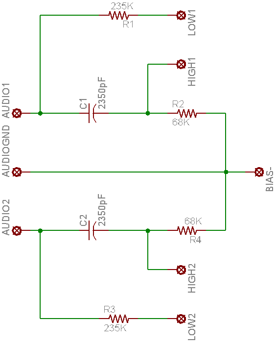

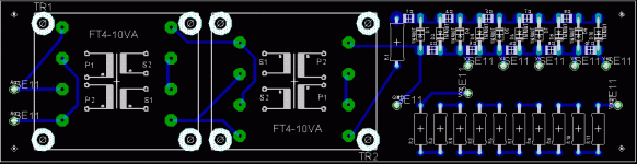

I've been working on a two-way crossover circuit for the 1-1/2" wide and the 4-1/2" wide sections of the ESL panels. I've got a first order crossover at 1040 Hz that sims well using available components.
Here's the simplified circuit. The audio step-up transformer is connected on the left. The bias supply is connected on the right. Each of the four stators is connected to one of the center four points.

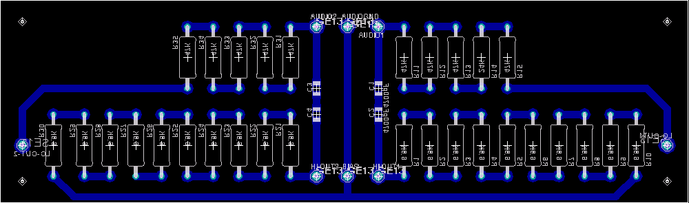

Because of the high voltages and power dissipation of 2 and 6 watts, the resistors are series connected 1 watt Xicon carbon film. The capacitors are series connected 4700pF 1Kv Murata SMD. I'll be using SMD capacitors on the bias supplies, too. The board measures 2 x 6-5/8".

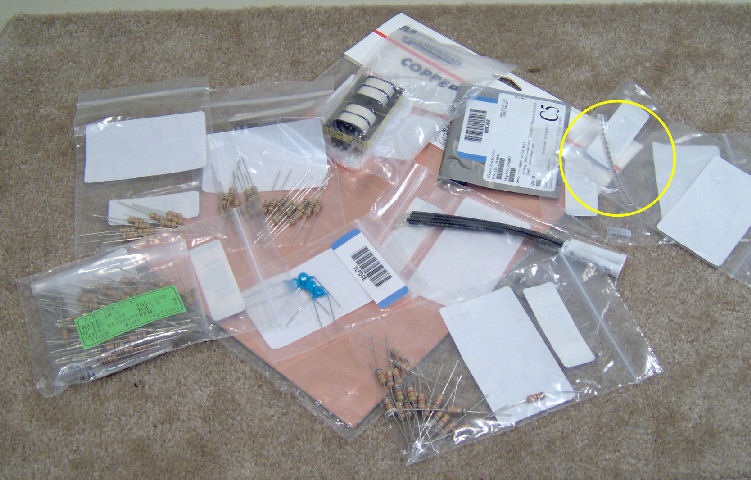

Parts came in today. Almost everything is there. Two transformers are back ordered, I ordered the wrong IEC connectors, and forgot to order the 330K resistors for the bias supply. I'll have to dig through my salvaged parts for IEC connectors and resistors.
The SMD capacitors are really small! There's a strip of twenty of them circled in yellow in the photo.

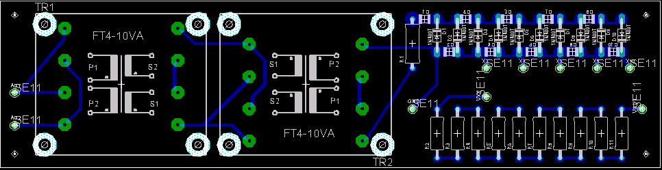

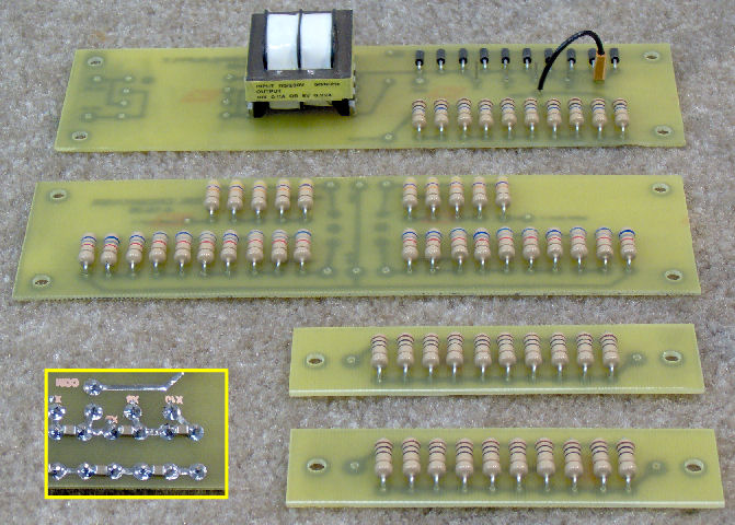

Here's a photo of the almost completed circuit boards for one channel.
The high voltage bias supply is at the top. It's missing a transformer that should be here this week. The black wire is a jumper to select output voltage. The inset image in the bottom left shows some of the SMD capacitors on the solder side of the board.
In the middle is the two-way crossover. It has four SMD capacitors on the solder side of the board.
The two boards at the bottom are resistors for the input side of the audio step up transformer. They're 1 ohm 10 watts per board. I wasn't sure of the value I'll need, so I made two for each channel.
The boards were done using the laser toner method. It's the first time I tried it and it worked quite well with only one defect that couldn't be fixed with solder bridges.

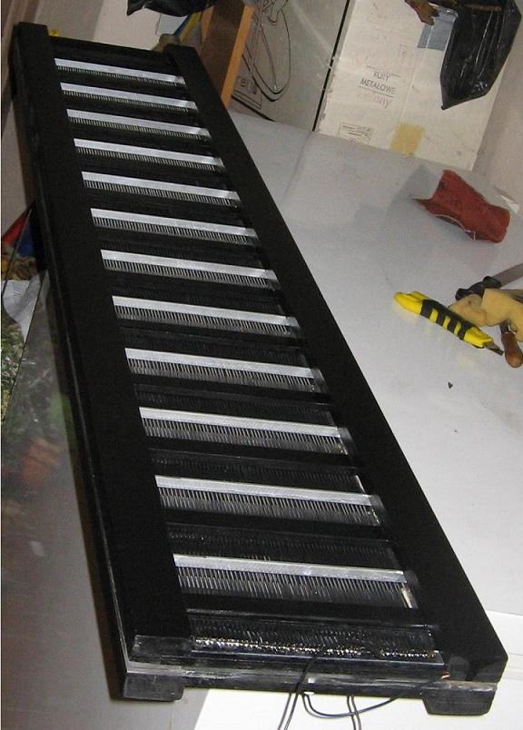

Here is my first wire ESL. I is not finihsed yet , but sounds already🙂.
For now , i have only a "U" power trafo to test it. Sound is not that bad , even with poor transformer , and it has bass, though i feel that a sub is needed.
Lukas.
