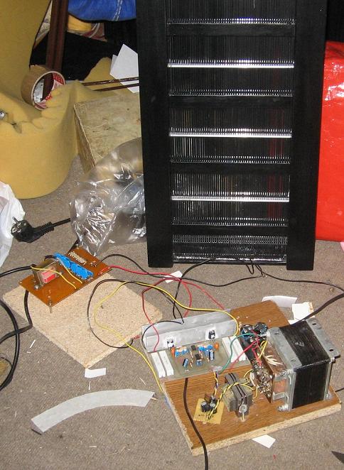

The panel's effective area is 19,5 x 140cm.
For now , i am trying to direct drive panel with FET's , at 400Vrms it sounds no quet , but the amp is still a bit too distortive.The bass sound deeper with direct drive amp.

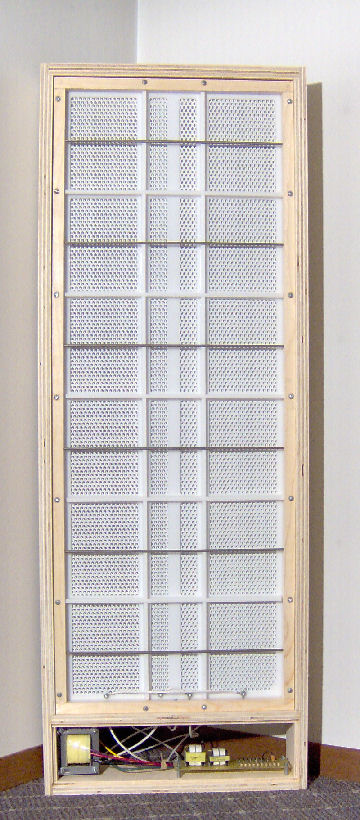

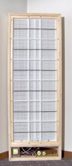

The enclosure and wiring are almost done. The outer plywood skin measures 43-1/4" x 15-3/4" x 3-3/4". Inside of that, the inner front and back frames hold the ESL panel in place, attached to each other with eighteen 8-32 screws.
The ESL panel is held together with four 4-40 nylon screws, one in each corner, just to hold it together until the panel gets mounted to the frames. The edge of the panel gets squeezed between the frames with a thin, self adhesive foam from the craft section at Walmart between the frames and the panel. I still have to pick out a foam color. :D
I've tried to make the ESL panel as stiff as possible with 1/4" thick acrylic vertical ribs. I needed a way to hold the inner part of the ESL panel together and I didn't want to glue the two halves of the panel together. The small grey horizontal strips in the picture are 5/32" diameter round steel bars, six in each frame, one behind the other. They're deflecting about 1/8" in the middle, squeezing the two halves of the ESL panel together when the frames are tightened.

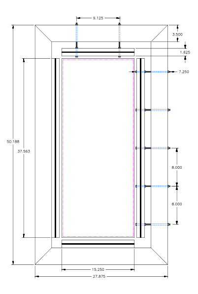

Here's a drawing of the stretcher I'm building. The outer part of it is glued and the whole stretcher should be done in a couple of days. It's built with 2" x 4" lumber salvaged from pallets. The diaphragm is tensioned by tightening nuts on the running thread on two sides. I'm not sure how well it will work with pull on only two sides, rather than four. The dark bars in the inner four pieces represent slots that will have 7/64" plastic spline pressed in to hold the diaphragm n place while stretching. It's the same spline used to hold the screen in screen doors.

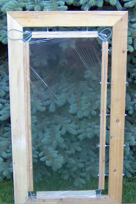

Here's a photo of the stretcher with the first piece of Hostaphan diaphragm installed. I learned some things that will need to be fixed on the next try. The first thing I noticed was how hard it was to get the diaphragm tensioned equally as I pushed the plastic spline into the grooves around the outside. It turned out OK, the multiple threaded rods let me skew the tension to get a nice flat film.
I tapped the diaphragm with a finger, tensioned some more, tapped again, tensioned again until it sounded like a drum head. It works!
Then it happened... A small rip revealed itself and that's why you see ripples in the picture. As I was inserting the spline earlier, the spline tool slipped and must have cut or weakened the diaphragm. No problem as this was a test run. One of our dogs put her foot through the diaphragm shortly after this picture was taken and I accidently put my elbow through it as I was bringing it back in the house. Gotta treat the Hostaphan a little better next time. :D

I think it will be difficult to get good results from such a diaphragm stretcher. There are a couple problems with it, and you can see evidence of them in the photo.
You have secured the film to the stretcher bars by trapping it between a spline and a groove in the bars. The problem with this is that it does not allow the film to stretch at the point of attachment to the stretcher bar. That means the majority of the stretching is occuring at the corners where the film is not so constrained.
If you stretched the diaphragm in one direction, say the y axis, with the edges of the film unattached to the bars that provide the x stretch, then the film would stretch in the y direction, no problem. Now if you attach the film to the x bars and try to stretch in the y direction, what will happen? It will wrinkle because you're not allowing the edges of the film to stretch in the y direction. Now restrict both x and y edges of the film and try to stretch it and what do you get? You will put very large tension on the unrestricted corners of the film while putting almost none at the center. Your film stretching will have to stop before the diaphragm splits, which will occur first at the corners since they are under the most tension.
High tension prevents the diaphragm from moving too far and hitting the stators. In the corners and at the edges of the speakers, the film can't hit the stators because it is supported by the insulators, so having high tension in the corners and at the edges is not so important. The center of the diaphragm is where you have to worry about hitting the stators, so that is where you really need the tension.
The ideal(?) situation would be to have uniform tension over the surface of the diaphragm. This can be achieved by using a circular stretcher, but it is usually not practical due to the width of the diaphragm film that is comercially available (works great for headphones and microphones). Since uniform tension is not practical, the next best thing is to get the tension at the center of the film up so that it will be less likely to contact the stators.
You can make a much simpler stretcher that will provide more uniform and much higher tension by simply stretching a bicycle tire tube around a table that is a little larger than the speaker. Lay the film out over the table and uninflated tube and attach the film to the inside/underside edge of the table using either tape or a spline and groove.
Inflating the tube will stretch the film very tight, with more uniform results than the x-y stretcher. As you inflate the tube you will notice that the film is able to slide/stretch over the tube (unlike the spline and groove in your design). You will also notice that the corners inflate less than the long dimensions of the driver. This means the tension in the central area of the diaphragm will be quite high, while the corners will be lower and less likely to split. The air in the tube can and will go wherever it needs to to make the tension approximately uniform. If the film is pulling tight at one location, it will restrict stretching of the tube and force the air to go where there is less tension, thus equalizing (approximately) the tension everywhere.
I have not tried to make a stretcher table for such a long, narrow driver, so you may run into some problems there, but for drivers that are a little closer to square, the pneumatic stretcher works great. I suggest you give it a try. It only takes an hour or so to make one. It shouldn't matter that the table is bigger than a tire tube. Tubes stretch a lot.

as Forgot said, Your stretcher is not designed for very good results.
I used a quite similar stretcher to good results but with the following differences.
In the Y-direction (long) I divided the moveable parts into 2 to 3 sections, each section with two threaded rods with nuts to screw the diaphragm tight. I used 1 section on each of the X-sides. So there are 6 to 8 sections connected to the outer frame. The threaded rods of the Y-sides run in small slots, so the sections can move a bit when stretching in the Y-direction. While the outer frame has to be very strong the moveable parts can be made from coated MDF-board, 30mm wide. You can glue the diaphragm to it with double sided sticky tape. This way You can get very high tension in one or both directions. The sticky tape is easily removed after stretching. If You replace the straight X-sections by bowed ones You can even stretch the diaphragm for ML-type panels ;)

I_F and Calvin, thanks for the input.
I did have a feeling something wasn't quite right with the stretcher. I may be able to equalize the stretch better by securing the y first and stretching it and then securing and stretching the x. The spline seems to pull the film too much when it is installed. I'll try tape to hold the film instead and see what happens.
I_F, I originally wanted to try the inner tube stretcher, but a 27" inner tube, the largest I could find seemed too small to fit around a jig for my panel that measures 14-3/4" x 37-1/16". The other difficulty I had with it conceptually was getting the width and height to stretch unequally. Since the y must stretch more than the x, do you think an inner tube would work as a rectangle? It seems to be a perfect solution as long as the jig is a circle.
Calvin, I could easily separate the stretcher into multiple sections and oval some of the clearance holes for the threaded rods.
I like both of your ideas. I'll try them this weekend and get back to you.
