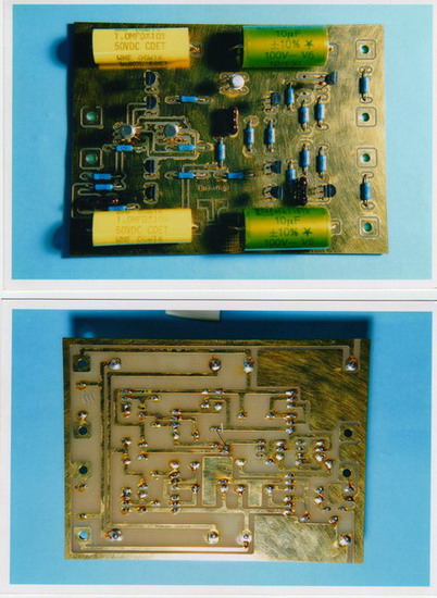

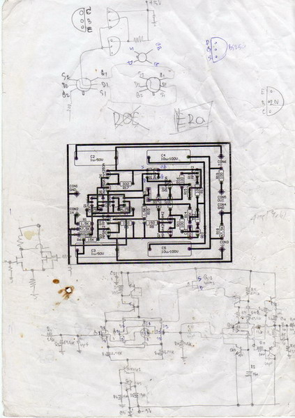

Threshold Fet 10/hl Opinion ?
From my remember about 1 year ago I had post...
http://www.diyaudio.com/forums/showthread.php?s=&threadid=41104&perpage=10&pagenumber=4
I found a lot of sorce of them schematic / PCB / parts, does anybody want to make them to DiyAudio Project ?
I'm notice in parallel DUAL JFET input(original are NPD5566 but I uesd 2Sk332), better than 1 pair DUAL JFET ? I can't find it's difference.
What's quality of 3N172 mosfet, Could I use BS250 insted of it ? (now I used SMD irfd 9120)
I had searched (real) THRESHOLD FET 10/HL PCB for many months, I'm very tired, Could anybody decide to work with me ?
Regard
analog guy
