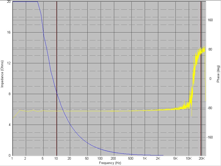

Here is a picture of a 2200µf 50V capacitor's reactance and phase response and I have a question about the phase response (yellow line). I expected the phase to remain flat at 90° across the entire frequency range but it starts changing at about 100hz. Is this normal ? I measured a 10µf polypropylene cap and the phase was indeed flat at 90° throughout. Can someone please explain what's going on ? Thanks.
P.S:- Is the peak around 2hz the self-resonance of the capacitor ?

I think the hi imp peak is a measurement artifact.
The low frequency impedance should keep rising until leakage becomes the limiting effective impedance (10s of kohms).
I am slightly surprised that you have not detected the rise in impedance by the time you got up to 20kHz. That would be more typical of electrolytics.
I think the self resonace of larger electrolytics is in the region of 10kHz to 20kHz. It is at or above this that you should see that rise in Z that I mentioned earlier.

The phase changes from 90º towards 0º as the frequency is increased because the capacitive impedance becomes so ridiculously small at high frequencies that the series resistance of the capacitor and the test fixture dominate instead.
Then, the phase continues rising towards 90º because the inductive impedance of the capacitor and the test setup is no longer negligible in comparison with the corresponding resistive impedances, and it ends up dominating at higher frequencies.
Try to reduce the resistance and inductance added by your test setup and you will get more realistic results.

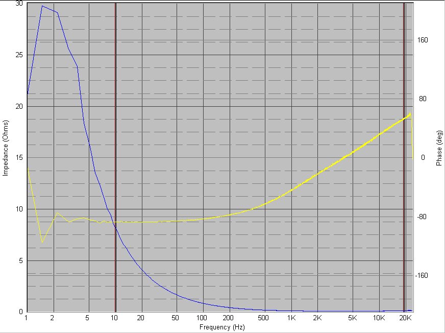

Notice the -180 to +180 phase shift at 11.5Khz.

Could you explain which equipment are you employing for that measurement? Now it looks as if the impedance of the capacitor became much smaller than the output impedance of the own measurement system, thus fooling also the measurement. Is the measurement system trying to put a constant AC voltage across the capacitor and measuring the current, or is it puting a constant current and measuring the voltage?

Speaker Workshop, with a Turtle Beach Santa Cruz soundcard.

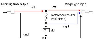

It has the ability to measure passive components. Its range is limited but as you can see it can measure something like a 2200µf cap with reasonable accuracy.
I believe it measures the voltage across the DUT. Look at the jig schematic that I use. That should give you an idea.
I tired a couple of different low value caps in parallel with the big electro, and lower the value of the parallel cap, better was the phase response. With the last 8.2µf polyprop cap that I tried, the phase response was almost flat to 10Khz then rose to +90° by 20Khz.
I cannot say whether lndm is right or not but it sure does raise a question in my mind - what effect would this type of phase behaviour have on the sound ? Because, agreed that these anamolies are being caused by parasitic inductance/resitance, but then again isn't this actually close to the "real world" scenario where such parasitics are bound to exist ?

Well, the problem here is that the output amplifier of the soundcard is trying to apply an AC voltage to a 2200uF capacitor at high frequencies, and obviously it can't do that directly. Also, another problem is that due to the extremely low impedance of the 2200uF capacitor, the feedback signal turns ridiculously small at high frequencies and ends up buried in the noise floor.
Try placing a 10 to 100 ohm resistor in series with the output of the soundcard before the test fixture. Try also using a 1 ohm reference resistor instead of 10 ohms. Increasing the recording level in the recording mixer control may also help.

that connection schematic is identical to the Steber paper posted recently. It was published in 2005. Someone was quick to incorporate it.

Hi Eva and Percy, I find this thread most interesting and also perplexing. It is difficult to follow for several reasons. Firstly, Eva, I greatly respect your knowledge and experience, but for the benefit of the rest of us who are trying to catch up and understand, can you please use the word 'reactance' instead of 'impedance' when appropriate ? It will make it much easier to follow you, since the discussion largely hinges on the distinction between these quantities.
Some other observations –
1) Percy's latest phase graph is characteristic of the behaviour of a parallel tuned circuit – the rapid increase in phase being the tuned freq. This needs some explaining.
2) Percy has not said what the phase is relative to. Usually a capacitor is said to have a leading (positive) phase, since engineers conventionally talk of the phase of current with respect to voltage unless otherwise stated. This is only a convention, but showing a capacitice impedance with a negative phase is confusing to an old timer like me. Is there a reason for this ? (not the confusion – the reversal of sign). If Percy has a choice it would help if he uses the voltage across the cap as the reference quantity. The phase will then turn out to be mainly positive, as we would expect.
3) The changes in sign of the phase seem to be at much lower frequencies than I would expect. I have always been suspicious of this area of audiophile mythology (as it seems to me), so I have conducted my own experiments with an ordinary 2200u/25V electrolytic. I have wired this in series with a 16 Ohm resistor, and energised it from a signal generator @ 1v peak. I observe the voltage supplied to the series combination on one channel of an oscilloscope, and the voltage across the cap on the other. Varying the freq shows the following results –
a) The two signals come into phase around 9kHz, indicating that the cap has a series resonant point around this freq.
b) increasing the freq up to 40kHz shows only a very small further advance of the phase – certainly less than 20 degrees at this freq.
c) The voltage across the cap falls as freq is increased up to around 1.8kHz, above which it gradually stabilises to a high-freq asymptote of 5mV, indicating a frequency-independent impedance of 80 milli-Ohms at high freqs. There is no indication of a rising voltage (indicating a net inductive reactance) in the freq range up to 40kHz.
d) The calculated reactance of the cap is 80mOhms at 904Hz, which is broadly in agreement with the freq at which the measured impedance begins to stabilise. This is consistant with an effective series resistance of 80mOhm.
e) Increasing the freq further reveals a very slowly rising voltage across the cap. The rise begins around 80kHz, reaching 10mV at 400kHz. Shunting the electrolytic with a 1uF foil cap reduces the voltage to about 8mV at this freq.
It seems significant to me that I have not been able to observe a region where the voltage rises with freq in the range 1k to 60kHz (say). This, and the relative ineffectualness of the 1uF foil cap raises questions about the rationality of agonising over electrolytics, except that computer-grade low esr types would be a good choice. Any comments ?
