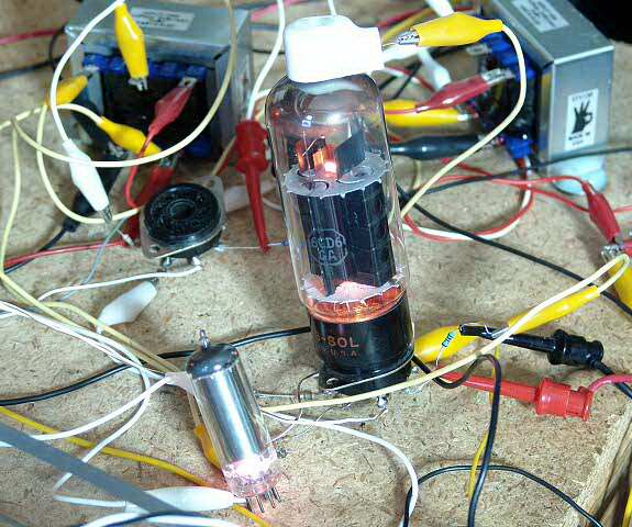

I have 6 6CD6GA's each one of them has a different internal construction. I have a Tung Sol that has a monstrous plate assembly that looks like they borrowed it from the 6550. I connected it up to the TubelabSE in place of the 6AV5. The whole thing is connected up to a variable power supply so that I could test at any voltage up to 400 volts. I used the same Edcor transformer so I could use the UL tap.
The short story is that the screen grid IS more sensitive than the one in the 6AV5. It does begin to glow at at voltages over 250 to 300 volts depending on the individual tube. The Tung Sol was the worst. Glow was visible at 250 volts. I tested triode, and UL up to 300 volts and 80 mA. The power at 5% distortion was similar to the 6AV5. I put the 6AV5 test results in the thread

Using a 4 ohm load on the 8 ohm transformer (2500 ohm load) caused increased distortion at any power level.
I got this idea that if I could run UL at a reduced screen voltage that this tube would rock, so I wired an 0A2 in series with the screen grid. Well this doesn't work too well in triode strapped mode because the plate voltage drops low enough to cause the 0A2 to go out, causing a whole screen full of distortion products (FFT analyzer). In UL mode this trick allowed 12.4 watts at 5% distortion with 400 volts on the plate (power supply maxed). I tried currents from 50 to 100 mA. 100mA is 40 watts, and the Tung Sol had no visible glow with the room lights off.
Due to the same effect described above (0A2 going out) the distortion comes up quickly when you hit this point. I had 12 watts at 2.5%, 12.4 watts at 5% but at 12.6 watts there is 12% distortion, really ugly distortion. A resistor from the screen to a negative supply could fix this.
I will try these tubes in my screen driven P-P test amp in the near future, but I need to find two that are the same. I have a bunch of Dumonts (Sylvanias) in the warehouse, I won't be over there until next weekend.

I have 6CD6GAs from GE, Sylvania, Cornell, Rad-Tel, and Raytheon. The plate structures are all about the same size. The Raytheon and Rad-Tel samples are interesting in that the plates have holes, so I could possibly see some interesting electron beam effects on the glass if I fired them up. I'm getting 10 NOS RCA units.
I am at work now, so I can't see the tubes, but:
There were two Tung Sol's one had the 6550 looking plate with round holes. The other had a smaller plate with square holes.
Two RCA's, older logo. These had smallish plates with rounded corners. Unlike any of the other tubes. The "guts" looked the same, but the getters were in different places. I did not try these since there are no holes in the plates.
One Dumont, made by Sylvania. I have about 20 more of these in the warehouse. NOS. The guts look like the Sylvania 6AV5 only about 3/8 inch taller. This one had no problem at 300 volts. Large square holes in the plates.
There are a few others that I didn't test.
If there are holes in the plates, watch the screen grid wires carefully. If you have things set up so that voltage and (or) current are adjustable, you can turn up the screen voltage and see the grid wires begin to glow. Try this on a crummy tube so you know what to look for. Usually there will be one or two wires near the top or bottom of the grid structure that begin to glow first. Sometimes they will be quite bright while the other wires are not even glowing. Operation with even one wire glowing will lead to short unhappy tube life. If you are thinking of operating a tube above the screen grid ratings, find one with holes and check it out.
