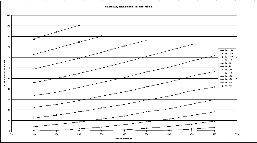

I'm setting up to run some curves for a few 6CD6GAs in screen drive mode with the control grid grounded. I'll post curves when I get them. I got the test jig set up this afternoon with filament supply - now I need to throw together a variable HV supply that won't kill me.

I ran points tonight using a 6CD6GA for plate voltages from 100V to 400V, and screen voltages from -50V to 0V, control grid grounded. I haven't had time to plot points, but I have concluded looking at the data I have so far is that this tube will need to have the screen driven positive to get significant plate current at lower plate voltages, and so will need a low impedance driver. I ran the test tonight using a used GE sample - I'll try later using one of my NOS tubes to make sure I didn't have a weak sample.

I plotted the information I had last night, and it looks like the 6CD6 is more or less cut off at -20V all the way up to 400V. Next step will be to add a source follower with dual supplies so I can swing both negative and positive and source significant current without droop, and repeat my measurements up to 500V (max output for my plate supply). I'm also monitoring screen current, and will post plots of that as well when the time comes. At present, with only negative to 0 volts on the screen, the current is not significant - I expect that to change when I swing positive. At any rate, what this tells me is that I will need a negative supply for my cathode follower driver if I expect to direct couple it to the 6CD6.
Strange to relate, what I've plotted so far looks very similar to the screen drive plots for the Svetlana EL509 clone. Maybe not so strange at that....

Some observations about the curves in the previous post:
1) The plate resistance is pretty high (about 10-11k), so feedback will be necessary to lower the output impedance.
2) the curves look similar to those posted by Svetlana for the enhanced triode connection of their EL509, but appear more linear.
3) I expect a screen driven 807 or 1625 to look similar - more on that later.
4) Within the range of drive voltages shown in the curves, screen current is pretty small (< 1 mA), so I should have no probem driving the 6CD6GA screen with something like the huskier triode half of the 6CY7 in cathode follower mode.
At this point, I'm planning to use 400V plate voltage and to bias the tubes at 40-50ma. Interestingly enough, the Sylvania manual deccribes the 20W dissipation rating for the 6CD6GA as a "design center" rating rather than an absolute maximum rating. It'll be interesting to see how long the tubes last when biased at 20W continuous dissipation.

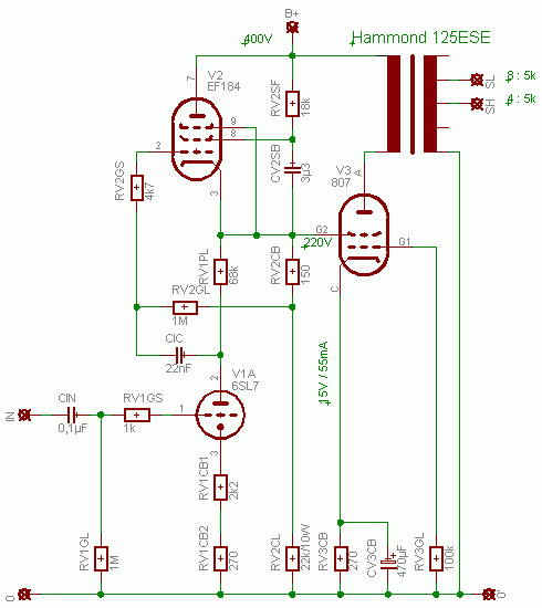

I've pretty much figured out how to drive my 6CD6GAs. I'll post a circuit for critique as soon as I get my circuit editing program running again. In short, I''ll be using a 6CY7 vertical oscillator/amplifier tube in the front end, with the small high-gain half as a common cathode amp for gain, and the beefier low gain half as a cathode follower to drive the screen. The cathode follower and screen will be direct coupled, and I'll set bias in the 6CD6 output tube by adjusting the bias on the cathode follower grid. It looks like I'l be using somewhere around +10V screen bias for the output tube if the sample I investigated was anywhere near representative.

Schematic is alomost ready for the circuitry to drive the 6CD6GA. I have to manufacture my own pentode symbol for Orcad, which is a bit of a pain...
