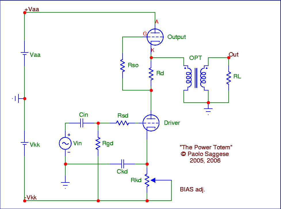

Quite a while ago I was trying to design a new SET amplifier around a couple of 6C33Cs I've got from a Russian friend. I was wandering about a cathode follower output stage, and was facing the problem of designing a proper driver without resorting to an (expensive & bulky) interstage transformer... but eventually I ended up with another, rather "strange" idea.
It was not a cathode follower proper anymore. But it was something new (at least, I've never seen it done before by anyone) and I have been quite curious to try it out.
You can see it sketched in the attached picture. Without any value and component information, at a first glance it may look a lot like something well known, namely the SRPP or "Totem Pole" circuit ( hence the "fancy" name I've given to it ).
But indeed it is NOT an SRPP. It may still be called a "Totem Pole", but it's not one of the usual kind. While topologically it is the same, here the two tubes are completely different from each other, as are their currents.
The "lower" tube is actually just a driver, directly coupled to the output tube by means of the "totem pole" connection.
Most of the current of the output tube goes down the OPT while only a small fraction of it goes down through the driver. The resistor in the middle is high enough to provide by itself a decent load for the driver, which is thus somewhat "shielded" from load variations.
I have run some simulations and found that -while obviously having both advantages and drawbacks-, it could indeed be quite interesting.
Thus I went on and built a prototype using the 6C33 as power tube. In spite of the "random" (mostly cheap) components used and the test construction, listening room "test" results have been rather good since the very first prototype. Currently I'm still experimenting with various drivers, trying to find the best match.
I have also run a lot more simulations, with various drivers and output tubes, and have found some rather interesting "pairs". One is PCL82/6BM8 as pre+driver and EL34 as power output. More on this later.
One of the interesting thing about this circuit is that it can be used as an alternative way for implementing the "Complementary Inverse Distortion Cancellation" suggested by John Broskie on www.tubecad.com
(for that, you should use the same kind of tubes for both the driver and the output, with more than one tube in parallel for output, taking care to carefully match voltage and currents on output and driver tubes... it's kind of a mess, but can be done).
Needless to say, small & cheap tubes such as 6BQ5 / EL84 or the Russian 6C19 (low rp!) should be best for this use.
The nice thing about using the "PowerTotem" rather the the original configuration proposed on TCJ is that you are not completely wasting the current from the driver. And It also imply that you are subtracting a substantial fraction of DC current from the OPT, which will surely make it happier. (a drawback - but someone may say it's rather an advantage - is that you loose the 100% local NFB of the true follower output stage).

Hi Paolo,
call it as you like, but you will have most serious problems to get any substantial output power out of it. The current bypass through the OPT is nothing else than a CF loaded inductively, thus the same restrictions for drive requirements do apply. I wonder how you will get the needed drive voltage swing. Efficiency must be extremely bad.
Would be nice you could supply some real world measurements.

Well, AFAIK "SRPP" stands for "Shunt Reguated Push-Pull", thus implying ~ symmetric push-pull operation of the two tubes. In this case, obviously there is no relevant push-pull operation to speak of. IMHO a "totem pole" can be called SRPP only if it is operating as such. That is, it must be symmetric and loaded by the proper (and constant) load impedance to allow for "push-pul" operation. Otherwise it's still a "totem pole", but if it's not behaving as an SRPP -> it's not SRPP. Again, IMHO.
In my circuit the "upper" (output) tube is working (more or less) as a CF loaded by the OPT, while the "lower" (driver) tube is working as a grounded cathode stage... the "trick" being using the output stage as (sort of) an active load for its own driver.
At least, this is how I have interpreted it. Please correct me if I'm wrong!

Hi Tom,
Indeed. Of course I get the voltage from the dual supply, with a relatively high negative rail... in the current prototype I have Vaa ~= 200V and Vkk ~= -300V (due to the Va max of the tubes I'm currently trying; with the previous driver with the PCL82 I was using Vkk ~= -380V).
BTW, I must say that having a small distorsion on the driver is NOT desired! This is because the distorsion from the driver can be conveniently used to reduce the overall distorsion on the output.
The real problem is finding the "right" tube, i.e. the one that fit best to give the best overall performances. I've tryed (most in simulations, some on the prototype) countless different tubes and operating points... a very few fits nicely, and I'm still seeking for the "right" one.
(more on this as soon as I'll post the complete schematic (and results) for the current prototype).

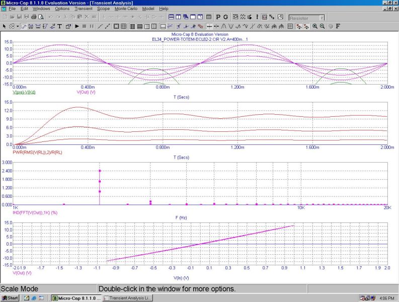

Quite the contrary. Currently I'm getting around 12W at ~ 3% THD and still a relatively nice spectrum (harmonic decay). I get this with ony 40W of dissipation (~200mA @ ~200V) on 6C33 plate (real measurements on the prototype).
BTW I'm still looking for a "better" (best suited) driver... I do belive that it is possible to do even better!
And /in simulations/ I got 10W out of a triode-strapped EL34 driven by a (triode-strapped) PCL82, which seems to be a nice fit for that... I'll post this too... but again next week, I don't have them here now.

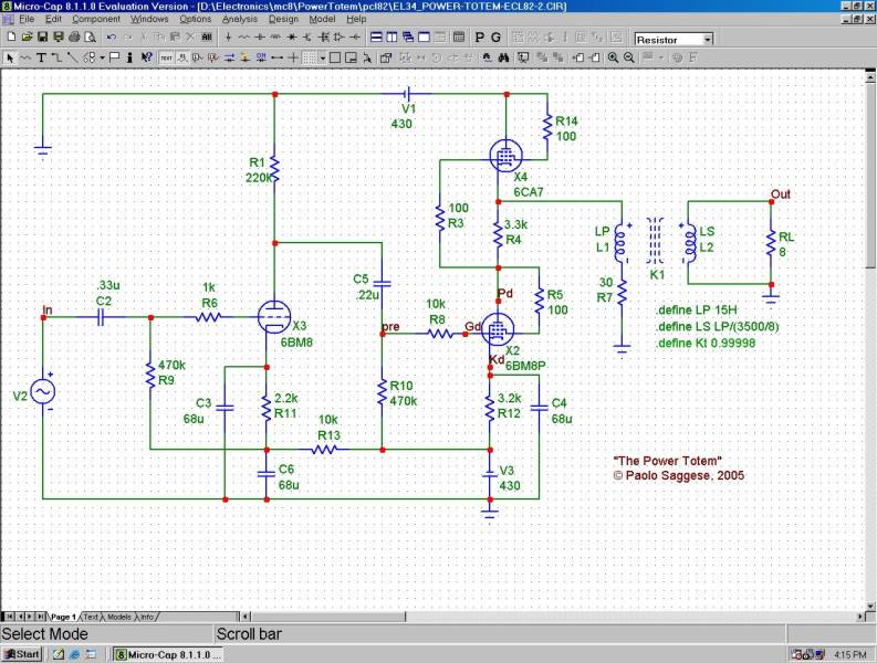

EL34/PCL82 PowerTotem schematic diagram...
OK, let' start with the EL34/PCL82. This one can be a very simple, dirty cheap yet (I guess - no, I bet!) well sounding integrated amplifier.
Here follows the schematic diagram for the audio circuit.
I have not (yet) designed a PSU for it... but nothing very special is required. The negative rail (used by the input and driver stage) has a rather small current draw (<15mA each channel), thus an RCRC filter with sand bridge rectifier will be good enough. If you don't bother wasting some 10Watts, a CRC can be used also for the power stage (otherwise, use a CLC... remember: it's a SET, has a poor PSRR, thus you need GOOD PS filtering!). You can use the same secondary of the PT for both rails, doubling only the rectifiers ( and filters, of course ).
Heaters can be conveniently powered by AC. No matter whether you're using PCL82 (15V) or ECL82 (6.3V), you need 2 separate windings (or PTs) for the two tubes, since the driver tube heater MUST be lifted from ground down to the negative supply rail; keep the heaters some 10V more positive (less negative in this case... ) than the cathode to minimize hum and noise... but I guess I don't need to tell you these common tricks...
Needless to say, you can also try something like a 6550, KT88, etc. in place of the EL34... but be sure to optimize the circuit (and OPT) for the tube you plan to use...
'cause IME the main drawback of this circuit arrangement is probably that it can be quite picky about tubes, voltages, operating points, etc.
