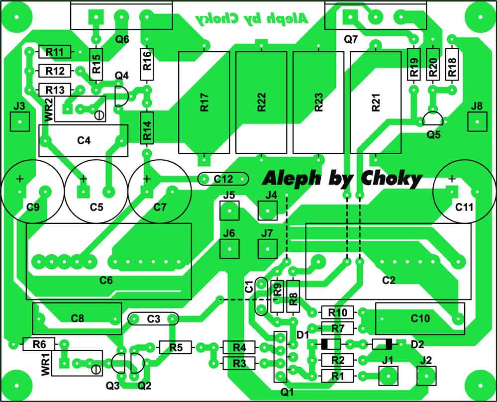

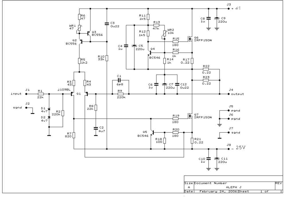

if you want DC gekoppelt feedback network-use C2
if not-use jumper
R6-preliminary value (shoot for 10mA through LTP)
best way is to preset 10mA during PCB assembling-without JFETS in PCB ,or just dial WR1 to have ~ 60 to 70 OHMS in WR1+R6; fine tune to 10mA after
WR2 is for fine tuning of Iq (2A)
C1 (as Papa sez) probably isn't needed at all....CRO will tell...
R14 (AC current gain ) as you wish........1K or more ,or even switch 😉 if you don't need Aleph CCS
R18- (current protection) -still didn't bother with calculating value.....with my spks-maybe I'll omit that resistor 😉 ....I'll calc value in few days-when Oly make few PCBs ,and when I start to make final version....and when I return from short trip .......
everything other-same as every other bastardized Aleph......WR1 is,besides setting 10mA through LTP,also for setting DC null on output,,,so-preset at 10mA,after full warm-up,just shoot for 0 mV on output
in my experience with Babbelfish J veeeeeery 3-dimensional prototype,messing with WR2 have some influence on offset,but-as always with Pass's bastardzzzz-we are used to some tweaking....hehe
cheers for now

This babbelfish seems to have nothing related to the Pass Jfet but to the Aleph more maybe to the J Aleph, guess it’s a good approximation, like it very much Choky, excellent work you’ve made along with your friend Oli to say the least.😎 😎 😎
What’s the horsepower on this one?
Beautiful board layout. That is a masterpiece, Choky. Give your friend Oly, my compliments. Very, very nice layout😎

steenoe said:Beautiful board layout. That is a masterpiece, Choky. Give your friend Oly, my compliments. Very, very nice layout😎
Yep, this amp is a jewell I think, in fact I think its the crown jewel sparkling over the whole Aleph range of amp's😉
Are you aware that its a bit dangerous to give me a nice PDF like that😀
Steen🙂
I told ya that Oly is a king with Protel
btw,there is one slight mistake with elco in minus rail....on schm
it's OK on PCB
just make it and enjoy..............

Anybody know how close this design is to the Aleph J?

Skorpio said:Anybody know how close this design is to the Aleph J?
-JFETs in input stage (type)
-Feedback to drain of input stage (why?)
-Source resistors
-Input CCS, no zeners...
-Feedback resistors and input impedance
Could this easy be implemented on a running Aleph 3?
search .........
anyway:
-NP sez that he use 2SJ109 in input stage
-sorta folded cascode,at least how little choky means how FC looks 😉
-source resistors-why not? better stability,I think....
-input CCS not like usual NP CCS-again who cares....this one looks better,even if usual NP CCS is certainly more than good enough
-feedback resistors and input impedance-just because NP sez few things in Aleph J user manual.......~240K input and ~20db overall gain.......
-more than easy-it's Aleph 3 with wimpier input stage,nothing more ..........and nothing less........
and-yes-you must ask Papa directly -how close is Babbelfish J to real Aleph J.......
