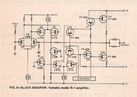

The VFET is a depletion device and is normally ON, it is essentially a power JFET.
If it indeed is dead, the only way to get a replacement is out of another B-1 amp. This transistor is completely unique.
Because it operates in exactly the oposite way. Practically all MOSFETs used in amps are enhancement mode, i.e. they need a control signal to turn them ON. VFETs are depletion mode (like JFETs, and tubes) and need a signal to turn them OFF. Replacing a VFET with a MOSFET (unless it was a depeltion mode MOSFET, but these are rare and currently not made for the required voltages and currents) would require a different amp topology, so essentially, you would get a different amp. You could hardly call that a replacement, more a redesign.

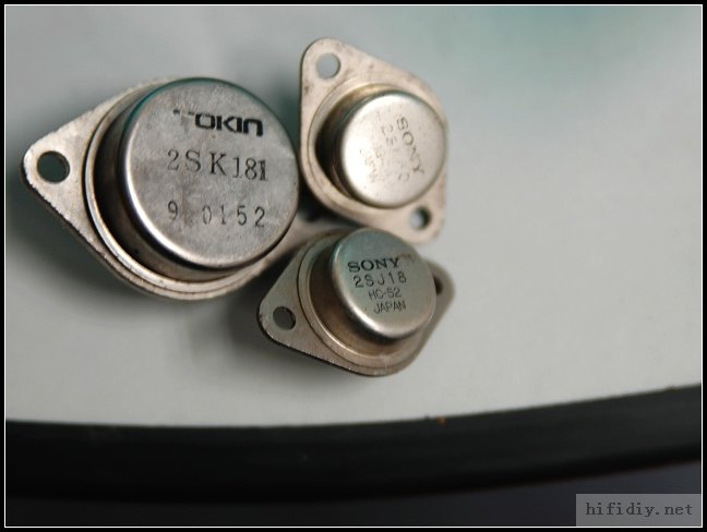

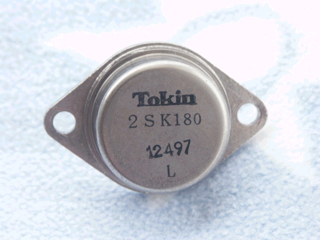

Vfet are rare today, but 2SK77 is unique, bigger, and very very rare Vfet.
You can try to substitute it only with the TOKIN/NEC 2SK180 I think, but this last is also very rare.

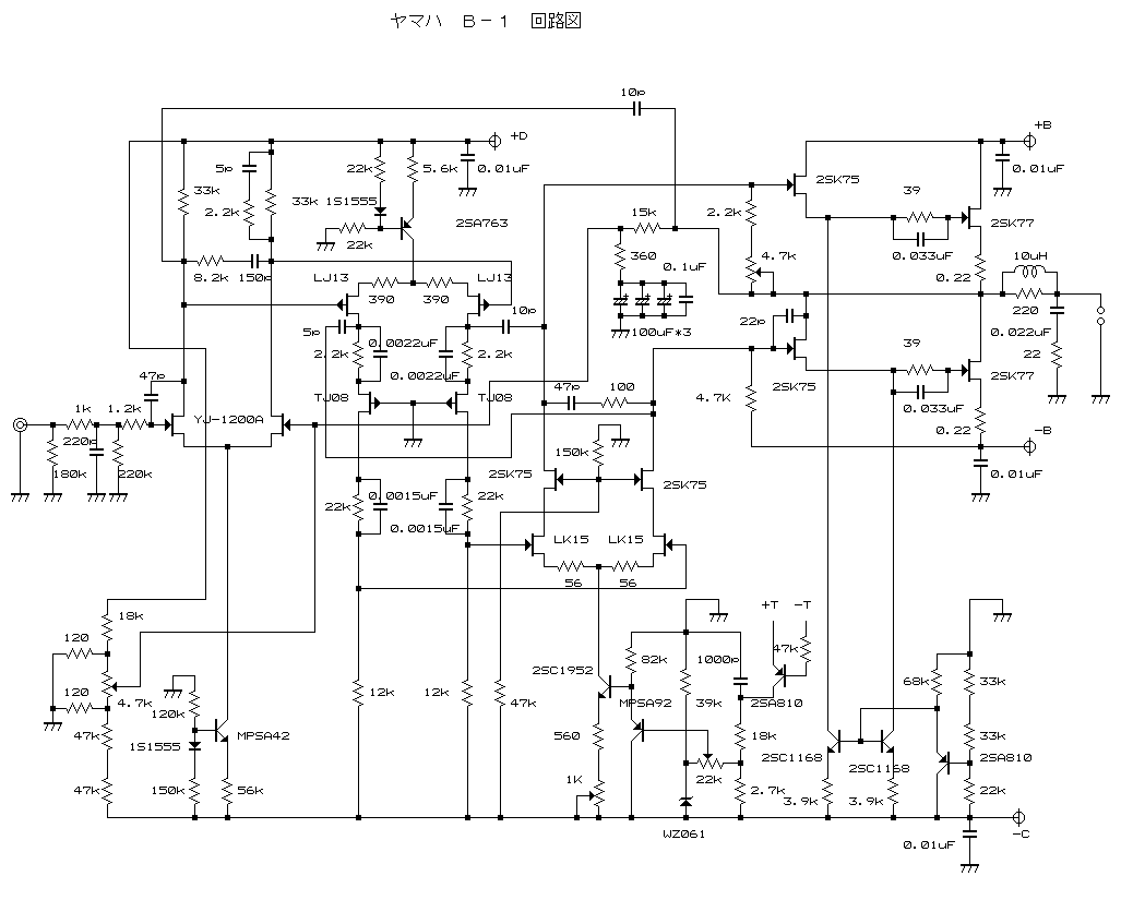

YAMAHA B1 schematic from my site 😀: http://www.amplimos.it/images/Yamaha%20B1.jpg
Francesco
