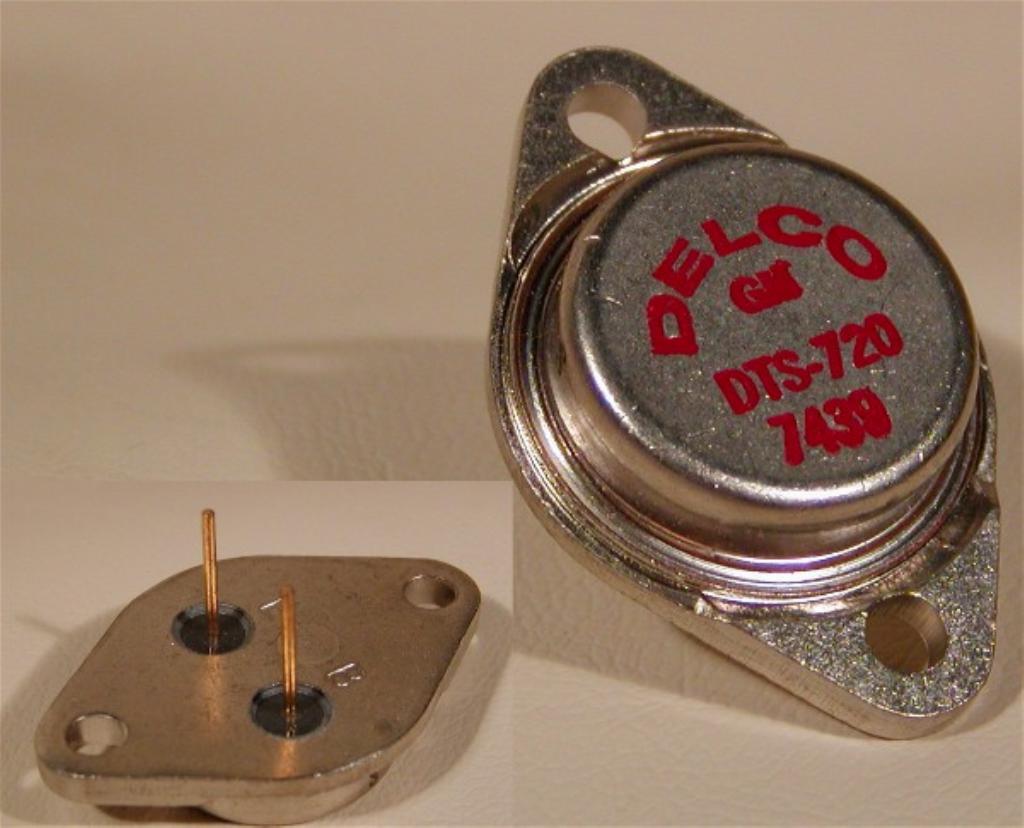

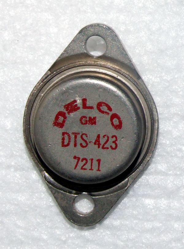

Yamaha 2SK77 outline like DELCO-GM DTS-720:
It seems, that some vintage transistors from DELCO-GM uses the same outline than the Yamaha V-FET 2SK77 - have a look to post #29 about
http://www.diyaudio.com/forums/parts/167680-vintage-transistors-3.html
and the attached jpg file.
The transistors from DELCO are BjT's and no V-FET's, but if the outline was the same, and the CE voltage is enough, I would use it after the appropriate circuit modifications.
Who knows, where I get data books from Delco (Radio Delco Semiconductors) ??

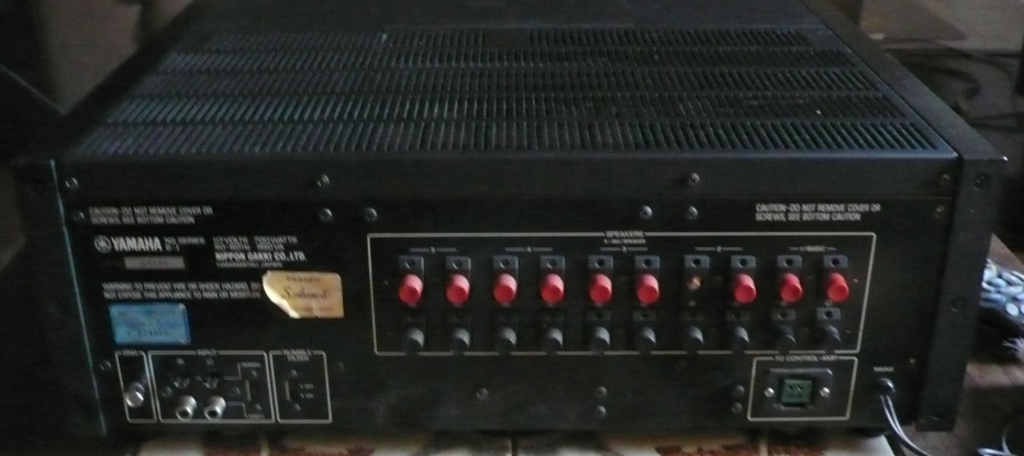

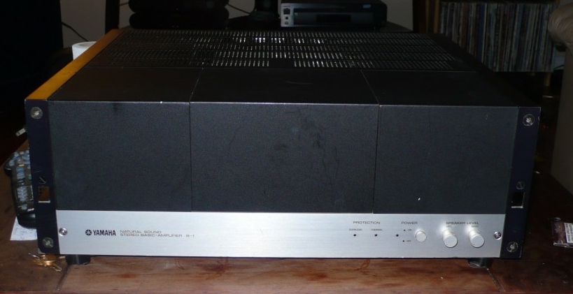

Yes indeed. It truly is a labour of love but well worth it. I got one of these a few months back and lovingly DIY'ed it back up to spec and now it's repaying me with its sweet sonics. I got it for a third the price they usually sell for because it was in pretty rough shape. It spend most of its life as a bar amp and when I got it it wasn't very far away from becoming a boat anchor which would have been a damn shame since the B-1 is such a fine piece of sonic work and very unique. Luckily it found its way to me and I was more than happy to give it the TLC it deserved.
Here are a couple of pictures the seller posted before I got it:
attachment.php
attachment.php
