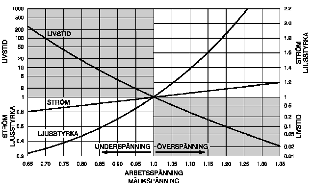

70% nom voltage = 100 times longer life
LJUSSTYRKA= strenght of light
ARBETSSPÄNNING= work voltage
MÄRKSPÄNNING= mark voltage (nominal)
STRÖM= current
the picture is from www.elfa.com pages with facts
It is on how the lifespan in ordinary lightbulbs correlates to working voltage
LIVSTID= lifespanNelson Pass said:I haven't had any problems, but then I have run them
very much below their ratings.
STRÖM= current
