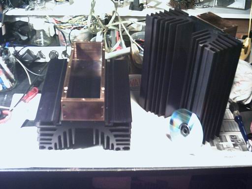

ps.I just begun to have a cuppercage around the mosfets on the heatsinks...see attachm.
