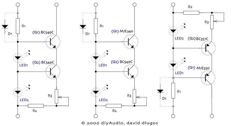

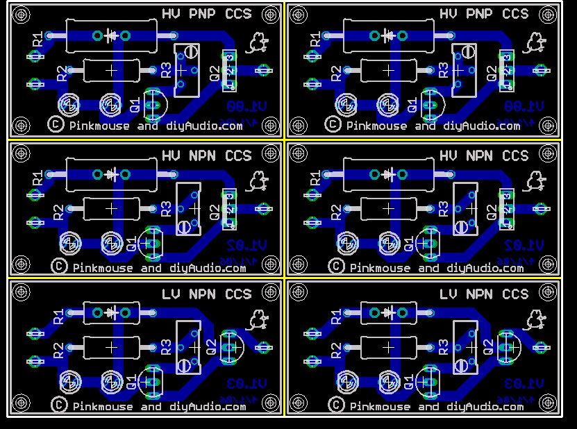

Since there's been a lot of interest lately in constant-current sources/sinks for use in tube amps and preamps, a few of us have been working behind the scenes to design a set of boards suitable for a wide variety of uses. The format will be a break-apart set of six circuits, both NPN and PNP. The design is a cascode bipolar, similar to the circuits shown in Morgan Jones's "Valve Amplifiers" and discussed at length in several recent threads.
The hard work has been done by our own Pinkmouse. Mr. Jones was kind enough to make some suggestions. And I'm the poor shmoo who has actually laid out the money to get them made.😉
We'll be announcing the prices and availability shortly. The boards are scheduled to arrive here in mid-February.

planet10 said:maps
Those aren't the classic M. Jones circuit. One resistor morphed into an LED. 😕
Mr. Jones didn't object.😉
No-one will call the police if you stuff a resistor into that space instead of an LED.

what about the ckt posted on post 219 above.
This is exactly the same, other than the substitution of an LED for the dropping resistor in the other circuit. The current in the reference string is roughly constant, so the drop across that resistor is relatively constant- that's how the cascode is biased up. Given that, the substitution of a voltage reference is easy. At least around here, both red LEDs and resistors are pretty cheap, so there's no real cost advantage one way or the other.
If you like, you can stick a 1k resistor in that slot. Makes no/very little difference, other than 33% less light.
