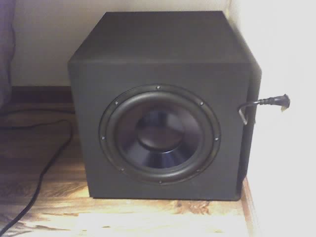

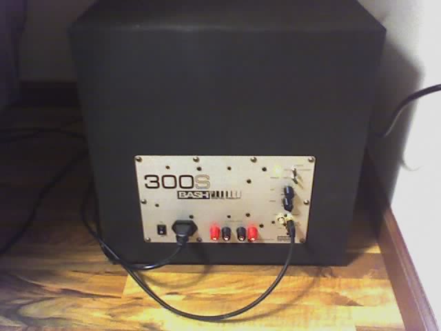

Well, I just finished hooking it up (figured priming the box without putting on a slick finish would be sufficient since it would be hidden most of the time), and I am quite impressed if I do say so myself.
I have not been able to run frequency sweeps due to my wife wanting to watch Charlie and the Chocolate Factory 🙂, but so far the sound sems pretty ballanced and definitely fills out my North Creek CM-77's well.
Final configuration was 2.1 cu. ft. box with +4db @ 22 Hz. I unfortunately don't have a mic. that is anywhere close to flat (that is definitely on my wish list, though!), so I can't post response curves in the room. I will, however, let you know qualitativetely what is going on when I get a chance.

I just completed a project with the BASH 300W amp and I really like it (different driver though). To enable me to easily adjust the boost I added a temporary bread board for the boost resistors and ran it outside of the enclosure during testing. This worked well but introduced a bit of hum that went away as soon as the final resistors were soldered to the amp's boards.
I used WinISD to model the system. In my listening room (23 ft. by 13 ft by 7 ft - in the basement) the bass gain fit a parametric EQ setting of 23 Hz, +3dB, with Q=0.65. I'm sure other rooms are quite different, but that may be a starting point to help you to determine how much EQ boost you will need in your design. With those figures WinISD was spot-on with the in-room response of the system. I was quite pleasantly surprised.

I have also been pleasantly surprised. WinISD seems to have hit the parameters spot on. The sub qualitatively has a pretty flat response from ~100 Hz to 30 Hz based on my ears not noticing any nasty peaks or dips in response while running sine wave sweeps. Below that, I start loosing hearing sensitivity, so I can’t make a good judgment as to intensity, though there is definitely usable response down to ~22 Hz which is where I can’t hear it any more, but the cone is still definitely cranking below that. Fortunately, there don’t seem to be any nasty room mode peaks and the rough room modeling seems to be spot on.
I must admit that I am not one to believe in vanishingly low ripple in frequency response curves. As long as I don’t notice peaks, they don’t exist to me! 😀 That being said, I can happily say that this sub is “Flat to Me.” (insert catch phrase trademark symbol here! 🙂 ). I was worried this would not be the case due to using the bass boost on the amp, but it seems to blend quite well. This was definitely easier than using a LT circuit.
