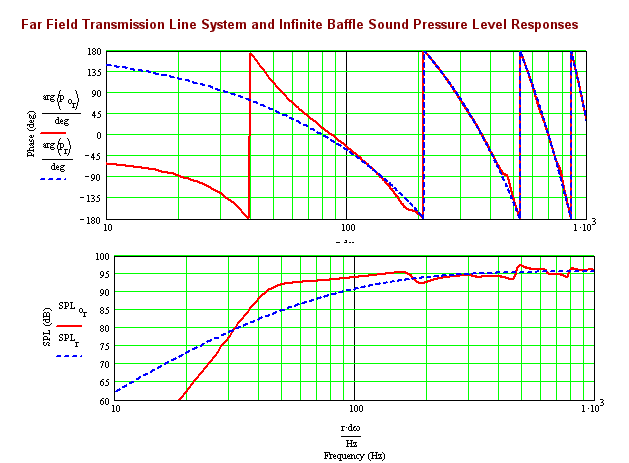

The Lowther Club of Norway 'Voigt Pipe' (Not that poor old P.G.A.H Voigt had anything to do with it). It's the entry for many people into the world of full-range DIY speaker-building -not sure why, probably because it looks dramatic and it's easy to construct.
Pity that, as it stands, it is, quite frankly, rotten. Below is the MathCad simulated response for this enclosure with the Fostex FE206E, which, rightly or wrongly, I suspect is the most popular driver that finds its way into these enclosures. (If you're interested, the response looks almost identical with the FE207E, FF225K, FE166E, FE167E and FF165K. With the Lowther PM6C drivers it was designed for, it looks even worse.)
But what if you've put a lot into your LCofN Voigt pipes, both in time and effort, and don't want to scrap them? Well, you're never going to have the best enclosure in the world I'm afraid. But I can suggest something that might help a bit: see next post.

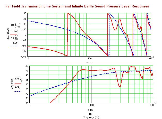

Still with me? OK, now if you ask anyone who is used to modelling quarter-wave enclosures with Martin's MathCad worksheets to pick one single thing they hate about the LCofN 'Voigt Pipe' above anything else, I would put money that it will be this:
They are an So=0 design. For those who haven't a clue what I'm on about at this point, So is the area of the top of the pipe. Now normally, when designing a Mass-Loaded TQWT enclosure, we say never use a top area less than the surface area of the drivers.
Thing is, in this case, that isn't the major problem. The drivers that frequently find their way into these things tend to be low Q designs. And they actually appear to be less affected than the higher Q drivers in this regard -in some ways, they seem to like the extra gain it provides. Gregreferred to this some time ago I believe?
What is a major issue is that although these things are mass-loaded (although I seriously doubt the thought even occured to the designer: he just set the vent area to the same surface area as the intended Lowther driver, or as close as he could get) -it's not enough.

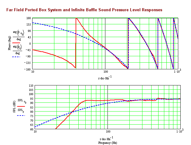

Here's the same enclosure, same driver, everything the same. But instead of the large vent, there's a 3" wide, by 3" long circular port, 4" up from the bottom. OK, it's not perfect by any stretch of the imagination, but it's a heck of a lot better than having big peaks and holes all over the place.
This works wonders for every driver I tried it out with. The lowest Q types need a bit of series resistance as you can see: I'd say 2ohms or so, to bring the response down, as it rises a bit. Ripple is mostly flattened, and on average, you suddenly get an extra 20Hz of bass. These assume 0.25lbs ft^3 of stuffing from the top to just below the driver by the way.
Oh yes -a BSC filter would be of use too, in-room. I'd try the one from Martin King's Project 2 MLTQWT which should do the job fine.
Hope some of this is of use. I figured I'd put it up here before I delted it all.

Konnichiwa,
I'd note a few things about the LCONVP.
1) LF extension is limited, but at high efficiency, basically that thing is 95db/W/m down to 70Hz, not bad.
2) The first really nasty mode is at 300Hz, where a simple counter resonator or even likely just the right kind of stuffing could limit the "big dip" and likely flatten out the feever curve higher up.
3) Given the kind of FR evidenced by the FE206 toeing these in strongly or pointing them straight on so that the listener is off axis would probably give a quite even tonal balance.
So, with a little luck in stuffing and listening off axis the LCONVP could make a surprisingly decent speaker..
For the modified design we see that efficiency is traded for bandwidth, by reducing the resonant behaviour of line, the result is a rather early but shallow LF rolloff, which despite having a lower -6db point (~40Hz) than the LCONVP (~55Hz) would likely sound rather strident and forward with lean tonality, unless the speakers midrange is pulled down by around 5db to bring it in line with the LF.
I suspect persnally I would probably prefer a reasonably sorted version of the original to the "fixed" one.....

You're welcome guys -hope it's of use to someone. Note: I do not recommend constructing this cabinet. If you wish to build a TQWT for your driver; do yourself a favour and design a decent one, from scratch, in Martin's MathCad worksheets. It will reap major rewards. This mass-loading is just a boot-strap, quick fix for people who've already constructed the wretched thing and discovered the frequency response is all over the shop, and bass is serverely lacking.
Kuei -You make some very fair points. I agree with you regarding the toe-in, or listening off-axis. This would likely mitigate against requring series resistance; though I'd still advise using 24AWG or 30AWG wire with a low-damping factor amplifier, and a resistor with a high damping-factor amp or eveything under 120Hz or so is going to vanish.
Good luck if you think you're going to sort out the massive response issues this cabinet has via stuffing however. No chance. Promise. Stuffing exists only to damp harmonics that cannot be otherwise engineered out of a cabinet. There is a 20db hole in the response and that's just the one at 285Hz or so: you won't loose that by shoving more stuffing into the pipe, and for the love of heaven don't believe the myth that all additional stuffing does is clobber the efficiency. It will start to absorb the Fundamental, which is the whole reason for using a QWR in the first place. The mid-Q drivers like the FE207E and FE167E don't have this rise. Me, I'd rather have a flatter response than 20db holes and savage comb-filtering.
Be aware that whatever you do, this cabinet needs baffle-step correction. Active or passive, take your pick. Without it, you're going to run into even more problems. Passive will need a 2mH inductor with 4ohm resistor, approximate (minimum) values.

Right, this is what I've come up with for the Coral Flat 6II.
First up, I'll say I've had to fudge some of the data as I can't find the full T/S parameters. However, the most important: Vas, Qe/m/t are a start. I calculated the Bl factor using Martin's check-sheet as 9.771; the rest aren't quite so important, so we should be at the very least in the ball-park here.
Enclosure is 42" tall, 9" wide, 10" deep (internal). The driver is set 11.25" from the internal top, the port is 4" x 2" (WxD) and set 3" from the internal base on the front baffle.
2ohms of series resistance were applied: you can do away with that if you can cope with the slightly rising response or your room is bass-heavy. Just use a run of high-resistance wire: a single pair of 24AWG extracted from a length of Cat5 would be ideal, or a run of 24AWG magnet wire.
0.35lbs ft^3 of stuffing. Stuff from the top down to just below the driver. Predicted frequency response is shown below.
They'll need a BSC circuit, like most enclosures do. Try a 2mH inductor with a 4-8ohm resistor.
All dimensions were made in the latest (as yet unreleased) version of Martin King's Ported Box worksheet. You can do the same with the existing sheet, though adding the series resistance is a bit trickier. This isn't actually a reflex enclosure, but an MLTL. I don't think these drivers will work too well in an ML TQWT, I'm afraid.

Scottmoose said:Right, this is what I've come up with for the Coral Flat 6II.
2ohms of series resistance were applied......
Greets!
Well, I don't have the same PORTED WS, but FWIW, using these specs in your pipe I get a very rolled off response below ~100 Hz:
Fs = 68 Hz
Re = 8 ohms
Lvc = 0
BL = 9.46 NA (calc'd)
Sd = 214.0834 cm^2 (6.5" nom.)
Rs = 2 ohms
Vas = 31.346 L
Qed = 0.433
Qmd = 5.671
Qtd = 0.494 (auto calc includes Rs)
To get something with as much LF gain as yours I had to use a large, fast taper ML-TQWT:
L = 72"
zdriver = 36"
zport = 69"
SO = 9"^2
SL = 180"^2
rp = 2.75"
Lp = 0.75"
GM
Well, I'm blowed if I can figure that one out Greg! Thanks for the warning. I've just plugged the specs back into the sheet, this time using the ones you calculated and posted above as you've more experience at figuring out T/S parameters from older drivers than me. But the predicted response has come out practically the same, with only minor changes due to the slightly different driver parameters entered. So I've honestly no idea what's going on there. Do you have a set of response curves you could post? Perhaps we could then send them off to Martin for comparison: as I'm using the new sheet this might indicate there's a bug in there somewhere. I'll have a go in one of his existing sheets and see what happens in that too. Very odd. I'll get back in a few minutes. Oh yes -I had a look at your ML TQWT too; looks good to me! I tend to get hung up on only going to a 2" radius maximum for the port, which is obviously limiting the options a bit! Something I need to be more careful about doing as it clearly rules some possibilities out, many thanks as usual.
Best
Scott
Best
Scott
Very interesting indeed. They don't match. Rather than using the current Ported Box sheet, I tried it in the ML TQWT sheet. This is what it suggests for the Coral driver (GM's calculated parameters) and the MLTL enclosure without any series resistance.
Doesn't look so good here. But it doesn't look too bad either -I've seen a whole lot worse, and as a theoretical exercise, there doesn't appear to be much that couldn't be sorted by juggling some port dimensions and adding the 2ohms series reistance we both went for to get it flat. Strange -any thoughts?
Best
Scott
