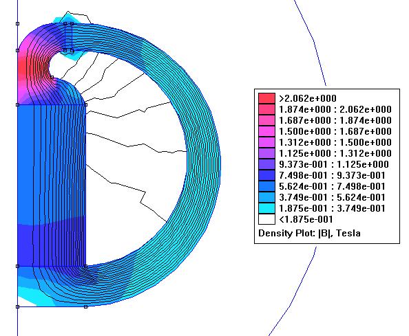

Interesting drivers--pretty.
However, just looking at the magnetic circuit, I can say without a doubt that there is a serious bottleneck in the pole piece. I'll see if I can do an FEA and put some numbers to it.
Bill
Ok, here it is:
I specified an alnico magnet capped with shaped permendur (giving some benefit of the doubt, since I didn't see permendur specified in the writeup). The rest of the yoke is pure iron.
As you can see, there is indeed a flux bottleneck in the permendur below the gap, where flux density surpasses 2T, which is nearing the limit of permendur. If the pole cap is not permendur, this restriction would be quite a bit more serious. As it is, I wonder about the wisdom of encouraging saturation anywhere other than the gap faces, though such is all to common in motor design, usually because of penny pinching.
Bill

BTW,
Can you (or anyone) recommend a suitable finite element analysis package (I assume 3D modeling would be called for) that would be affordable for a very small outfit and could run on a desktop computer of reasonable power? And it would be nice to get an idea of the learning curve that goes into using such a tool . . .
I use FEMM, a free and easy-to-use magnetic FEA application that is slim, free, and easy to learn. I highly recommend it. It can handle planar (2d) and axisymmetric problems.
Bill
Thanks very much, Bill. I will pass this on to the manufacturer. This particular driver does not use Permendur. However, their actual measurements of gap flux density are higher than what the diagram suggests . . . it makes me wonder about how accurately their drawings represent the actual internal construction of the driver. (I note, for example, that their drawings do not indicate a shorting ring, even though I know they use them.)

I was wondering about this, too.
Unless its gap faces are always saturated (practically impossible with healthy LF signals in the VC) there is a certain amount of field reversal and iron modulation in all dynamic bass and wide-band drivers. This flavors the sound to varying degrees, perhaps even in a pleasing manner in some cases.
Faraday rings can help with iron modulation only in the mid/treble and up as they couple with the VC field less and less efficiently as frequency drops. I can think of only three real ways manufacturers are currently combating LF iron modulation. In decending order of effectiveness: ATC's SLMM, 18Sound's AIC, and JBL's Differential Drive.
In the case of this Feastrex driver, at least the flux bottleneck is high up the pole, quite near the gap, which I imagine would allow less iron modulation than if it were at the base of the pole, as in so many other drivers.
Also, by reducing flux in the gap, it probably allows a higher Qts and therefore more bass.
Anyway, none of this is to say that this Feastrex doesn't sound great. I just raise the question about the flux bottleneck because it goes against conventional wisdom, and I'm quite sure it wasn't a cost-saving maneuver in this case! 🙂
Bill

Nice work there, but I wouldn't be sure the illustration you based the sim on is anything more than just to give a visual of the concept.
Firstly the specs state 1.8T in the gap vs the simulated 0.5-0.7T. Also for something where cost is not a huge constraint (I assume) they would have missed some simple angles in the motor design that would achieve more symmetrical fields too.
Also the sim. design is cut through the centre which could be a reason for the magnitude of the bottleneck. What if you draw the other half slice of the motor, hence full thickness pole piece as in the mfg. dia.
You believe everything a manufacturer tells you? I don't. I wonder how they determined they had 1.8T in the gap.
My guess is, and Bill can confirm, that the model is axisymmetric in which case the math accounts for the part not shown on the other sied of the centerline axis. Looks like a very nice program, I used to use ANSYS for magnetic field calculations when I was working for an MRI S/C magnet manufacturer.
You believe everything a simulation tells you?
If I know the basis for the simulation, and have confidence in the analyst doing the simulation, then I have a good feeling for what accuracy and inaccuracy is present in the results. No simulation is perfect, the best simulations are only good enough to give an accurate result for a specific set of questions.
Do I believe a glossy marketing data sheet with one very detailed result but no T/S parameters (which are kind of fundamental properties)? To be polite, I will only say I am skeptical and would not spend the money on the drivers yet without more trustworthy information. I would spend the money on AER or Lowther drivers first with much more confidence.

Hi Vikash,
I agree that we shouldn't make too much of an illustration that may not reflect the full reality of the actual motor. Whatever the actual proportions, though, if the pole is drastically undercut (as they seem to illustrate) and there isn't significant tapering toward the gap, then there must necessarily be a flux bottleneck below the gap. Also, as Christopher mentioned, the pole cap is not in fact permendur. I can't see how they could achieve anywhere near 1.8T in the gap under these conditions.
Again, though, let me say that I still admire the drivers as audio objects d'art, whether or not they rigidly conform to spec, and I'd love to see more boutique manufacturers crop up. Actually, I'll likely join a new ultra-high-end effort later this year... (and we'll always supply lots of accurate specs and measurements). 🙂
Correct, Martin. 😎
