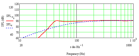

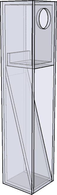

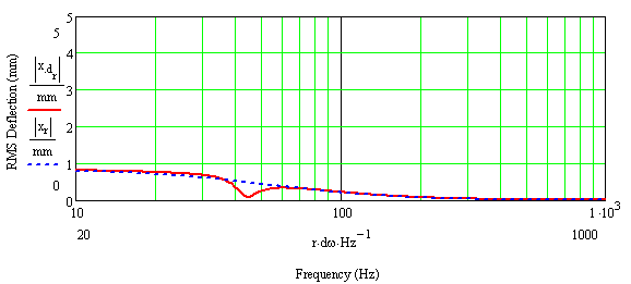

OK here's one idea for the D9nf based on the specs. you gave above. I'm increasingly a believer in the KISS approach, given that I've need numerous complicated cabinets give no better (frequently worse) results than something stupidly simple.
Like this Shadow style box.
Cabinet is 260mm wide x 300mm deep. Upper chamber is 450mm tall (for 35 litres) driver mounted 150mm down from the internal top. Downward firing slot 18mm deep at the rear of the bottom panel, full width of the cabinet, 18mm long (thickness of the build material), feeding a rapidly flared vent 381mm tall at the front. Strike-plate starts 25mm down from the slot. Similar layout to the attached, though the slot doesn't need the extra panel, as it's only the length of the material-thickness, & the flare won't look as skinny.

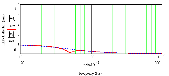

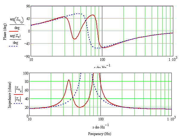

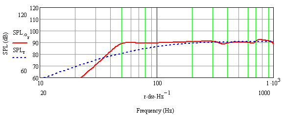

The doubled box is tuned ~10Hz lower as shown above. As you can see, excursion is no higher than for the single version.
I normally try not to overload threads up with multiple posts of graphs but I wanted to make an exception in this case for several reasons. a) because they're unusual drivers clearly showing a lot of personal effort / artistry involved in their design, and b) as my quiet response to some remarks elsewhere.
I'll look into the smaller unit next. I'd love to do something for the Alnico & field-coil units too at some point. :nod:
