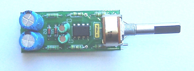

Requiring a quality buffer and volume control between a CD player and power amplifier, and having a small amount of otherwise waste space when panellising my current run of PCBs,
I decided to do a small board for a volume control and OPA2134 dual FET cascode chip to run from an external +/- DC supply of up to +/- 25V with onboard zener reduction and secondary filtering. Once again fully ground planed top layer with through hole plate and teflon solder mask/component overlay.
Unpretentious but fully functional.
Greg

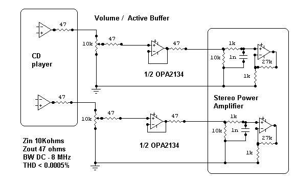

I, and others, have a primary or maybe single source, say a CD or DVD player that they wish, as I do, to keep a simple signal path. The CD won't like loading lower than about 10K and the power amplifiers don't want more than 100R source impedances or their HF rolloff comes early. The output of the CD player is too high to run directly and very few have a volume control built in (or remote) so this simple cct provides a 10K or 25K (pot value) load to the CD player while buffering it and providing a 47R output Z to drive the power amps. It's stereo and only puts one op amp in the signal path so is minimalist. The PS can even be configured to split a DC walwart supply.
There's not too much a unity gain OPA puts in the way of the music.
You have a passive alternative?
Greg

Conside a CD player
Z out 100R ; Vout max 2V ; load needs >10K
Power amp input
Z in > 10K ; Vin max (say) 2V ; source Z needed << 1K to not upset input HF filter.
So your passive divider could be 9K series 1K ( 10% of the way on a 10K pot) and I would halve the HF response and get 10% of the voltage signal so max 1/100 of the power.
Turn it up, I can't hear it! But you can't, as loading will get worse and HF will get worse. Your zip article refers to both having equal output and drive needs but that's not reality. It means they both clip at the same level.
You just can't load the CD with 10K min and provide the power amp with volume control ( to more than 10%) with < 1K source Z.
That's the nub of the need.

Anyway, the OPA2134 will not sound at it's best with that PSU bypass layout.
Move the cap for the positive voltage to pin 8 (direct between pin 8 and ground, no long / inductive tracks, please).
The 'idea' is fine, and you could even have made provision for feedback resistors, if gain is needed.
I don't understand your worries about HF preformance though, as you have a 1k series resistor on the input of your power amp, with 1nF to ground (~159Khz lowpass).
That 1k resistor will add to the series output impedance of a volume pot, and you were worried about the pot. :confused:
The pot will not drive very well the 10k input impedance of your amp, if that's what you mean.

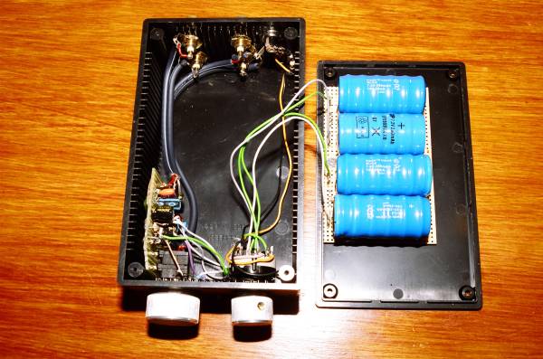

Small battery powered preamp.
