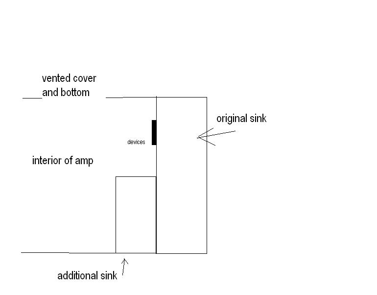

If those fins are really ~3 inches deep I'm inclined to think that they will work fine. As a contigency plan you could always bolt additional sinks on the inside of there is room. I 'think' I have seen Nelson do that on his new firstwatt chassis' too....could be mistaken though.

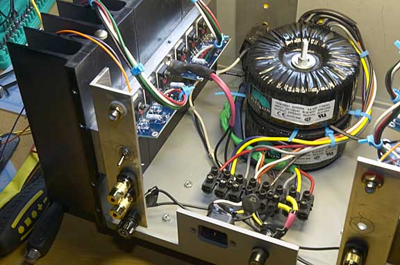

I am done with with my Aleph 30. Acctually it is crossover between Aleph 30 and Aleph 5. My rail voltage is 30V which falls right between Aleph 30 and Aleph 5. Since it is housed in Stasis case I call it Staleph 305.

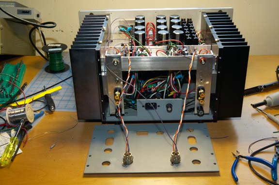

Stasis was simply bult on block of 1/2 inch aluminum, with another aluminum block over it that holds all electronics and connectors, as well as holds heat sinks. I kept everything intact by removing that block and replaced it with another 1/2 inch aluminum block. Than I installed my output stages on that. I replaced original PS with my Piltron transformers two 400VA; 2x22V each.

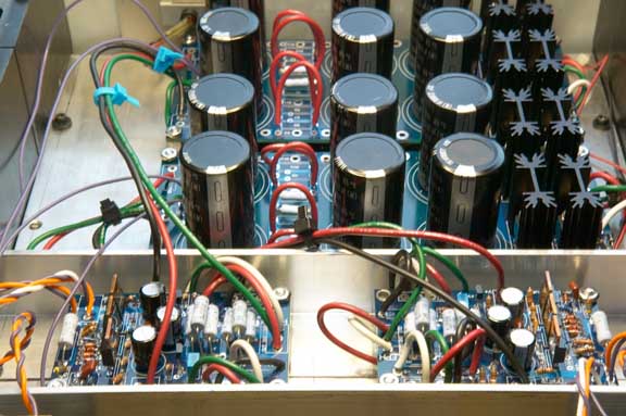

Boards are Mini Aleph originaly designed by GRollins and made by Brian GT, parts are from JLeaman, and mosfets from Anthony - Colomb 🙂mad: ), and Aleph and Stasis are designed by Mr. Nelson Pass. Thank you all - this is real collaborative project.
Here are PS boards - all together 12 x 22,000 uF - or 264,000 uF.

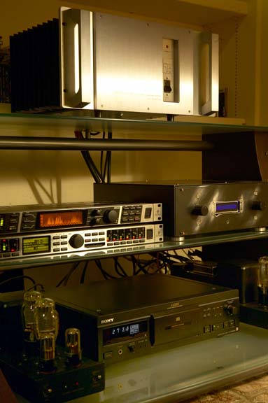

So I decided to put Aleph in its case and to have it as a part of my maine system. I really like the look of theat case, and it really seats nice in my system. I was very gentle in doing it so I could put it back if I want to. I even kept wiring together. By making a new 1/2 inch aluminum block for Aleph, it would take me no more than 10 minuts to put it back in the same shape. That original aluminum block holds everything - electronics, connectors and fuse holders. There a just a few wires to PS - which is consisted of two big caps and rectifier mounted on them. Wires are attached with nuts. To put it back I wouldn't even need to solder!
I will post some pictures.
