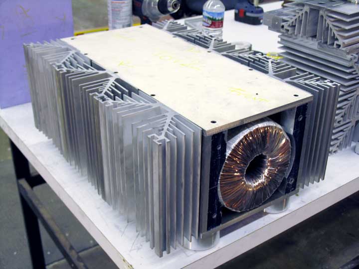

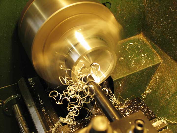

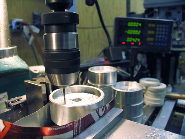

It is great feeling finishing good amp. It is equally rewarding making nice job on the case. Case is the biggest obstacle to many people. It is hard to make a good case without proper equipment. Because of the very reason, last year I have been learning machining.

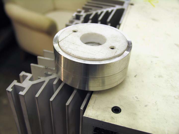

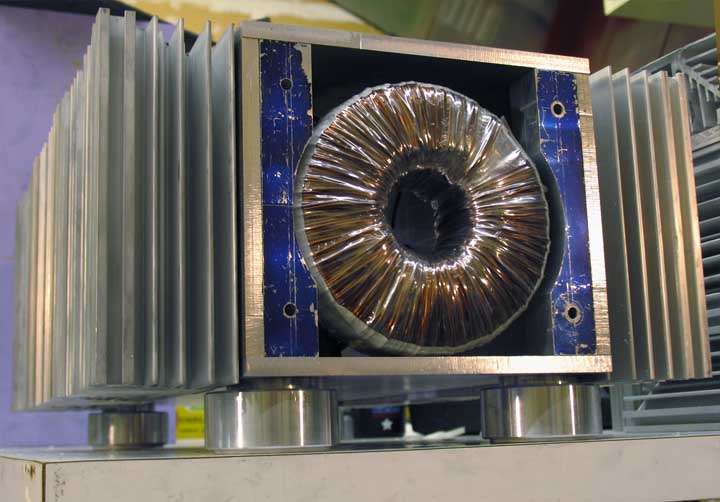

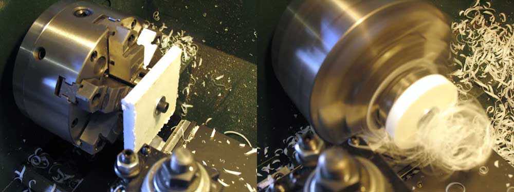

Here is the proof that I do not just destroy great amps. This is the case that I am working on right now, with my newly acquired knowledge. Even do I am not very patient person, I decided to do it slowly with attention to details, such as feet and special work on the front plate, beveled edges for the cooling openings... It is work in progress.
Yes, exactly 10mm aluminum.Boettgenstone said:Looks really great your "shell"
what is it made of? 10 mm aluminum?

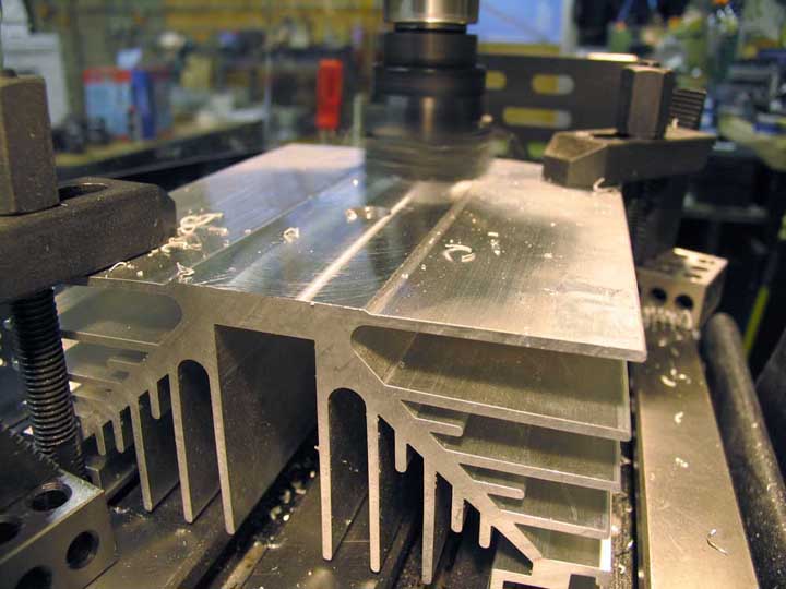

It looks as if you have a machine shop at your disposal. Maybe you have a smallish granite surface plate too, maybe 12"sq or 18"sq. If you do, when you sand the surface of the heatsinks, put the sandpaper on the plate in a laundry sink and move the heatsink over the paper while running water over it. This will give u a better finish and hold the paper to the plate too.

Thank you Rodd. Yes I do have big granite slab (compliments from Grizzli Industrial) and a small one for the purpose you described.
I have been experimenting with various grits and I completely agree with you. Finishes are much better with water, and wet sending is must with those fine grits. Water prevents loading of the sand paper as well, that otherwise would be wasted in no time.
