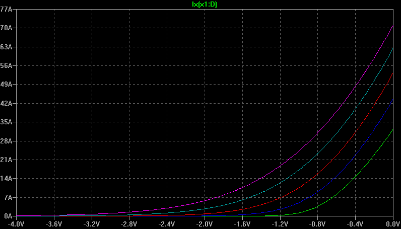

I've come out with one that fits IV curves nicely, but there's some work to do on the transient response.

Here there's my model. I suppose beta and lambda are less accurate than yours. Capacitances again, may be wrong as they are not zero-voltage capacitances.
.MODEL LU1014D NJF (VTO=-1.8 BETA=29000M LAMBDA=0.18 RD=0.0065 CGD=363P CGS=784P VTOTC=-2.6M)

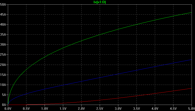

I simulate a fet curve tracer with LTspice and try to
fit the model to the curves in figure 8 of the LU1014D
data sheet. I try different values of vto, lamda and beta
to get the curves, then I try the fet model in zen v8 circuit and see
what the currents and gain are. I am really just guessing and tweaking
the fet values. Here is some new fet parameters that might work.
(Vto=-1.8, beta=2 lambda=.7) and change R5 to 22k

I think the fet spice models are inadequite to model the power fets.
For example in figure 8 of the data sheet, the vgs=-1v curve has
some curvature to it. I don't think the fet model in the pinch off
region can show curvature(or is it the linear region?).
Using lambda fakes it, since it is similar to an Early voltage.
I am looking through some books I have to find a more basic device
model for fets. It might yield better Id vs Vds (Vgs constant) curves.

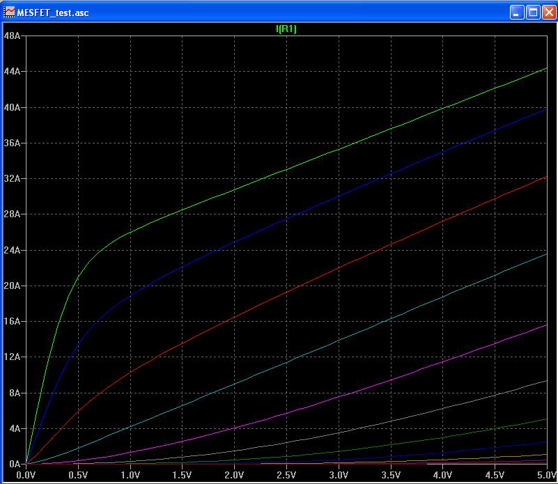

Ijfet= io·[1+tanh{P1(Vgs-Vp)}] ·tanh(áVds) ·e ^ëVds
Tom2: the mesfet model you are using is this something already implemented in LTC or is this your own "tweaked" model?

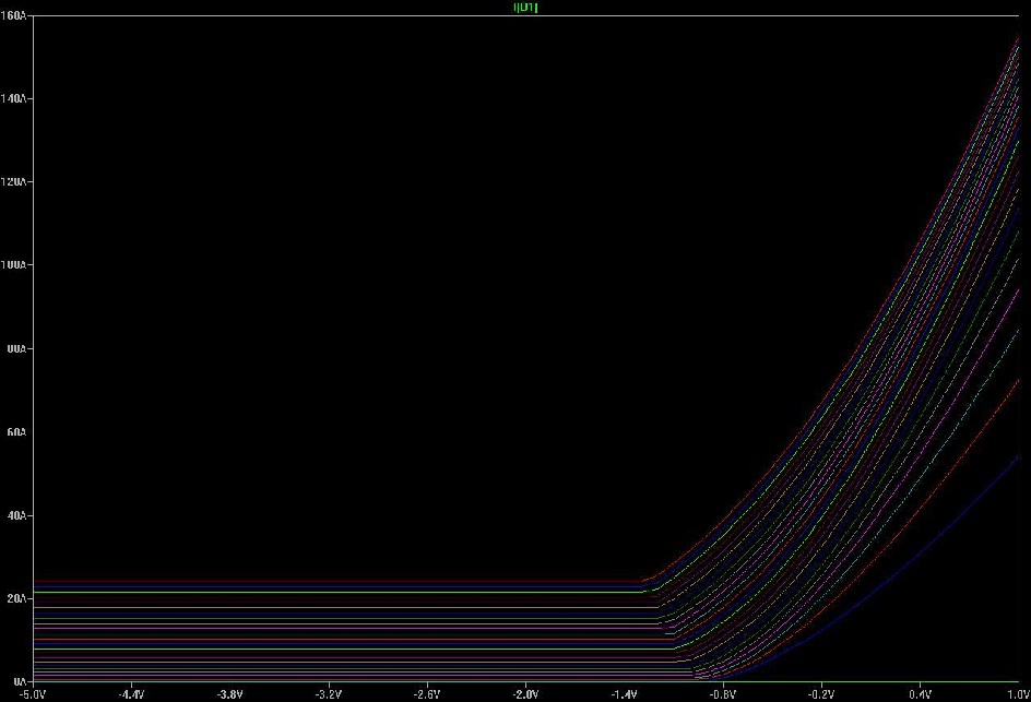

My first results:
I took some values from the LU1014 datasheet and placed this in Tablecurve3D with the model from "Materka-Kacprzak". From the result I made my first LTC-Spice model:

Ids curves are from Vgs 0v to -2V
.SUBCKT LU1014 1 2 3 ; D G S
+ PARAMS: a=21.7924 b=4.5599 c=10.2887 d=9.1318 e=61.579
+ f=0.5726 g=-16.0443 h=71.8659
G1 1 3 Value={(a+b*V(1,3))*(1-V(2,3)/
+ (c+d*V(1,3)))**(g+h*V(2,3))*TANH((e*V(1,3))/
+ (a*(1-f*V(2,3))))}
.ENDS LU1014

builderrandy said:
Do you see the same in your simulations.
This output is
Id vs Vgs with constant Vds.
Vds = 2,4,6,8,10 volts from right to left.
Tom
Here are the working .asc and .asy files I made and use.
I have made the diodes MUR460's. LTspice has the models.
Put the tom3fet2.asc and tom3fet2.asy file in the
same working directory as the .asc schematic files using
the tom3fet2 model.
I have included a Vgs_Id.asc file and
a curve trace file curvetrace.asc file.
Fet parameters can be changed on the tom3fet2.asc file
or on the working .asc schematic file.
Remember my previous post on convergence
problems that can happen using my model.
Have fun.
Tom

Hi Andy,builderandy said:Nice work kekso22, could you comment on the above observations, how is your model working?
The "Materka-Kacprzak" or the "TOM3" models are working both. It strongly depends on the constants you choose.
In the meantime I also tried the TOM3 and I find it a little better. The Fitting is more precise.
Emil
Hi Tom,
nice work!
I have put the "TOM3" equations in TABLECURVE3D with some datapoints from the datasheet. The fitting goes very well with this model (better than with the "Materka-Kacprzak" model) and I changed your constants in the asc file. I also included capacitors, which I took from the datasheet @ Vds=2.5V and a gate resistor to stabilize some simulation.
I find, that the uramp is not necessary for every equation (if the constants are correct!). Only for Vds<0 then Ids should be zero.
Don't understand me wrong, yours and mine is not a model we can use, it should only show, that it can be done in such a way.
I'm waiting for real data, but I have no LU1014.
Maybe anybody owning a LU1014 can send us real measured data.
Bye
Emil
PS: example with "TOM3" follows:
nice work!
Bye
Emil
