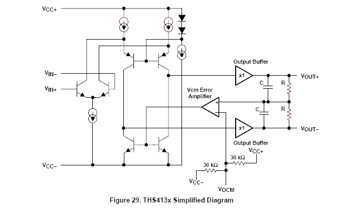

The easiest way, but not discrete, is to do it like Bel Canto did it for the DAC2. Opa1632 (or ths4130) for balanced I/V followed by a INA134 to convert to single ended.

00940 said:The easiest way, but not discrete, is to do it like Bel Canto did it for the DAC2. Opa1632 (or ths4130) for balanced I/V followed by a INA134 to convert to single ended.

Well if they used THS4130 AND INA134 that's not very smart. You can just ground one output of the THS and run that SE.
Jan Didden

Check out my NPC SM5847/SM5865 and PCM1730 DACs. Both have differential I/V stages using THS4131 differential opamp. The differential/singe ended conversion is usually done using instrumental amplifiers in the solid state world, but I would go for output transformer instead 🙂.
