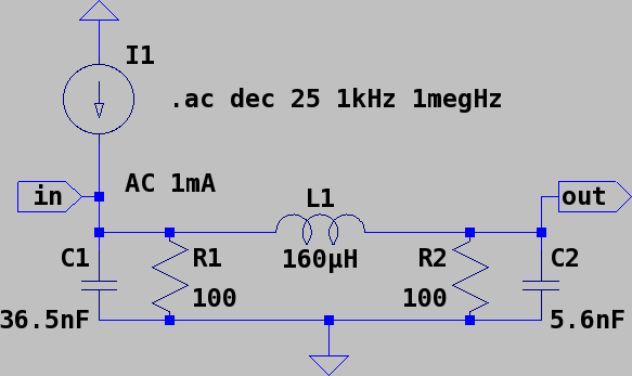

About filters: The simplest I/V converter is passive - a (small value) resistor. One can incorporate a 3rd order passive low-pass filter by having RC-L-RC chain (see PCM1730 schematics above for differential version). But the neatest trick is to use the leakage inductance of a step-up transformer as a filter element. This solves the problems of impedance conversion, voltage step-up, diff/se conversion, common mode rejection, and low-pass filtering in one passive circuit with five elements (well, seven if the input is differential). Add a opamp output buffer/gain stage, an you'll be set...

Hi Andrei,
Sounds interesting and worth considering. For one I never tried passive I/V and higher order passive filters. Trouble is that I wasn't able to see all the component values on the PCM1730 DAC schematic. Can you show us a schematic for the analogue stage and some details about building/procuring the transformer, insertion loss of the passive filter/or the gain of the THS4131? Tks.

The basic passive I/V with 3rd order lowpass topology is shown on attached schematics. For Bessel filter response, set R1 = R2 = R, L = 0.1544617529*R/f_3, C1 = 0.3506838218/R/f_3, C2 = 0.0537022973/R/f_3, where f_3 is -3dB corner frequency (the values on the schematics are for f_3=96kHz Bessel). The impedance seen by the DAC current output is R/2 in passband, and decays at high frequencies (it is never bigger than R/2). The voltage at the filter output is Idac * R/2. The gain of THS4131 is set by the feedback loop resistors (check datasheet for recommended values); you can pull a gain of 10 comfortably.
