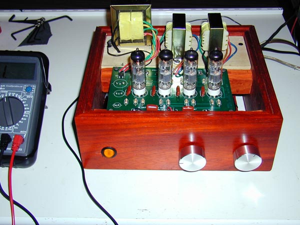

My 18th birthday was a couple of days ago so I decided once school is out for winter break I will build my first tube amp. For years I've been wanting to build a tube amp and finally I'm gonna try out my first one.
I recieved the kit today in the mail and am very excited. It was only$150 for the kit and shipping. I'm going build a hopefully somewhat nice chassis for it, I'm not very good with chassis, but I'm gonna try my best. To do this I'm going to have to mount almost all the components upside down. When I ordered the kit they told me that this is a different design. Its slightly changed and uses different tubes, 10GV8. I like Volt Second's modifications, but I'm afraid they won't work with the new kit. I was wondering if anyone else could help me.
Here are some pictures.
Thanks,
Josh
Thanks,
Josh
The kit looks rather easy to build, and I want to upgrade some components. I've already orded an ALPs pot for it and am willing to upgrade pretty much everything. I also have some solid core pure silver wire to wire the RCA and binding posts. I was making an order from another website for a chassis for another project so I added the pot, binding posts, RCA jacks, and the pot.
Other upgrades I was thinking about making were upgrading to nicer caps. There are 220uf, 22uf, and 100uf caps that I was thinking about upgrading.
The Voltsecond modifications I was interested in doing were: Ultrafast diode between diode bridge and first cap; .01uf recitfier noise cap; and 1uf snubber caps on each tube (really unsure about this one).
Any comments on which mods or updates will work?

Thanks for the replies.
Wow, I'm very happy to hear the all the mods will work.
ervington,
Thanks for the tips. I'm guessing you meant the two caps on either side of the pot, as GG describes on his website.
What caps did you buy? I don't remember voltsecond recomending any specific caps on his website? Should I replace the .22uf caps with Kimber Kaps or something as well as the three caps I mentioned earlier. I'm going to go online later and order hopefully some Elna caps to replace the cheap ones mentioned in my second post.
nikita,

I haven't decided yet, but my amp is probably going to have a copper front, back, and top pannel. The sides will hopefully be a pretty wood. The board will be mounted under the copper top, but using .5" stand-offs my solder joints should touch the copper. The traffo's will be mounted under inside the chassis.
I haven't decided, but I don't really want to tun my RCA and binding post far from the circuit board. I want to keep interference low so I think the RCA's will be mounted on the front and I think the binding post my be mounted right above the PCB, on the top plate. This is not the most convenient way, but I think interference should be lower with much smaller signal length.

That looks nice.
Well I didn't want any of the traffo's to be seen, and I thought it perhaps woud be impossible to mount them on the bottom of the chassis because of the lenght of the leads coming from the traffos.
Would it be alright to mount the traffo's upside down if I cut slits so that some heat could escape?
by the way, What is the top of your enclosure made out of? It doesn't oxidize when not painted does it?
Josh
Josh

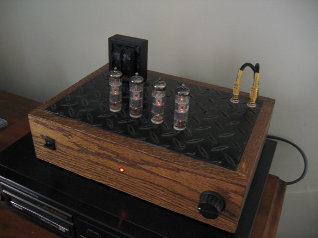

the top-plate is aluminum diamondboard. i suppose with ventilation holes top and bottom you could get away with putting the power transformer inside; perhaps someone who's tried that with this transformer can weigh in?
K-12 and Heat
Yes, the power tranny does get hot. I figure it is a little on the small side. The tubes also get very hot, so it is a good idea to keep the power and output iron as far from the tubes as possible.
Upgrades that I reccomend - upgrade the bridge. 4 UF4007 can be put into the PCB without drilling/cutting. Remove the DC block capacitors. Upgrade the coupling caps to film/foil or polypropylene. snuber caps on the heaters and HV.
I've noticed that little changes to the PS make a big difference. Upgrading the PS caps (larger and better quality) seem like a good idea.
I also tried dampers and they made a very slight improvement. The $10 for dampers is likely better spent on capacitors.
I have read that resistor upgrades are not really worth while.
Have fun with the kit and do report back on the sound.
Gio.
Gio.
GG,
So far I have 4 Audio Cap .22uf caps, Alps pot, and silver wire. The silver wire will be in place of the two input caps. I see the caps the VoltSecond recomeneded the Nichicon UVR2E331MRD 330uf caps from Digikey. I wanted to also buy the snubber caps from there as well. Any recomendations on which caps would be the best?
Do you think it will be alright to mount them inside the enclosure upside down if I have lots of "breathing" holes around the traffos? I am also going to put these holes around the tubes as well.
Any more recomendations?
Thanks,
Josh
Thanks,
Josh
