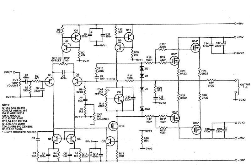

Hello,
I am currently trying to modify a JLH mosfet amplfier. This was designed back in '82.
What I am trying to do is replace Q10 which is a VN1210M (1w) vas fet with a higher power VN1210D device. (45w). Obviously the VAS CCS and vbe transistors will have to be upgraded and probably heatsinked. Enno Borberly in his earlier designs such as the DC100, Servo 100 etc recommend driving lateral Mosfets with about 30-40mA per pair. This was because of the capacitance, apparently this improves HF THD and also the slew rate. Another thing that JLH does in his design is uses different gate resistors (presumably to match the bandwidths closer). But I would prefer to use equilisation capacitors over the N Chl mosfets as I do not think the slew rates could be symmetrical ?? (not sure on that one)
My questions is, can I replace the VN1210M with a higher power VN1210D and will this affect the compensation of the amp ie. need different compensation capacitors etc. I am not good enough to adjust this to be honest.
I have included a link to a datasheet which shows the devices in question. One minor problem is that it does not show the VN1210M by name.
Just wondered if anyone had any old supertex databooks with these devices in particular. Think I am alright though.
http://pdf.alldatasheet.com/datasheet-pdf/view/25955/SUTEX/VN1210D.html
Any help appreciatted
Kevin

Thanks for schematic Kevin :smash:
We are discussing JLH 80 Watt MOSFET in another topic
and did not know where to find a schematic for this amp.
Suddenly you posted this thread!
Your schematic was really 'heaven sent'.

Just to avoid any possible confusion for people reading this thread, the schematic you have posted is not the circuit that was published in Wireless World in August 1982 (80-100W MOSFET Audio Amplifier). It is the schematic for the later 'Audio Design Amplifier' which appeared in the July 1984 edition of ETI.

Hi Kevin,
I have the Supertex Databook dated 1991, but the 'M' suffix VN1210 device is not shown in this either!
However, from the book it is clear that with these various VN1210 Supertex family devices, provided there is merely one letter in the suffix (i.e. 'M', or 'L', or 'D') there are no differences as far as their electrical parameters go. The differences here are merely their packages and therefore their power ratings/heat dissipations etc.
Where there is a number added to the suffix as well as the following letter (i.e. VN1210N2, VN1210N5 etc.) this no longer holds true, and their electrical parameters are different.
As the 'D' suffix devices you mention are T0-220 packages, it would seem that they will be fine in the intended application.
The original 'M' suffix Mosfets (I have some to hand) are merely the size of a TO-92 with a small metal tab on top (I have not come across these devices before, nor since, so I don't know what the packages are called!) but their dissipation will be much less than a T0-220.
You mention the gate-stopper resistors, R18/19 & R21/22, and you are correct in your assumption that R18/19 are higher values than R21/22 to 'balance' the different capacitances of the output devices, to bring the HF roll-off points nearer to each other.
You may also be interested to know that the designer later recommended that these be increased to 330R for R18/19, and 270R for R21/22.
I hope this helps.

re JLH schematic and DC output offset.
Bobken confirms that feedback resistor R14 = input resistors to ground R1 + R2. 150k almost = 154k7
Can I assume that the two resistors RV1 & R8 do not affect the offset minimisation due to the DC blocking action of the series capacitors C1 & C7.
Can I also assume that the balancing of inverting and noninverting input resistances to ground only use direct DC paths to low impedance?
If C7 is shorted then both R8//R14 = R1 + R4 (ignoring the balance control and all it's resistors set to zero) to minimise the DC offset voltage.

Hi Andrew,
Ideally, the situation is as I described, but JLH used (or got away with!) having the total (DC) resistance from Q1 base to ground, slightly higher in this case at 154k7. This is only approx a 3% variation and the slight disparity is easily taken up by adjusting the pot which forms the (albeit variable, in this case) two emitter resistors.
JLH used the same value of 150k in both locations (R1 & R14) as he had these to hand, and he also said that this would probably be easier for other DIY'ers to copy, and so avoid their needing to obtain even more different values of resistors.
As I tried to point out earlier, with any good and stable design, these values are not very critical, and frequently DIY'ers will probably use 5% tolerance parts anyway.
However, I spent several years in further developing this excellent design, always with John's continual encouragement, frequent advice, and subsequent approval, when he visited me from time-to-time to hear what I had been up to.
Unlike myself, JLH had less time and inclination to take things further, but my approach was to optimise absolutely every single part of the circuit and it's components, and this ended up as a very fine-sounding amp as a result of this attention to detail. It was very good in 'standard' form, but after my own efforts especially with all components being chosen through extensive listening trials, it was in another league, which JLH was happy to acknowledge.
Theoretically, if the currents flowing thro' both input LTPs is identical, and the DC resistance path to ground at the input of Q1 is identical to the DC resistance in the feedback path from the output, then the amp's output (which is effectively at the 'other end' of R14) should also be forced to remain at the same potential. i.e. '0'v.
This is effectively a true 'balanced' situation, if you think about it, with the bases of both input transistors being referenced by the same resistance, so if one side is held at '0'v, the other side should remain at '0'v , too.

Hi Bobken,
thanks for your very clear reply.
The schematic I looked at was the one attached to post1. R4 is the NFB resistor output to inverting input.
I was using the opamp design note always showing the //pairs of input resistors as being equal and only recently realised that the caps prevented the respective resistor from entering into the equation. Your comment confirmed that.

Hi Andrew,
I am puzzled by what you say here, but if I understand you correctly, I have answered your queries. I hope so, anyway.
At a quick glance, the circuit in post one is the same as that which I have just looked at, and have been referring to.
R4 on this (1k) is between the base of Q3 and the neg. PS rail, and is in parallel with C4.
Q3 & Q5 make up a current mirror (intended to equalise the currents through Q1 & Q6) and don't feature in this situation, nor is this area related to the "feedback" of the amp.
These components are there (together with the corresponding C5 & R6 for the opposite 'side' of the current mirror) merely to ensure satisfactory operation of the current mirror, but I seem to remember that the narrative in the article was incorrect here, and maybe described some of this part of the circuit incorrectly.

OOPS
Apologies Bobken,
My glasses must be steamed up, R14 (not R4) is the feedback resistor.
All else falls into place.
Since you mentioned the current mirror, can you confirm that the caps C4 & C5 are reducing the AC impedance of the emitter resistors. I think this has some compensating effect at quite high frequencies. Is this a good way to compensate on amp for stability? and still sound good?
JLH seems to have built in 5 compensating caps to avoid the easy Miller comp cap. I have seen other good sounding amps that similarly adopt quite complex compensation schemes to avoid that same problem. My Crimsons and Sugdens do the same. Is this a British trait?
From the schematic, remove the decoupling caps C9-12 and C14-18, of the ten remaining caps seven appear to be for high frequency stability and two are for low frequency stability. I haven't managed to categorise C13. That appears to be thoroughness in pursuit of the good sound goal.
