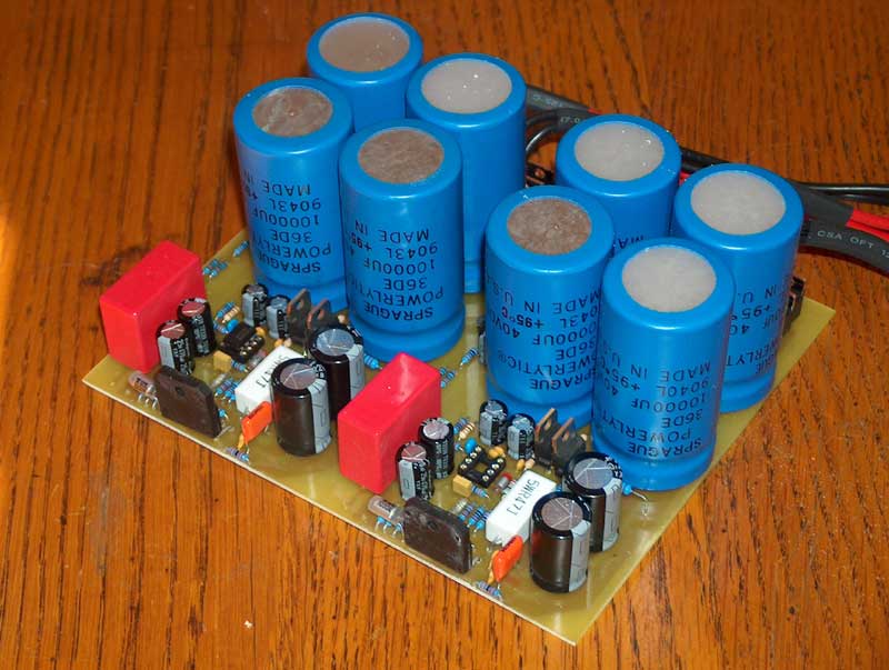

This is a really great sounding amplifier and tweaking it is allot of fun
There has been allot of speculation as to "tweaking" this design and unfortunately it has been shot down several times.
Here is a tweakers board, you can try allot of different configurations on it even build the original design on it, if you want, Minus the bridge rectifier
I will be doing a bit more documentation on it and how to build it,
My design uses
2 x 550VA transformers
8 x 10 000 Sprague 40v caps
16-x MUR 860
And all other caps are Rubycons
Regards
Rudi

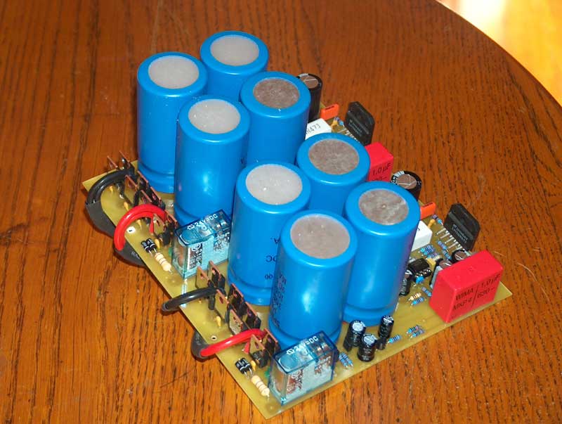

I do not want to give Mauro the idea that I am being disrespectful to his intellectual property. But he will have to give us something new because this one (for me at least) is much better. There is no way that I am going back to the old design - this one beat it hands down. in one word CLEAN
Sound staging is wide, while keeping a pinpoint accurate focussing
It has a depth that i did not pick on the original.
The entire sound spectrum cleaned up, bass is tight well defined. mids are sweet and very clean and tops are just spectacular,
The basic specs are the same as the original. i have just changed board features
* Possibility for larger input caps. The big boxy ones normally sound better
* Bipolar feedback cap configuration
* Parallel main caps. - You can get the advantages of more expensive caps by doubling up two caps
* snubber - if you want that. I tried it and it worked well, gave some life back to the amp
* Series or shunt regulation for the LM318 or even both if you want.
* Discrete diodes for the bridge rectifier – MUR 860
for the rest. It is exactly the same as the ref C, the main reason for me making this board available is that I thought that you can really make this amp sing. And that is where Mauro had the vision and I just want to give it the drive, as you can see in essence it still Mauro layout and 90% of his design. I just added the BLING

I've listened to Rudi's X-amp. It is very very good. We are all here to DIY and in that sense I think that Rudi has taken a great design and gotten even more performance out of it.
The sound of X:
Most noticeable was the quietness/blackness of the background, with no noise/hash present.
Extended, detailed and airy highs-lovely to listen to, no hint of grain. This is a real strong point in the amps performance, giving a real sense of musical timing, especially in acoustic jazz feauring cymbal work.
Mids were wonderfully detailed and present in the performance. In one instance, for the first time, I heard voice vibrato on a well-known piece by a female vocalist.
Bass was fundamental, i.e. not rolled off, but deep and powerful. The body of an acoustic/upright bass takes on more flesh/realness than previously.
Staging and presence were reference class.
Shortcomings? The amp needs a good pre to show its best. We started the listening session with a passive ALPS, but the pot tended to some warmth/bloom in the lower mids/upper bass. Replacing with a passive NOBLE cured the problem.
Bottom line is that I was intending to build REVC to replace my 3875-based design. I will now be building X-Calibre, the jump in performance is compelling!

I first stook to the RevC parts list etc but used Rudi's layout because of the dual rectifiers which I thought would be better in the long run.
The amp is actually not bad but I was not happy with the bass to be honest
I've always felt Carlos amp had by far the deepest tightest bass out of any of the chip based amps and Pedja's had the best top and sheer clarity, this is MY opinion and in MY system
I now have swapped the standard diodes to MBR10100 Schottkies, removed all the small 100nf decoupling caps off the top board and cut the legs much shorter and soldered them directly to the LM318/LM3886 pins undeneath, the zener for the LM318 has been removed and replaced with seperate diy boards with LM317/337 TL431 set to output +/- 15v, added 2x 470uf back to back low ESR caps in the fb
I prefer the amp already to the original, I will also of course try the snubber too next😉
Thanks again to Mauro for sharing another amp to play with and to Rudi for the layout and fb tweak and to Carlos,Pedja etc for all the advice and nice diy amps to build in the past😀
This will probably be my last chipamp project after a few more mods to this one, I'm going to try the Hpex classD modules next
