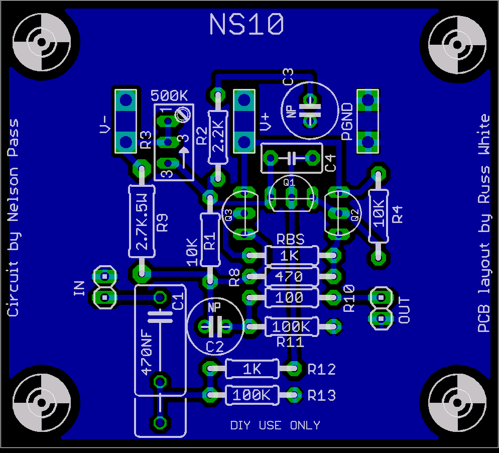

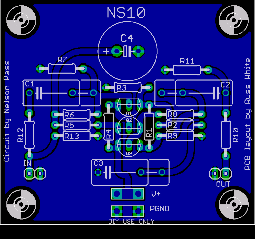

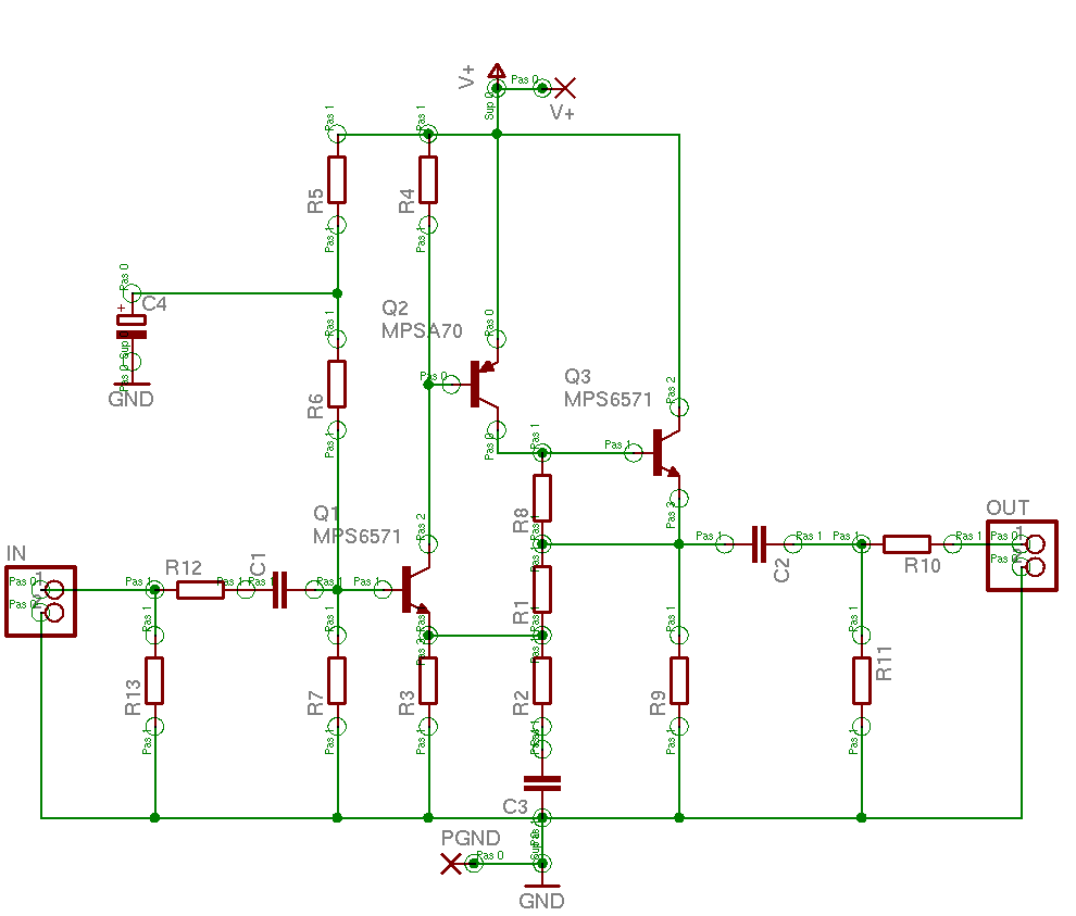

Tony and others have asked me to look over the NS10, so I did. I managed to find Nelson's schematic, but it is lacking values and ratings for parts. So I just threw something together hoping Nelson and the rest of you could help fill in the blanks.
Some questions:
1) What should the PS be.
2) What are the part values.
3) What other design factors should I consider.
So to get things rolling I submit what is likely a completely flubbed up layout:
Cheers!
Russ

Good you did open this thread, you won me but I'm glad you did.
I wanted to post a GUESS WORK schematic with some values to gather some interest and maybe having others like Blues running a virtual test. Of course we would like Nelson throughing in all his knowledge and memory of it, unfortunately he does not have the original schematic.
One thing for sure, Nelson has tiped that the NPN devices should now be MPSA18 (On-Semi). I check on this and it is a modern replacement of the original MPS6571 same low noise and equal in most parameters with the added benefit of a higher voltage rating, VCEO and VCBO up to 45.

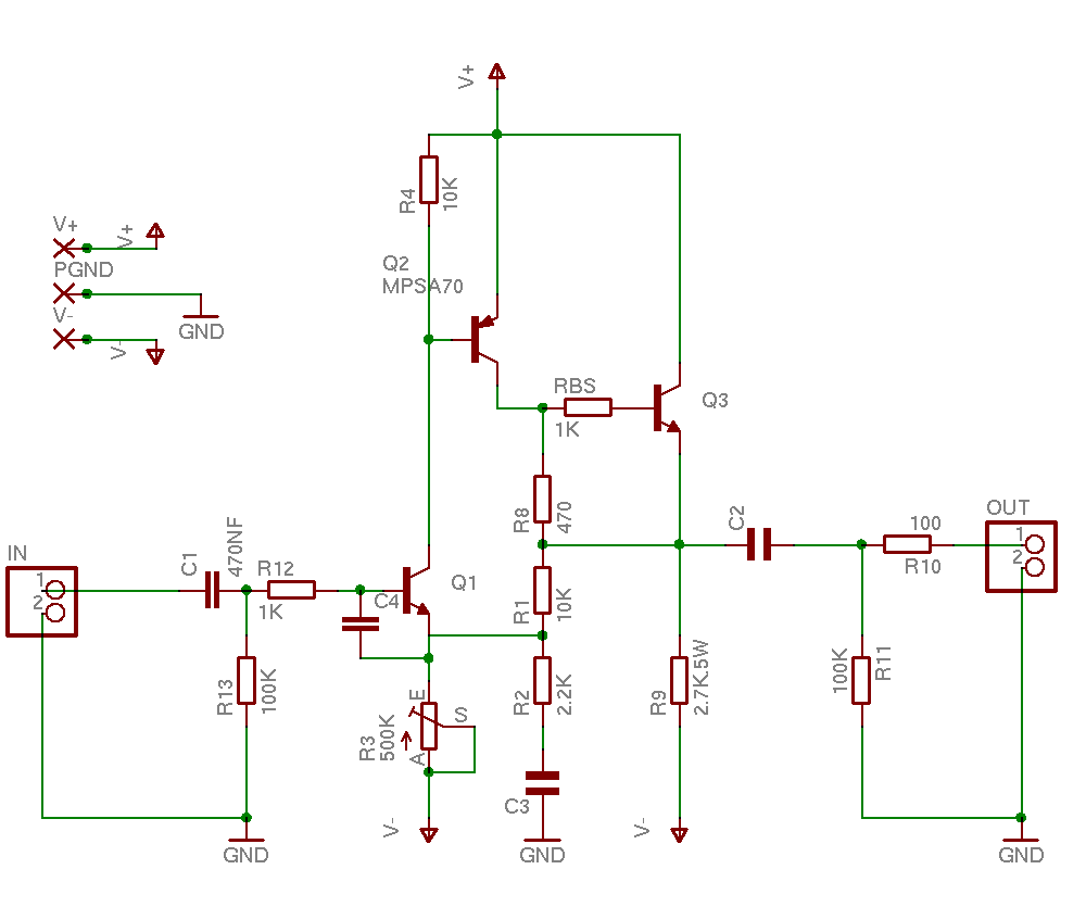

Ok I found lumanauw's excellent instructions:
And I have attempted to do a bipolar schematic, but I am affraid I have botched it. Especially I am worrind about what should be connected to the negative rail.
Please bear with my ignorance. This is a learning expedition for me. 🙂
Cheers
Russ

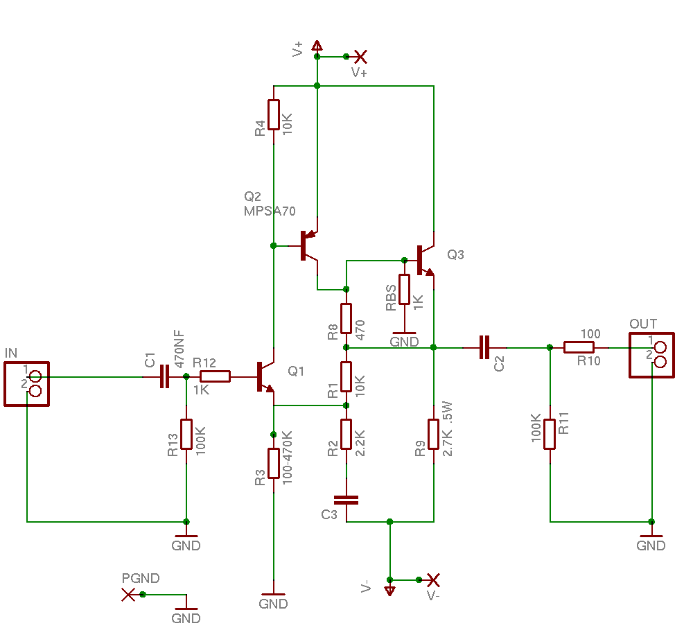

Cheers
Russ

So does anyone know where the negative rail connects to the circuit? Did I do it correctly?
Thanks,
Russ
Thanks,
Russ

Hi, Russ,
About the schematic in post #5 :
- If you use single supply (only + and gnd), this schematic is lacking the pull up section (R5,R6,C4 in NP's sch). If the Q1's base voltage is not defined (near middlle of the rail, usually), I'm afraid the whole thing won't work.
-RBS (of Q3) is not attached to ground, but in series with the base (ordinary base stopper configuration)
For using symmetrical power supply, then your schematic in post#5 can have the input section like that (without R5,R6,C4),
-R13 is connected to GND (to define 0 point for Q1)
-R3 is connected to -rail (adjusted in value until you get 0V on output),
-The end of C3 is also connected to GND
-R9 is connected to -rail
-R11 connected to GND

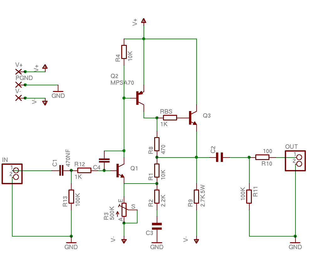

I don't advise the following, but I do this : I pick up transistors with lower gain (HFE) in position of Q2 and Q3. I use MPSA42 and MPSA92 there. I don't use R3. If you trace oscilation in the whole cct, you can put pF capacitor between B-C of Q1.
PS :
Mr.Pass, is it alright to make this schematic using symmetrical power supply? I hope I'm not Hi-Jacking your NS10, it is just because I don't have the original component values
PS :
lumanauw said:Hi, Russ,
Thanks!
My question, and that schematic is for dual supply (bipolar).
You have helped me greatly.
Cheers!
Russ
