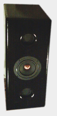

My FR125S project is finally done!
And what a PITA is was!
Nothing electrical problems, but I got a crash-course in what *does not* finish well on MDF - almost everything my local hardware store carries! :xeye:
After reading a lot of forums and talking to a lot of people on the strengths/shortcomings of this driver, I tried to be creative, while keeping rather conservative (since it's a prototype for a possible commercial design).
After much fooling around on the computer, I decided on a bass reflex (for size, I have a **very** small house) with twin ports to keep the wind velocity < 16M/s at full power. I did this because I put the ports on the front instead of rear, so they could be backed against a wall or act as a set of bookends on an enclosed shelf.
The ports were dampened at the front with low density foam. This is an attempt to tame the outrageous (an understatement) bass cabability of these drivers. Without some dampening, they'll run out of Xmax long before the power rating is reached, if cabinet design isn't careful.
The window screen on the front of the ports serves two purposes - 1) keep the foam plug in and 2) keeps crayons and toys out!
Sound:
I have done a lot of listening tests, but this is the first set of fullranges I have owned. Three things struck me immediately:
1) I thought I had my headphones on for the presence of mids that sounded "live"
2) So, this is that imaging everyone has been talking about! :D
3) Where the heck is the volume?
About the last one... While the speakers they replaced were a set of Clarion car speakers shoved in a little K3 box, they must have been 16dB+ more efficient, because if my power meter on my not-so-cheap Sony amp is accurate, I have to put about 50x more power into them for the same volume.
The bass is LOUD, but not boomy or loose. It's nearly as tight as with the ports plugged completely and MUCH tighter than any speaker I used to sell during my stint with RS.
I plan on doing a lot more testing with these and will let you all know :)

RockerII said:
Nice finish on those speakers. Why did you use the R6/polyfill in that configuration?
Thanks!
The finish is Krylon latex enamel in gloss black applied with a foam roller. Last time I'll be using it though, as it's actually a vinyl finish and about as durable as rice paper :rolleyes:
I've used polyfill, acousti-stuff and plain fibreglass house insulation in the past - I prefer the fibreglass, but the polyfill suited the purpose better on the top/bottom because of it's ability to stuff well on the round shape of the ports.
Also of note, is I "fluffed up" the glass before putting it in by tearing it along the cleave - doubling the volume.

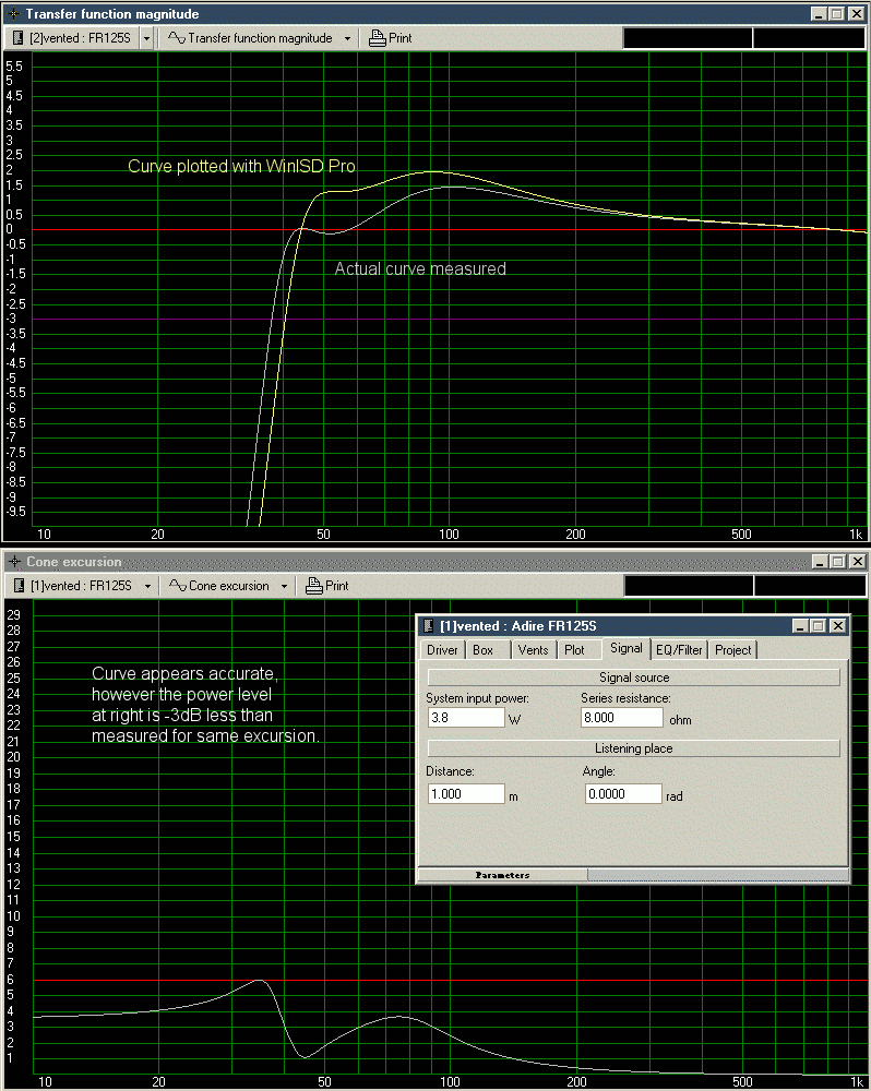

Ok, some stuff measured before going to work tonight and more detailed Xmax measurements.
A testament to WinISD Pro, the curves only differ by a small amount from design.
I believe I can answer this too - the foam in the ports appear to have effectively lengthened them by 12.8%.
Basically I took the curve from a sweep generator and a FFT, then altered the params to match the resulting curve. The only thing that changed, was port length. That is how I draw my conclusion.
I will also say that my setup was nowhere near professional. The mic used however, was designed for a kick-drum/Tom pickup and is nearly flat from 25Hz to ~800Hz, where it then becomes the "Rocky Mountains" for response (hence, I didn't bother with > 1KHz).
The Xmax curves were measured with a slow sweep and a white dot on the speaker.
Those curves were accurate enough to match the predicted response, but the program says 3.8W, while I measured about 7W in real operation.
Funny thing about the source at 8 ohms, since I measured it on my Sony sand-state amp, not a tube one :confused:
Suffice it to say, it appears WinISD Pro is within 3dB of real-life measurements in this instance :)

The procedure was posted, but here it is in more detail.
Xmax was determined with a little white sticky dot on the cone and I measured the length of the "blur". It was close enough to the WinISD curve, that I used a screenshot of it.
Frequency response was measued with a microphone 1M from the speaker and the amp at 1 watt, with a slow sweep (also from WinISD) inputted. Since I do not have an anechoic test chamber, the area was dampened with quilts. The mic went into the soundcard and was displayed on a FFT. I went back into WinISD and was able to duplicate the FFT response fair precisely and determined the only seeming change in the params was port length.
As mentioned, the microphone was an Aiwa (model # worn off) for bass percussion and is fair flat from 25 to ~800Hz.
I have gone out and purchased a nice mic to measure the mids and highs. Any further test results will be posted on my forum. I just wanted to dispel any myth that the FR125S was tube unfriendly ;)
