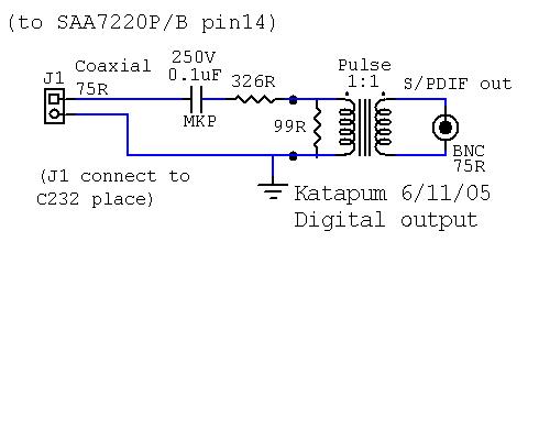

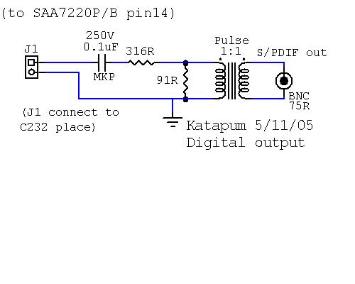

I have an Arcam Alpha 5 working only as a transport. I built a new digital output with a new Pulse transformer (see att. picture).
Any comments or suggestions are very welcome.

OK, assuming that he fixes those problems, what transformer is it?? All pulse transformers are not created equally. Most are useless for SPDIF.

The Pulse is not a bad choice.
You need to figure out the Z of the chip, take that into account, and pad down the ouptut. That is one way, probably the easiest.
Never looked at any of the trafos you ention. Would not be surprised if they aren't that good. I know, you would think so.............

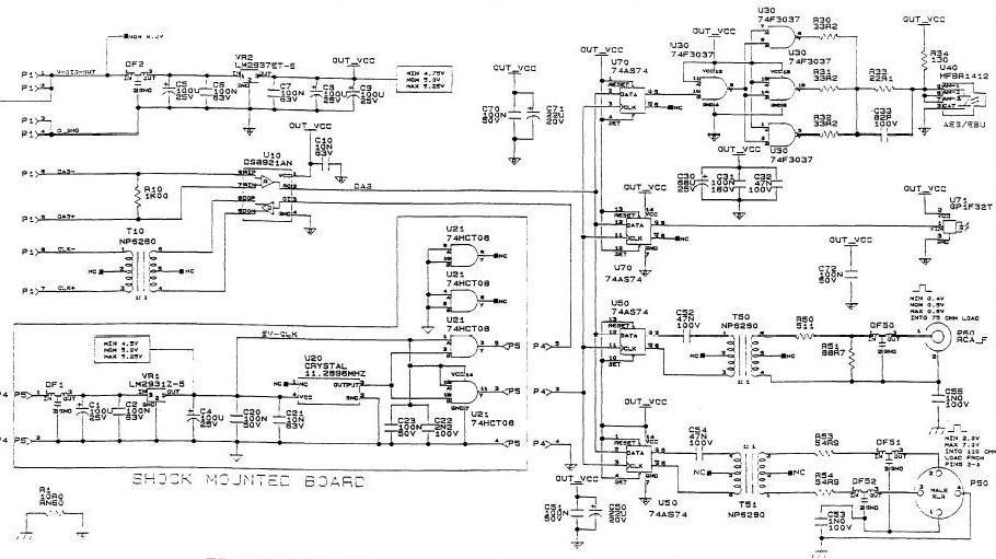

I see where you posted a schematic. A bit hard to read..........looks like something Philips would do. Nope, I like it even less.

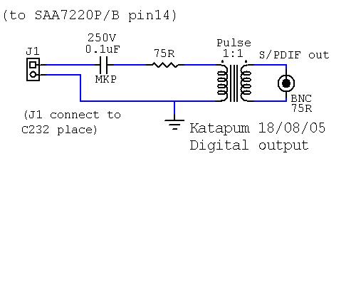

Well, you didn't tell me that you are a "noob".
OK, figure it is around 25 ohms. Close enough for this circuit. A few ohms either way is closer than 0, which is what you.....and some famous audio designers........planned on.
At least you are not a professional, and have nothing to feel ashamed about. They are, and should be.
(Now you know more than they do! Don't tell them: their egos won't allow it.)
Jocko
Btw remember to take rounding to nearest obtainable resistor values into account.
Maybe you could also try padding down the signal after the transformer (after getting it terminated to 75R first) to get the added benefit of also reducing reflections.
